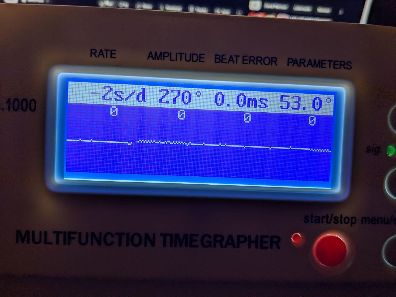

ALso after a day on the wrist and a bit more wind got the timegrapher data in on my second  repair and service. I'll take it!
