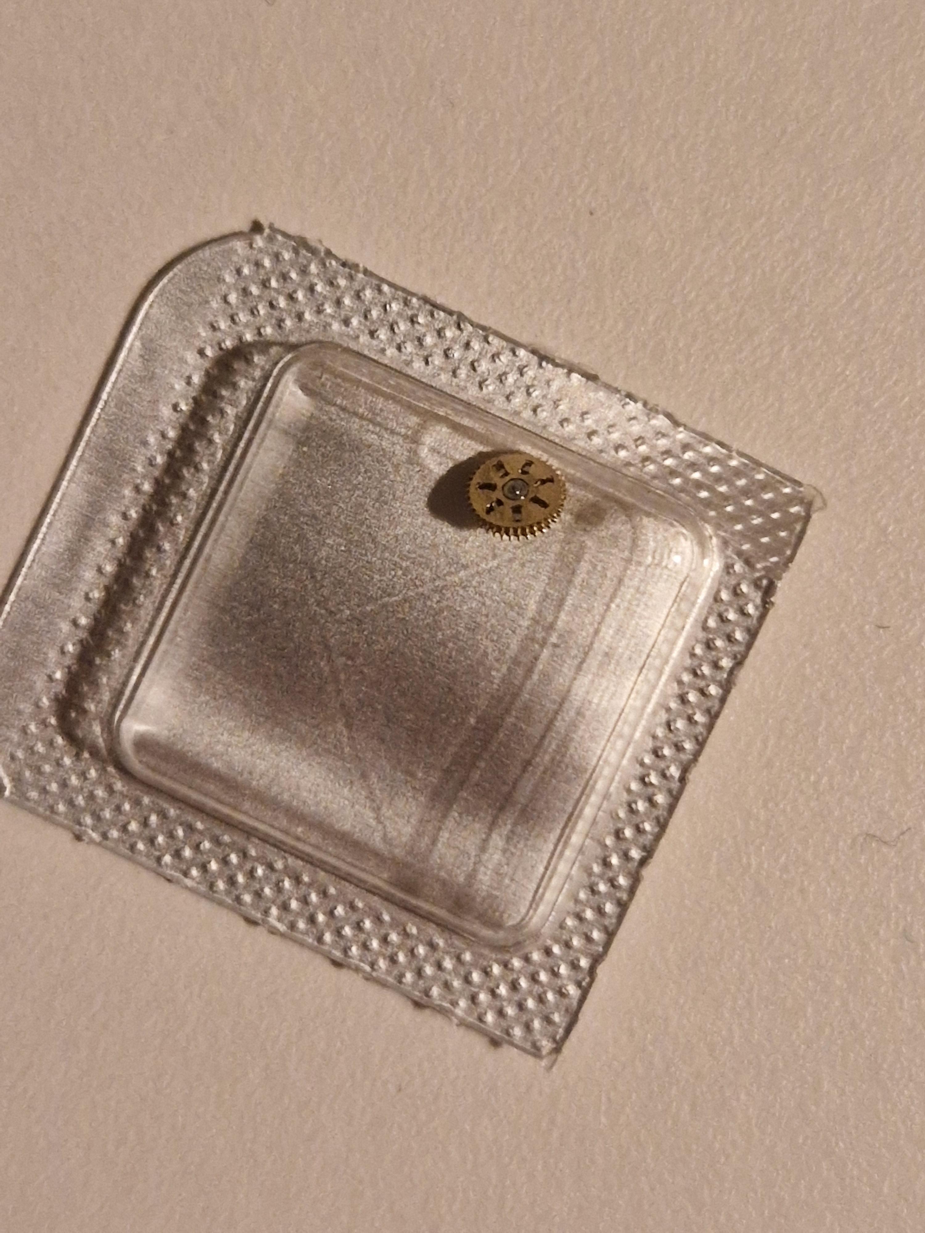

On 12/5/2022 at 12:42 PM, VWatchie said:
Wow, amazing walk-through!!! Just wonderful.
Just two questions about the two pictures above:
1. your application of 9010 to the seconds pinion from the dial side in the first picture above. It seems like a potentially good idea. But did you find this somewhere in any ETA documentation or did you come up with it yourself? Do the tube and the seconds wheel pinion actually touch each other at this point or just at the slightly thicker part of the pinion itself that you lubricated earlier (visible on another picture?
2. the "reverser" (NOT reversing wheel!!), does it need any lubrication like Lubeta V105? (I must admit that I don't full understand how it works: if the top and bottom fixed to each other, my question doesn't make sense and obviously no V105 would be needed)
PS: so, I bought a brand new ETA reversing wheel (this time I really mean "reversing wheel" and not "reverser") from CousinsUK. But knowing that Eta/Omega hasn't supplied new spare parts to the open market for a while, I wonder if I can/should use it as-it (assuming pre-lubricated) OR if I should dunk it into V105 again..
20240604_233913.thumb.jpg.2f0553f9b7bd33f71daf68730c52357c.jpg20240604_233845.thumb.jpg.682b64b9262a458f0eb7a116ec932fb6.jpg
Edited by Knebo
please disregard question No2 above. The two wheels on the "reverser" are fixed and don't turn. So obviously no lubrication like V105 to the part itself.
Regarding the first question. Looking at it under the microscope, there seems to be contact at that point. So I followed you this morning in putting some 9010.
I don't think there's any need. As far as I know, they are pre-lubricated. The only reason would be if and when the rotor starts spinning when you hand-wind.
Yes, they are pre-lubricated. But how old is this lubrication if it's still original ETA parts?? Could be 10-year-old stock that Cousins is still selling... I'm worried that the pre-lubrication has dried out.
That being said, it seems to work fine (no spinning) --- for now. Not sure if it'll wear out quickly, though (if the pre-lubrication wasn't good anymore).
