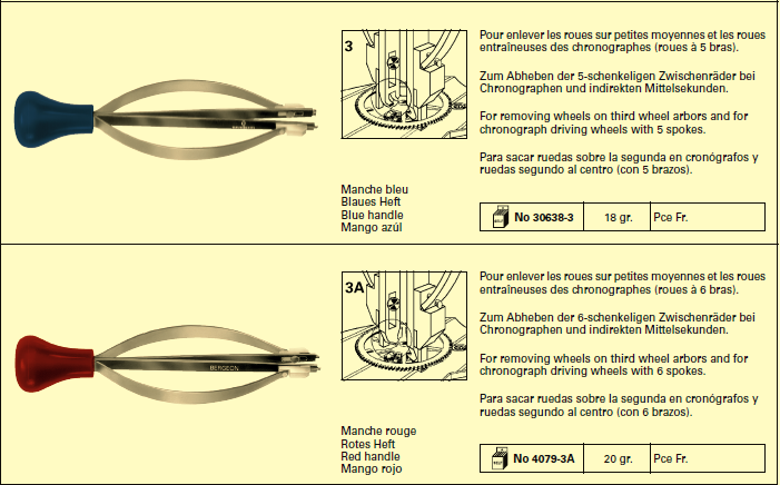

Hi all,
I'm currently working on a Cyma (apologies, unable to post a photo at this moment, will come back later to add) which has a wheel with an extended pivot that passes through the barrel bridge and there is another wheel pressed onto the extension.
Is there a specific tool to remove this pressed on wheel? It is too small as to allow the presto tool between the spokes - cannot slip anything under without putting angled pressure. To remove I ended up just taking off the bridge and as the bridge came up it popped the wheel off.
Just checking if there is a more correct way to do this? I am on the reassembly phase now, I was thinking I would press back on with hand press tools.

What you're looking for is a Bergeon 30638-3, or it's equivalent from another brand.  A normal presto will not fit, but this one has thinner feet that will fit inside the wheel.  It is specifically designed to remove these wheels with an odd number of spokes (usually 5).  I bought one, but have only used it twice.  It's a single function tool, and overpriced, but it seemed to do the job safely.

So after snapping another pinion I decided to bite the bullet and get a Bergson 30638-3 5 spoke presto tool... But everywhere is out of stock and i tapped out of eBay bids when the bidding got crazy. So inspired by the above I found these on Ali express, link here. Let me known what you think.

Gee- I think I’ve used my Bergeon blue a dozen times in the fifty or so watches I’ve worked on. Not a single pivot was harmed in my ham handed service. One of my better tool investments. I guess its just the movements I’ve worked on…

Kalle on Chronoglide showed a way for removing such wheels. He said he was shown it by his original tutor who never used any tool.  Using two pieces of peg wood, ease the tips under the wheel centre and rotate the wheel with small movements, applying gentle pressure toward the centre. He said it always works.
I tried this on three pressure fit wheels that were tight. I cannot afford the Presto tool. Each took over 4 minutes, but it did work, and no distortion to the wheels.
What he said is that he uses the Presto tool for time saving. He presto, it's off.

Many times people do things without tools because are unaware that they exist. Or their cheap and they don't want to buy the tool. So if whatever they're doing works for them fine but if it doesn't work and as you're aware In watch repair breaking things could get very expensive very fast or in some situations breaking things you can throw the watch away then it may be the investment in a tool is worthwhile To avoid destroying something.
For instance here's an interesting discussion.
What's interesting with the Swiss and tools for watch repair our quantity of tools appears to be shrinking. For instance this particular tool used to come in three different sizes and now you just get one size.
Then there is the other problem with tools unfortunately one tool is not necessarily the perfect solution in every single situation. Often times you need more than one type of tool and even occasionally sometimes they may not work.
Oh and then for people unhappy that they should have a tool ideally you should have both of them. But I think I only have one of these so the one for six spokes isn't very common.
Now back to findability of tools and their existence. When I went to the bergeon Website to get you images and possibly the PDFs there is a minor problem as I pointed out how did I find the tools? The 6016 was easy as it's currently sitting in front of me. Formulate it was at work both the tools rough work but I work in a interesting location where personal tools apparently are really personal and they go missing from time to time. As I almost never use these tools the government typically doing pocket watches I decided to bring them home where they would be safe. So it makes it a lot easier to find the tool if I have the part number.

https://www.bergeon.swiss/outil-presto-pour-enlever-les-roues-sur-petites-moyennes-et-les-roues-entraineuses-des-chronographes.html
Notice there really obsessed with this tool is a hand removing tool and I have no idea how you'd remove a hand with a tool not actually designed for hand removing. But you can get a PDF on this page of a section of the catalog where it correctly describes the use of the tools makes me wonder about the people in the catalog department whether they even know what they're selling
