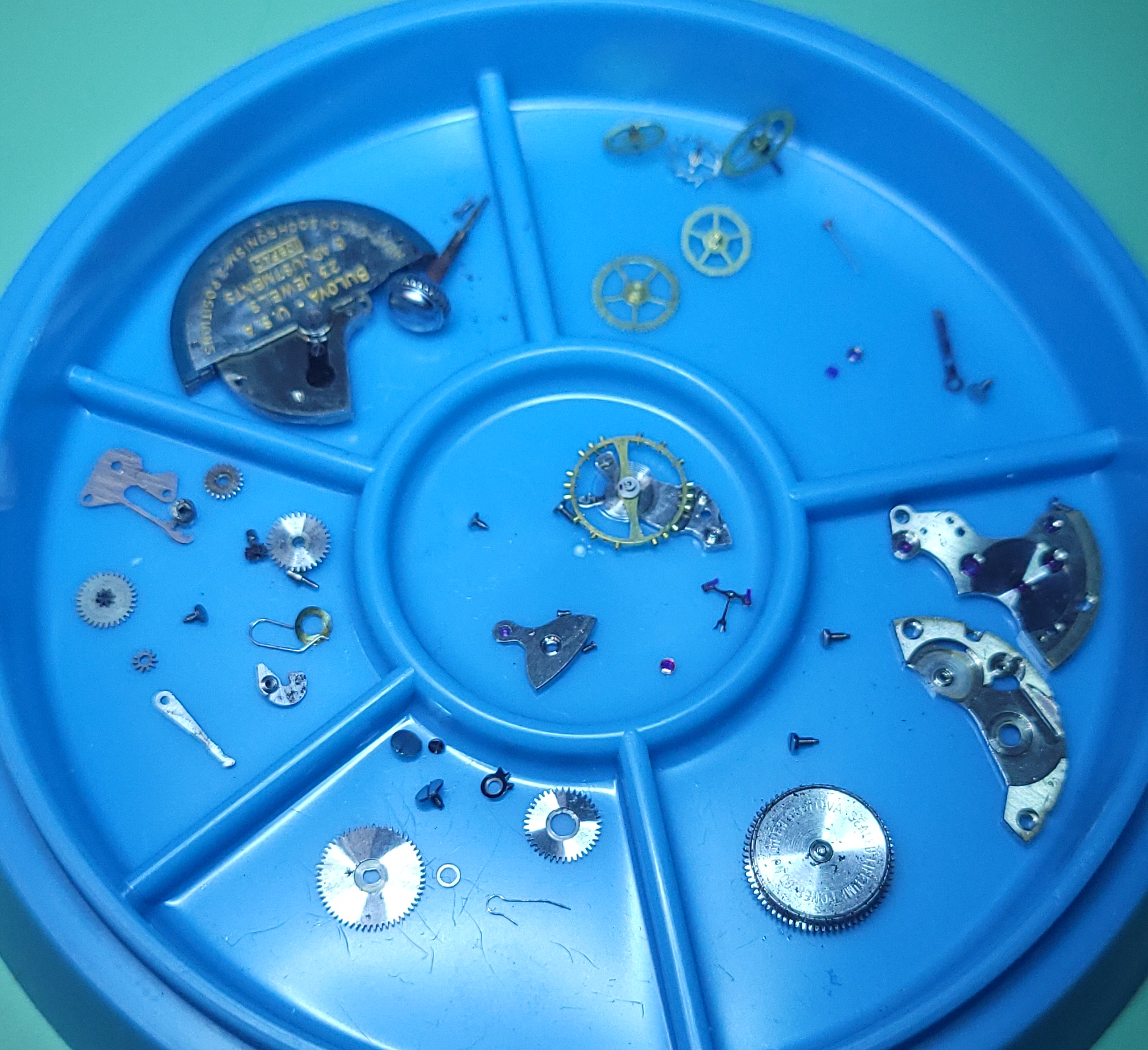

While I'm waiting for cleaning chemicals to arrive, took apart this nice Bulova 10BPAC. I love the fluted bezel, and I really enjoy these Bulova movements.
This is a watch I picked up from Facebook Marketplace when I first started, and was too intimidated by the automatic works to take it apart.
It's time is now! I also pre-emptively bought a parts watch from eBay (on the right in the photo). It's got a yellowed dial, but otherwise looks nice as well. I'll open that one up next, but I've run out of parts trays 🤪
I even bought the Bergeon #3 Presto tool to pull that sweep seconds wheel.
It's a non-runner. The balance looks good, no cracked jewels, but there's a lot of resistance in the train. The stem had some serious corrosion, and it got all around the watch, so I'm hoping a good cleaning and oiling is all it needs.
Now the only question is: do I follow directions, or do I take this spring out and clean & lubricate it? I've never been good at taking orders...

Yes, take the mainspring out, clean and lube. I've worked on about a dozen of these in the last 4 months--let me know if you need qny help. One thing to definitely look out for is play between the barrel arbor and the bridge--not correcting that will casue a significant loss of amplitude. Also, do you have any plans for the donor case? I'm in need of one for a movement I have. If so, PM me. Thanks

Even if you are not impressed with its positional variations.  this quality movement deserves new mainsprings.
I did notice a bit more than I'd like. It looks like there's already a brass insert there, but I couldn't tell if it was factory or not. I'll get some photos later.

Just my .02 but you don’t have to replace the mainspring by default—if it looks good (good shape, no grinks), just clean it and relube and reinstall—I’ve done the majority that way and have been getting 280–300 amplitude dial U/D if all else is in order. I’ve only replaced the ones that are broken or deformed.

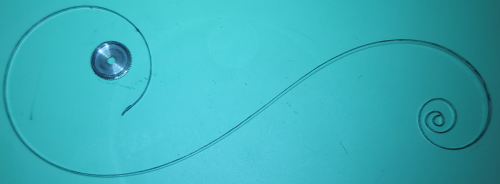

The mainspring looks good to me. It does have a detached bridle. I've had trouble getting detached bridles back into the barrel in the past so I'm a little hesitant to pull it out, but I suppose it does need to be taken out to be cleaned properly.
20230105_224135.thumb.png.075022b903c210addece3def3510b867.png20230105_224148.thumb.png.39745f7f01d0180616662b0576c60036.png
Here's the hole in the barrel bridge. It does seem to have been sleeved, whether from the factory or not--I'll have to open the other one and see. Do you think closing it up with a rounded stake will still work here? Top:
Bottom:
Well, to my surprise, the watch on the right with the yellow dial started right up and runs strongly. Dial up and dial down:
There's almost no play in the barrel bridge. It does look like that bearing sleeve is from the factory:
Looks like instead of a parts movement, I've got a fine working one! Maybe I'll swap the nicer dial onto this movement. We'll see how the other one comes out.

Notice on the rotor it says "adjusted in six positions " this is a good grade oscilator/ watch.
Needs a new barrel complete.
Rgds
Notice how nice dots form the line and only few dots are scattered,  thats the machine distingueshes every single tic in good order, indicating good grade hairspring/ oscilator/ escapement.
Shame to put damaged barrel and spindle broken spring back in.

I normally don't take out the bridle--I just soak the barrel in napha and clean with a soft paint brush before putting into ultrasonic. Like I said, whichever one of the cases/movements you decide to not to use as a whole I'll take dibs. Jay

My concern is being able to apply fresh braking grease. There has to be a good way to get that bridle back in place.

Oh I forgot to mention--for anyone trying to get a detached bridle back into the barrel.
I turned my mainspring winder upside down and carefully fed the bridle in through the slot on the side. I was able to gently slide it in by pushing with tweezers and pegwood while making sure it didn't pop out the top with a gloved finger.
It was surprisingly easy. The hardest part was all the time I spent making sure I got the hook orientation right, as well as which end would overlap the other.
Make sure your disassembly photos are better than mine! And don't forget to make sure the winder you choose for the mainspring is small enough to fit *inside* the bridle you just installed.

somewhere lurking in this discussion group somebody actually had mainspring winders specifically designed to put the bridle in. Fortunately today the mainsprings are all supposed to be assembled and not require that tool.
I did consider trying to wind the bridle up with the mainspring, but that seemed even more fiddly and prone to hurting myself.
I also searched this forum but was unable to find much on the subject. Maybe next time I come across it I'll be more thorough in my searches.
I created some slides as part of a lesson I do on these types of mainsprings. The one in the slides is from a Felsa 692
