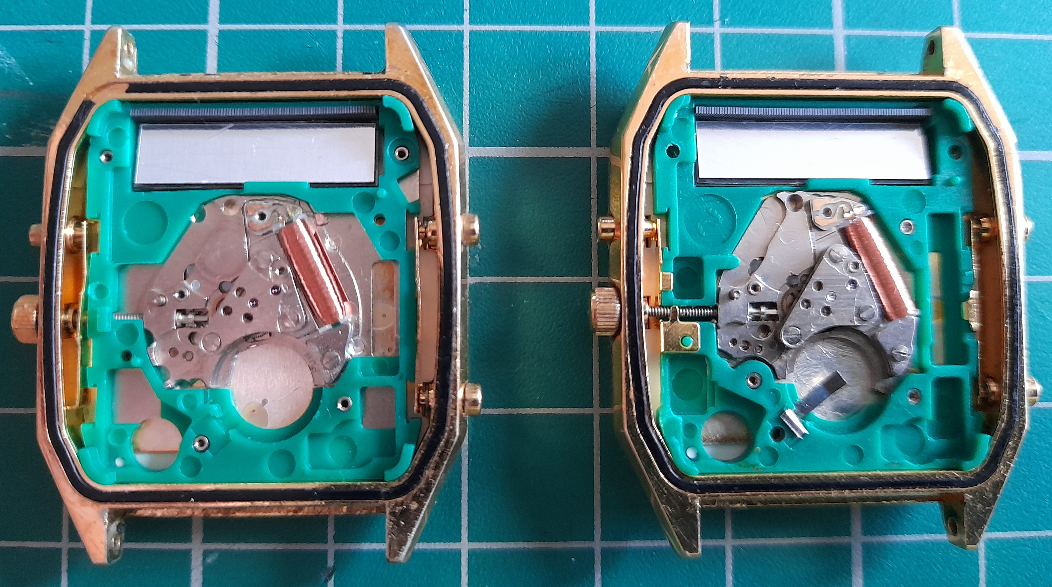

I've been meaning to post this in the hope this may help others as I know there is a following for these. I didn't come across much on the old internet.
It's been a slow burner (well over a year) as when another pops up. Most I've seen have all had battery leaks and/or missing battery contacts. As with this hobby you seem to end up with another watch in the hope of fixing the one you have!

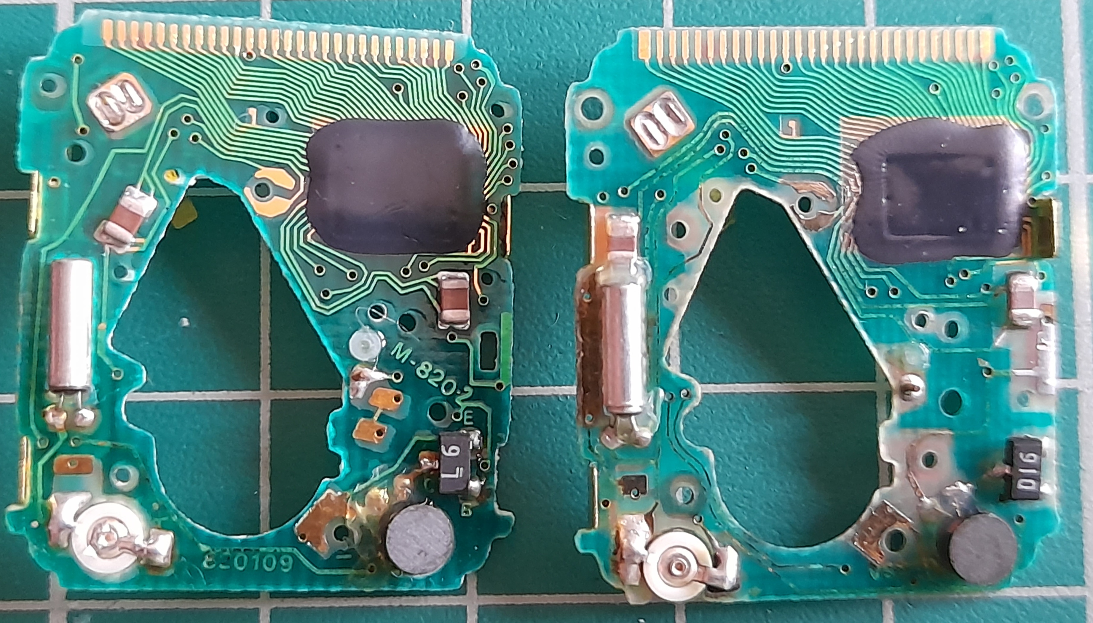

Mine started with one that came in a job lot, managed to get the digital side of things working, but the very fine wires on the coil are broken. Analogue side no go. I didn't have enough magnification at the time. Then I managed to get a second one in the hope of swapping parts to make a working one. That's when it got interesting as it seems a Timex V Cell Ana-digi is not all it seems I guess on at which point in time it was made. From the outside they look almost identical.
Once you get inside you can see the subtle differences between them. This sadly prevents swapping the circuit board, coil or even the movement holder, or to fault find/getting it working
I guess the 6 jewel version is the older one and over the passage of time to cut costs by Timex and HANDOK (Which I still think are around) the jewel count was reduced, along with a few other changes.
By good fortune and a lot of patience third time lucky I got my hands on my third which is likely late 1980's. This time after a bit of cleaning and repair to the battery contacts this one worked.
Any way the one above sits proudly in the collection now. I hope this may help someone on a similar quest, not all Timex V Cell Ana-digi's are the same..... perhaps there's another version out there to add to these?

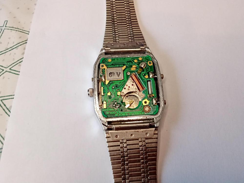

have one very similar, very new to watch repair, analogue works fine, a few segments not working on LCD. Have removed scratches from Cristal. Hope finish it next week.
Nice watch Babelman, and it looks like you have an original strap. Another subtle style variation.
I reckon if you carefully clean the zebra strips you'll get back all those missing LCD segments. It's great that the analogue works that's normally the part that doesn't because of a leaked battery.
Any chances of a photo or two of the module?
Also does the alarm sound consistently, or does it become more urgent toward the end of the sounding? That's one thing I forgot to mention in my earlier posts.

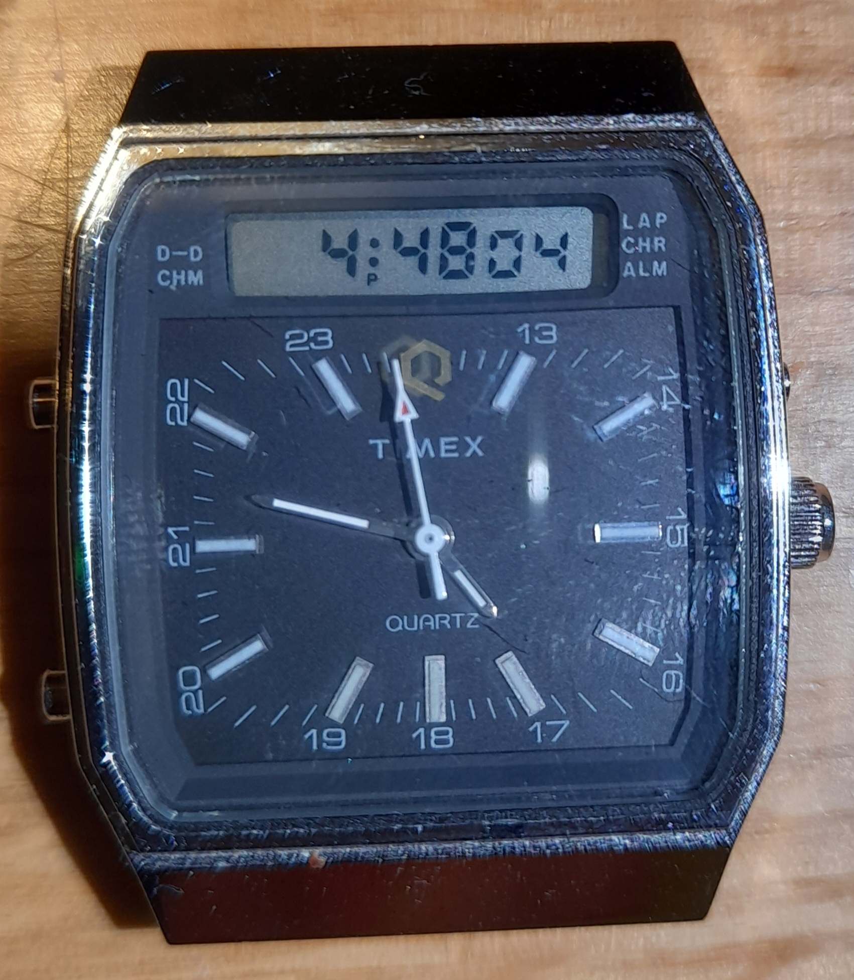

Hi thanks or info, trying it now. Here is module photo
Forgot to mention Alarm not working, maybe it will after cleaning etc, will let you know if I get back LCD, hope so as always liked this watch, never got one when they came out new.
Looks like you've got the 6 jewel version, nice.
In regards to the alarm have you got the small piece of plastic (red in colour) which goes over the spring contact, like in my working version picture? It's likely shorting out hence the alarm not working. If not you could use a tiny piece of plastic bag and or tape to test it out.

rehajm, I think "unadjusted" is a historical thing which looks to have been carried forward onto these Timex's. I've seen mechanical movements with the same, or with such markings as one or two "adjustments".
I'm now going off to find out more myself, good question
