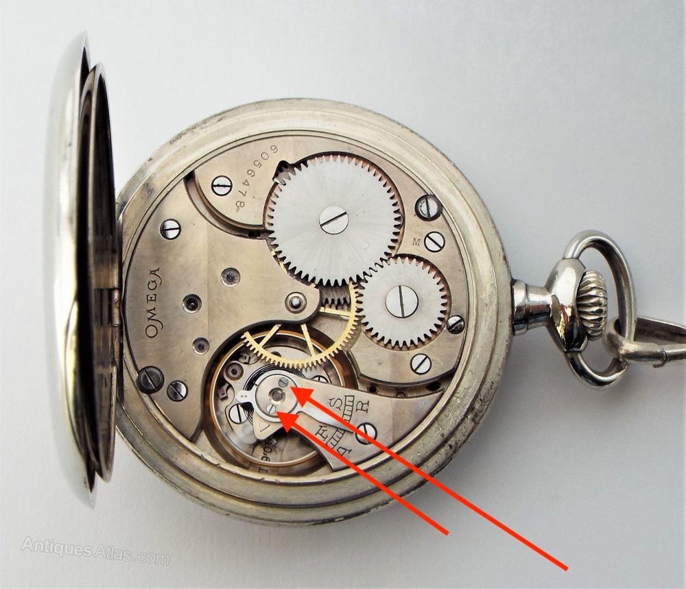

I've never serviced a non-shock movement, but I have seen how to go about it. How fiddly was it taking the cap jewels out/in?
In this case, you don't. On the balance side the regulator arm comes off (two tiny screws) together with the cap jewel disc. This allows you to clean & oil the cap-jewel. That's also the moment you peg the pivot-jewel. Best / safest is to remove the complete balance wheel so you work with the bridge only.
1920s_Omega_pocket_watch_and_c_as170a7807z-5.thumb.jpg.7a6b13f49a3c19fac789bc347893b392.jpg
The main-plate cap-jewel sits in a disc, which can be removed by undoing 1x tiny screw. Again, clean & peg the pivot jewel, clean & oil the cap-jewel before replacing it.
