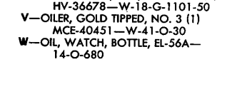

This comports with the US military repair manual from 1945...as shown in these images.
Where did you dig up this historical information?  Well done--competing with @JohnR725for watchgoogle.

My Dad completed watchmaking school in 1947.  He had two bottles of 56a in his watchbench I inherited.  If he bought it new, they were selling it in that time period.  I have six bottles of the blue Elgin oil which does not say 56-b, but it most certainly is.  One of the 56a bottles is empty and the other is 3/4 full.  The blue bottles are mostly full except for one as I recall.  All this seems to mean both oils were available concurrently...at least for a time (as I mentioned above).
