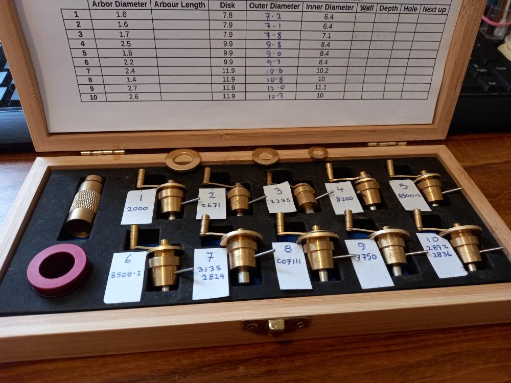

Adaption of the comment from  Mikepilk.
I purchased some brass washers and have spent some time filing out the innards to fit the outer size of each of the Chinese winders. I now have the facility to place 10 different size springs left or right. It would have been too long to wait whilst I purchased springs of each size. Total cost £6.69p.
Just for information. I was unable to update my post with a picture of the washers I had made to use for reversing springs into barrels. Took me a about half a day of filing. Using a small half round file from the Draper mini file set. Sore fingers tips and no fingerprints on parts of my left finger tips. I have left the washers visible to show which I used M6, M8 and M10. You can see them placed on the barrel insert just below the winder on each.
Not used them yet. But got them for future use. Another DIY project completed.

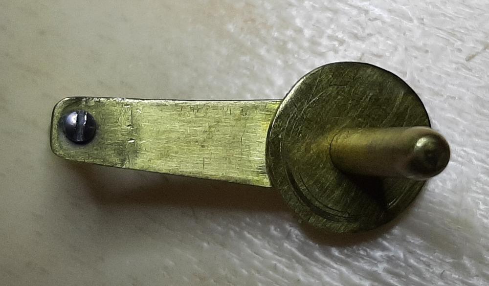

If you like DIY, and there's a particular size you use a lot (e.g. Seiko), you could have a go at making a winder. I did it without a lathe, only a hand drill.
Saw that. I'm not to your standard of skill. Long time to go before I could get there.

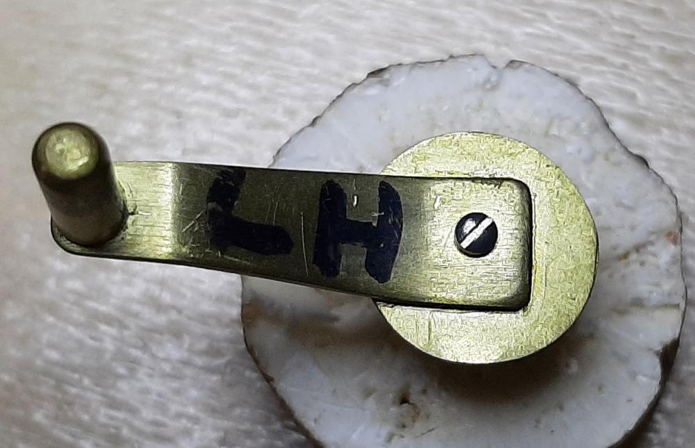

On 2/25/2023 at 10:48 AM, mikepilk said:
If it's the opposite wind, like Seiko:  use the normal winder, push the spring in to a suitably sized washer, turn it over, and push in to barrel.
I only have a small set of winders, so I made a reverse wind arbor out of brass, just using a saw, drill and a file. It's not difficult.
Mike what did you use to latch the mainspring to the arbor,  i'll have ago at making a couple of these.
The top and handle are made from 0.8mm brass sheet. The arbors and handle from brass rod - I made one 3.5mm and one 2.8mm.
The arbor and handle are held on with 1.2mm screws (Cousins part S48390) - drill 1.0mm holes and use a 1.2mm tap (Cousins part T48756). I used Loctite on the arbor screw.
The tab to catch the mainspring coil - I drilled a 1mm hole (a bit tricky with a hand held drill)  and tapped a 1.2mm hole then screwed in a 1.2mm screw. Chopped the top off, and filed to shape.
1.thumb.jpg.5ba899e8c73be0c13e15272e4a2a15b2.jpg2.thumb.jpg.4d9b83d5f5aaaccb9010cfe28b6e00a4.jpg
Thanks mike for the extra photos and description, nifty trick using the screw to create the hook, i will make a couple of left hand arbors.
Cousins are selling the bergeon left hand arbors alone for more than they sell the left hand winder and arbor together, it just don't make sense.
They are a bit rough, but do the job.  I made them after a couple of failed attempts to use the "washer method" - either I couldn't find a washer the correct size, or both washer and spring flying across the room.
Good luck - post a pic when done.
