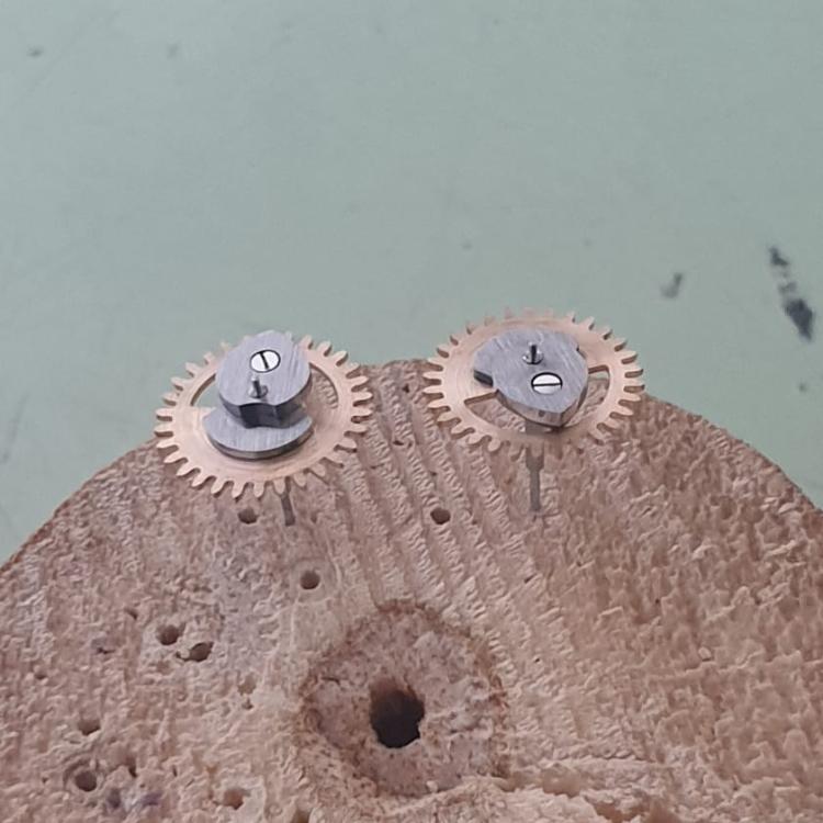

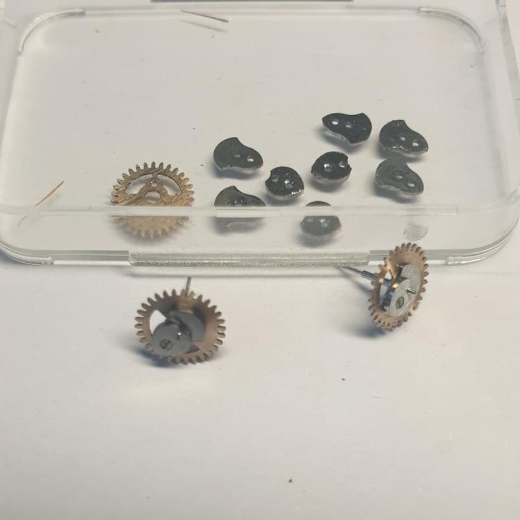

I use a CNC milling machine almost daily to make watch parts. Both for prototypes and for repairs. An example of repair was 2 sets of  minute counter wheels complete, for Valjoux 71. The customer couldn't find spares anywhere, so were willing to pay to get these watches functional.
4 different components (per wheel), 4 different drawings, a fair bit of time spent on the measuring microscope and profile projector to get the info needed for those drawings. 3 made on CNC, one of those then cut with a gear cutting machine (with specialized cutter of course), one turned on the lathe. 3 of them heat treated, then finished as needed; for example the arbor has the pivots burnished, all other features polished, there are 3 critical diameters that are kept easily within a few microns. The heart cam is mirror polished on its perimeter. Counterweight is grained. The wheel has a circle grained finish (and is beryllium copper).

I use a CNC milling machine almost daily to make watch parts. Both for prototypes and for repairs. An example of repair was 2 sets of  minute wheel counter wheels complete, for Valjoux 71. The customer couldn't find spares anywhere, so were willing to pay to get these watches functional.

How do manufaturers polish cams?  Different process  than you do for single piece I suppose.

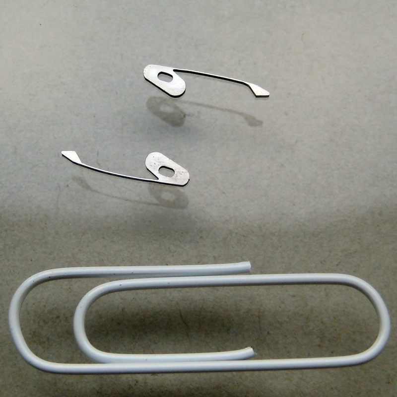

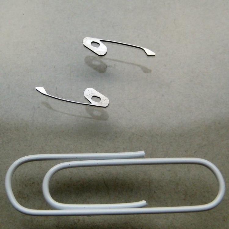

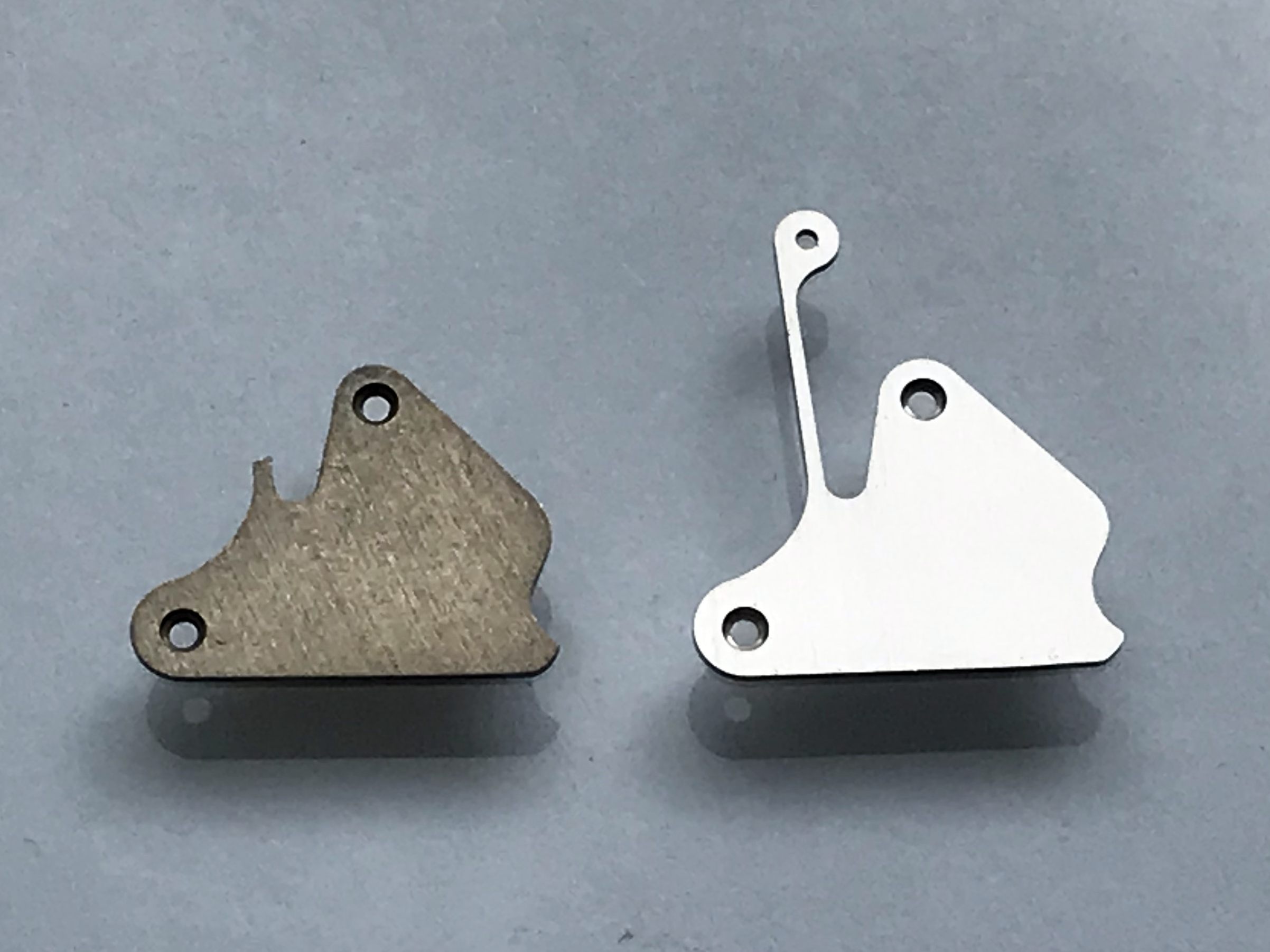

I have flat parts made by CNC laser fine cutting.
Most work is measuring and making the CAD drawing. But my laser comp can do even this for a reasonable price.

Nowadays they would almost certainly do electrolytic polishing in batches and call it good. Back in the day I'm quite sure the cams were mounted on little holders and the worker- most likely women- ran them handheld against motorized laps, expertly, all day long.
Same for pinions. Now it's all electrolytic (with some rare exceptions). Back in the day, even a lowly AS mass produced hum-drum caliber would have the pinion leaves polished with wood laps, tip to root, stunningly. Pivots roll burnished, always. Now the pivots are generally roll burnished? Pretty sure? They sure don't wear like the old stuff. That is, they wear faster.
For parts like these I hold them in a little tiny vice under the microscope and take the cutting marks out with 20 or 12 micron abrasive paper on a flat steel handle, work down to 3 micron then final polish with either 1 micron paper or with wood and steel polishing paste in a hand motor. Have to keep turning the part in the vice of course, haha!
For pinions, if it's not ultra high grade or just preliminary prototype work, I hold the pinion between centers (often an old truing caliper), then with about a 20mm radial bristle brush running in the lathe with steel polishing paste, bring the leaves up to the brush. If you get it right they auto-index kind of like with a rounding up tool (or a wood lap pinion leaf polisher). Get them to index both ways a few revolutions, flip 180 degrees, same. You can get quite a good finish on the functional part. You won't have a crisp face. For really high end stuff I'll drag out the pinion leaf polisher and dress a wood lap for the pinion- it's different for every module- and spend the time necessary.

Do you have an inhouse CNC machine? Or you some CNC shop? Is it a specialized CNC machine for watchmaking?
I have used several Chinese CNC shops for somewhat larger parts (25 to 300mm). There are many that are willing to do 1 parts or small batches. In different price levels and quality levels of course. However I am sure there are some working with really smal parts as well. Have not looked that closely.

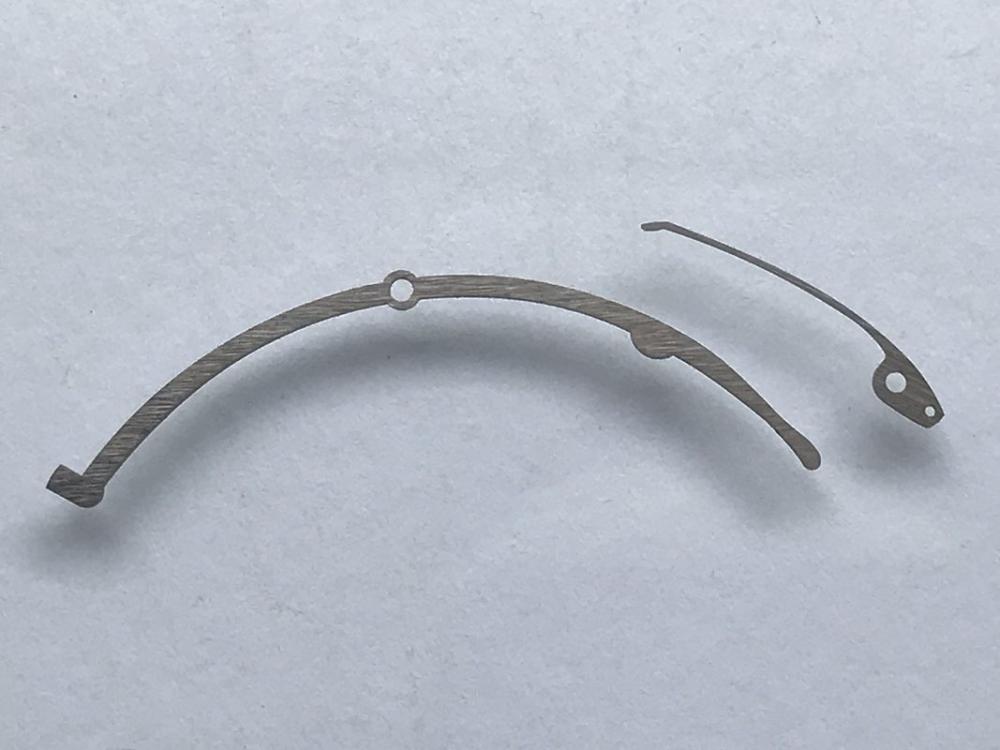

This seems like something I could start with. And it looks like a part that is prone to breaking. Do you use a stainless spring steel for the replacement part? Or carbon steel? I assume that there is no heat treatment, the sheet is of spring steel in hardened state before laser cutting?
I used both, but with stainless you can avoid the needed nickel plating. No additional hardening required. My laser cutter however also offers a special Swiss stainless alloy that can be further hardened after cutting by keeping at high temperature for some hours.

Laser cutting might be a possibility for flat parts in the keyless works but not for much else.
the problem with a laser cutter is it gets hot, very hot and vaporizes things but can leave a burnt edge. Seal definitely have to do finishing but they are really nice for well square holes are really nice. Francis of I need a square hole in a mainspring I ask it work nicely and somebody might cut a square hole for me they do engraving where I work and they have a fiber laser that will cut metal. Occasionally I've needed something a little thicker than a mainspring and it definitely gets a burnt edge to it so that refinishing is a must
probably rather than a laser wire EDM machine. With a vantage of you can cut Springs steel that's already nice and springy and not worry about it getting hot like it would know laser and they finished should be relatively good. So the absolute perfect I think for setting and keyless components.
