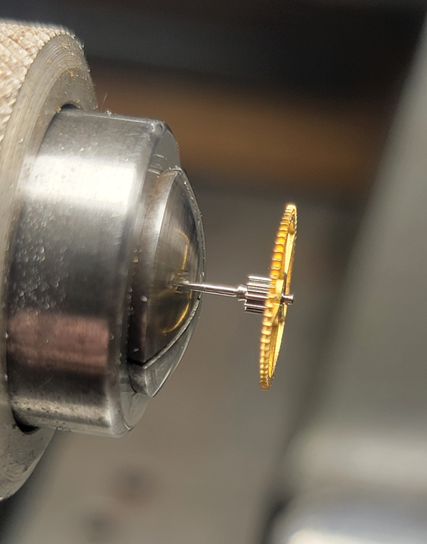

This watch (A Waltham 0 size) has been in my drawer for some time...must have bought it on ebay.  Started to repair it today and noticed right off that the center wheel pivot was broken and stuck in the cannon pinion.  It was easy to punch it out, so I have the reference for making a new one.
My plan is to turn down the post all the way to shoulder above the pinion and then drill a hole in the pinion and mount a new post.
Then I have to do some curvature adjusting to fit the cannon pinion.  Not clear how I will do that just yet.
No real downside because I dont have a case for the watch.  I must have bought it for a donor...just cannot remember.

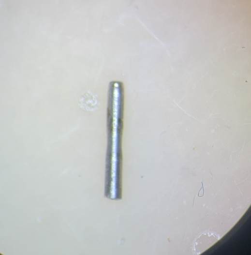

OK, I have the old pivot removed and have turned a replacement.  What you see here is not final.  It is a friction fit, but I want to use Loctite to fasten it in a "reversible" way.
I have Loctite 680 and 648 but not sure which is best.
Edited by LittleWatchShop
Excellent work.
48 minutes ago, nickelsilver said:
648 is what I would use. Still good to have a light friction fit, but at least a "sliding" fit with no perceptible play.
Super!  That is what I will use!!

Well, an update.  I must confess my sin.
When I turned down the rest of the post before drilling and inserting the new one, I failed to notice the diameter of the pivot that rests in the bushing (the shoulder) was greater than the rest.  I illustrate what I missed below. The arrow points to the additional diameter that I missed.
So, rather than turn a new one, I stole the pinion and shaft from a donor (the wheel on the donor was broken in half).  This was not as straightforward as I hoped. The dimensions of the replacement part were larger and as a result, there was ZERO endshake (perhaps negative).  I had to turn down the part of the shaft that rests on the bushing to make it fit.
Live and learn.
