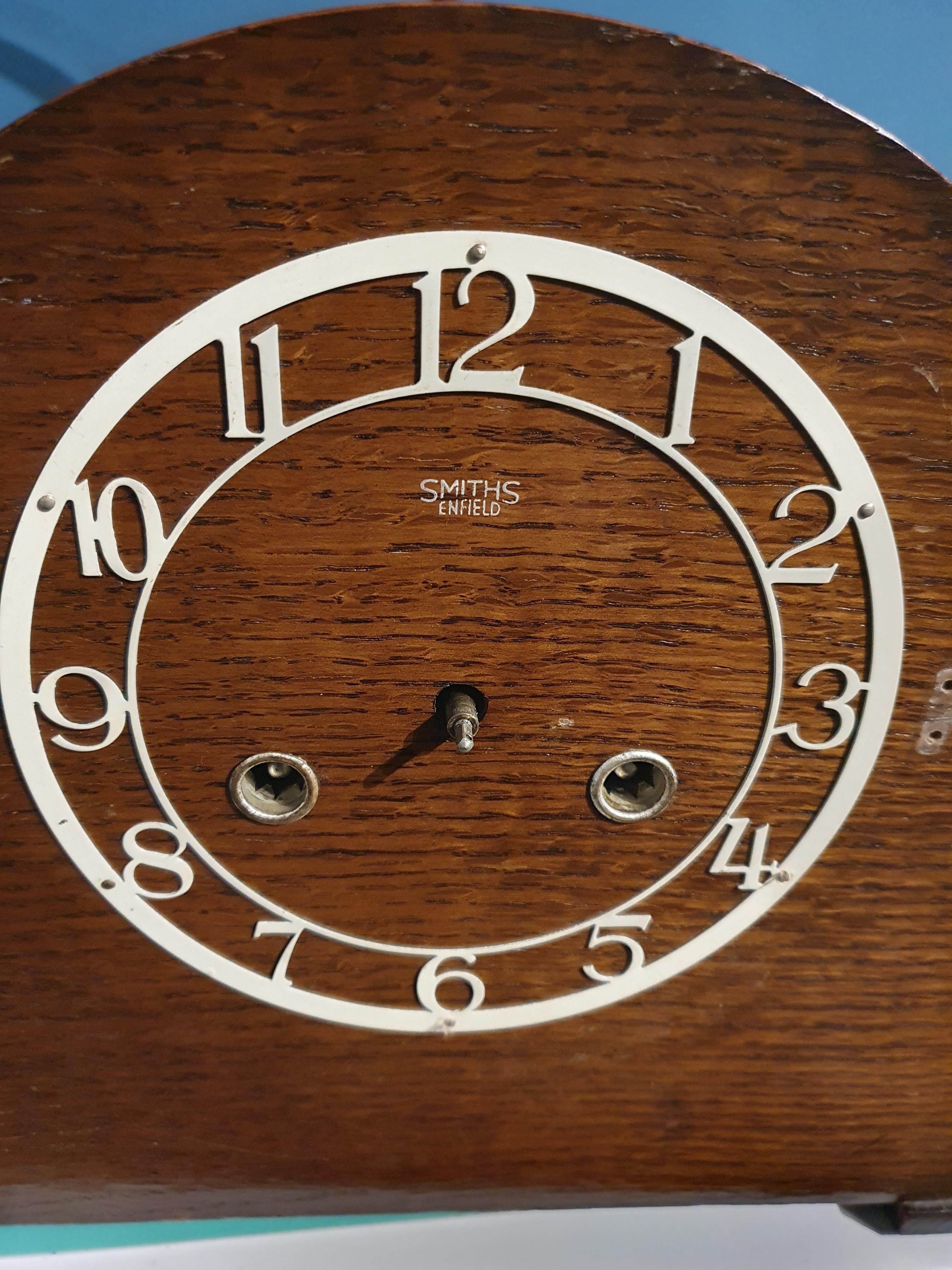

I've watched some videos today, I really am clueless, I thought the gong was a compensation device like a Bourdon tube. Hehe.

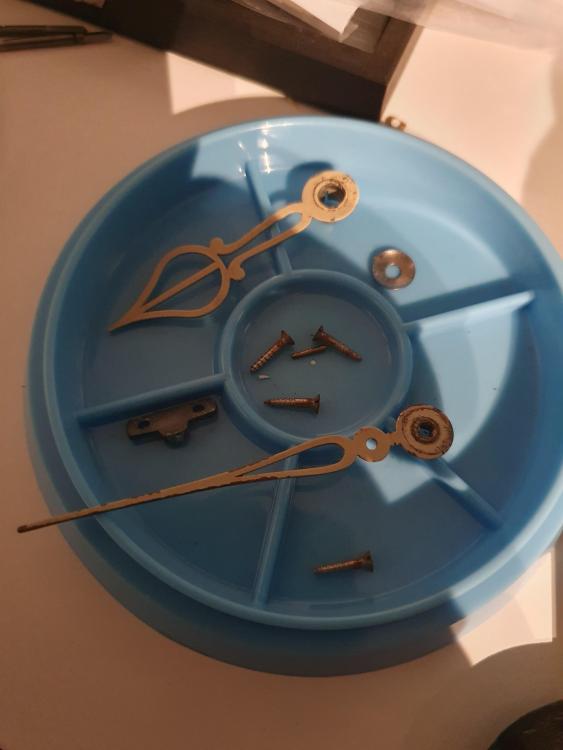

My first questions: the paint on the hands is flaking, do I remove and repaint?  Does the colour matter?  What type of paint.  How do I remove the dial without damage?  Do I renovate the whole case and reapply the Smiths Enfield decal?
The gong has some light rust, do I soak it in rust remover?
I think what you're asking is subjective and personal preference. Your clock looks rather fine indeed certainly better than some of mine I've practiced on. It doesn't appear to be rough shape cosmetically by any means.
Do you intend to return to factory fresh or retain some of the patina/character?
I would just wipe it with a rag and a little oil. Hands can if you wish be painted it is up to you. As its your first clock you might just like to see what sort of a job you make of it. I have found a video for you, I know of the person and I do not like some of what he does so I will make notes of what I consider to be bad, but I need to watch the whole thing first.
Hi Richard, when I do clocks , mine or other peoples I like to retain the patina and knocks and bruises they sustained in life. The movement is somewhat different and I like to restore it to working order. So you have an original clock and case. I have seen some back to factory condition and they always look false to me.  But it’s your clock and your descision as to how you want it. The case looks ok and would look better for a rubdown with beeswax and a buff up,  Clean the gong with fine wire wool and polish it with oil and a rag. On the Smiths the hands are the same colour as the chapter ring with the numerals. A creamy white as it ages. The chapter ring is removed by pulling the pins out that hold it , for that I use some modified top cutters. As it’s your first clock take your time and probably tak it to bits several times to get used the rebuilding, they can be as frustrating getting all the wheels into position as watches and as watches check as you go. Good luck
