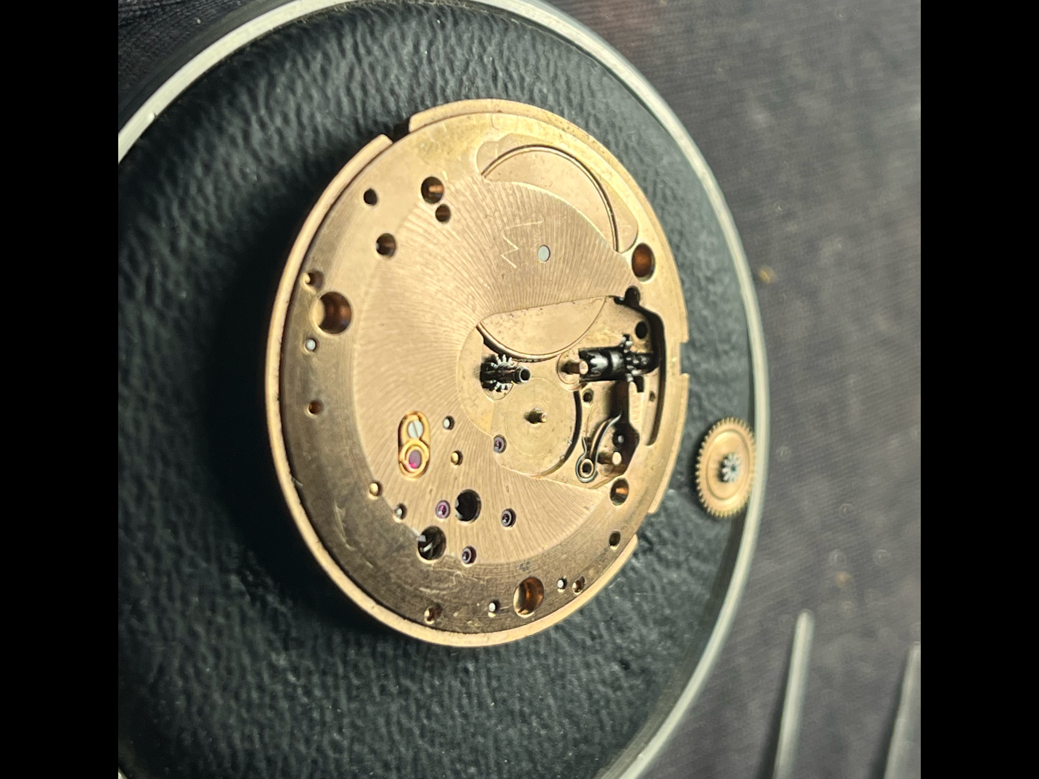

Hi Sorry it’s been a few days I’ve not been at all well three days in bed, I’m back in my little workshop now I’ve taken it apart but not sure of the positioning of every thing, do you think the winding pinion is in the correct position to the setting lever. I’ve looked for the caliber is this what you need WAF2110.
many thanks David
Hi David. From what ican make out from the picture it looks ok.  Best insert the stem and watch the action as you move the stem into its various positions, making sure the clutch wheel moves in and out to disengage and engage the winding parts.   Usually tag movements use ETA movements, have a look under the balance wheel for a logo (eta) and calibre number, eg. (2428) or somthing like that. Also a full picture of the back and front of the movement would be helpful.

Hi Richard, well that worked all stayed in place and working lovely thank you, I noticed on your profile photo you have  an omega I have a 1967 omega with a 601 movement I’ve replaced few parts and it’s working fine BUT the sweep second hand will not go back, on the hand itself it has a male pin so I’ve removed the sweep second pinion and that also has a male end so impossible for them to fit together, should the pinion have a female end has that broken off or the pin of the hand broken inside the pinion the pin on the hand looks quite long with no piece stuck on the end of it, would appreciate any help/advice many thanks David
Hi, I’ve removed the pivot and a bit confused I’ve looked on the download documents section on Cousins website and the photo of the movement the pinion looks male but another document says it should be 5.4 mm long part No 600 1250b I’ve measured mine at 3.7mm, but the hand is male also and the pin is 1.1 mm ( photo attached) so is one broken or both
Richard you were absolutely correct that was not a pin on the hand it was the end of the pivot, it took a bit of getting out but when it came it was obvious as you said the female end is the hand I was convinced it was a pin to fit in the pivot (wrong) thank you so much I owe you a watchweasol a pint thanks again David
