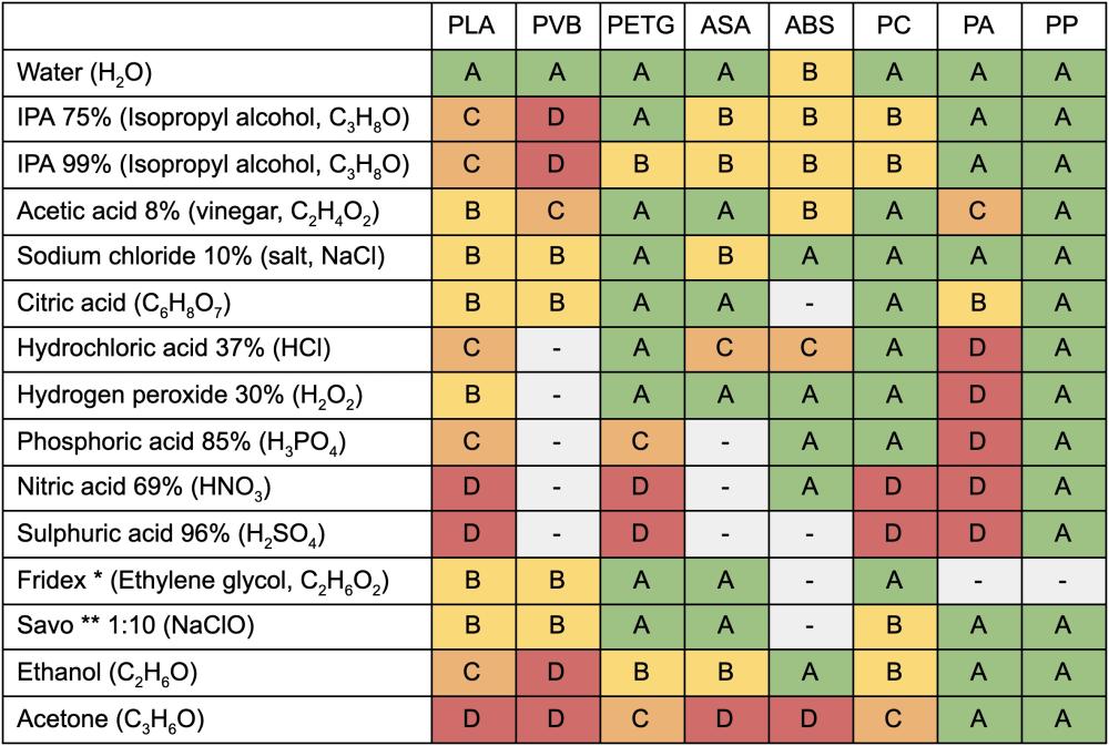

Is the plastic ok to use with solvents ?
Depends on the solvent.  ABS does have good chemical and heat resistance.  The worst that I am going to hit it with is IPA and eventually commercial watch cleaner.
I found this chart.
Rating:
A – Resists very well. Polymer does not melt, absorb substance, or swell during a week’s immersion (less than 1% change in weight and dimensions).
B – Resists moderately to well. Slight swelling or change in weight (2 – 3% change in weight or dimensions).
C – Resists poorly. Significant swelling and change in weight of the test sample (4-5% change in weight or dimensions) occurs with prolonged exposure of the polymer.
D – Does not resist. A red colour indicates a significant change in weight, severe swelling (change in weight or dimensions over 5%) or complete destruction of the fibre (2).
Data for the evaluation of polymers were obtained from our measurements under laboratory conditions and from a scientific publication (1)

Several years ago, I printed a gas cap for one of my poly gas cans.  Today!!  I was filling the can and discovered that the cap was crumbling.  It was printed with PLA.  I am not sure if the crumbling was due to the gasoline or the sun...as it gets a lot of sun.
I have done a little testing with PLA and L&R amoniated cleaner.  No sign of interaction.  Limited experiment.
