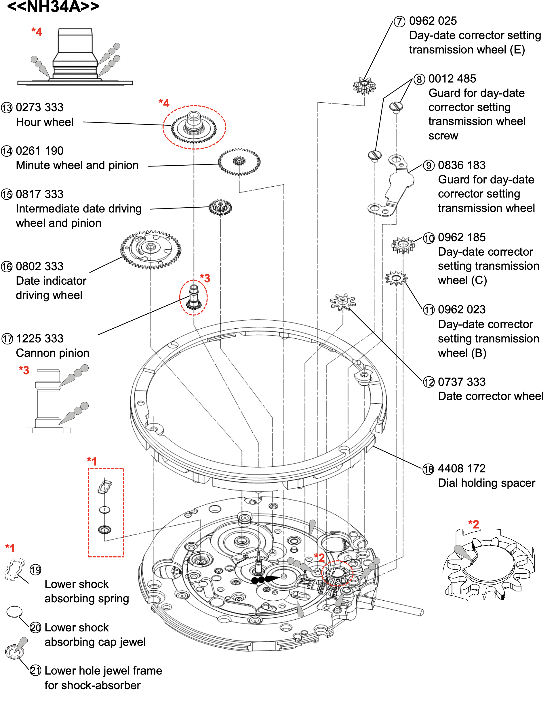

Hello everyone, I was wondering if anyone has had experience working with the new NH34a? I recently encountered an issue where the quick-setting function for the date wheel and GMT stopped working. I have already attempted to remove the first 2 layers, and while the date still sets when I move the hour and minute hands, the quickest functions refuse to engage. I am curious if anyone knows whether this could be caused by a misaligned gear in the quickest position? Unfortunately, I have not been able to find any disassembly or assembly videos online, but perhaps this could be a potential topic for someone to make a YouTube video about.
Also, when I removed Date indicator maintaining plate 0808 334 and Date jumper 0810 333, I did put Date corrector wheel 0737 333 back in place correctly I think. However at the second position, I noticed that both the date dial and the 24-hour wheel 0278 333 do not seem to be engaging. The date dial moves a little bit but doesn't click over. Is there a specific position that I need to place the 24-hour wheel in?

The tech sheet  shows part 58 (0962 183) that has a small spring that can become deformed and prevent the quick set from engaging. It is the same part used in the NH35 and Seiko movements (as indicated on the part), but does appear to fail more regularly on the NH34A.
On these movements the keyless works are accessed from the drive train side of the movement which is painful.
You can see the wheel on this diagram, the "Day-Date corrector setting transmission wheel (A)":

So I got down to the keyless and had a good look at the Day Date corrector setting transmission wheel. I think the technical term is the spring looks mooshed. I am going to get another nh34a and give that a gamble.

This post really helped solve why the quickset date and GMT stopped working. I was lucky enough to have a parts NH35 kicking around and swapped the Day-Date corrector setting transmission wheel and everything works fine now. However my confidence in this movement has been shaken. I have purchased many NH35 movements from Aliexpress without issue. This was my first NH34 and question if the failure rate of this part is high. The OP posted over a year ago and it seems that the issue is still there.
