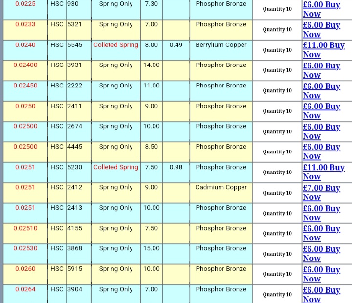

Of course there still is a minor pesky problem of as rare as the tool is you still need the hairsprings, the collets and the pins but worst-case you could probably make those on a lathe. But once you're armed with those you can go into business it was once a profitable thing for people to vibrate replacement hairsprings and seeing as how I don't think anyone does it anymore for variety of reasons just think of all the watches you can save if you can vibrate the hairsprings.
You can buy the hairsprings John, if you know what to ask for. I imagine a lot of trial and error to start with but once you have figured out how to calculate the strength ( torque ) per size thats required and the differences in materials. Just think of all that fun to be had and money to be made 😉. I know i want to have a go.
Edited by Neverenoughwatches

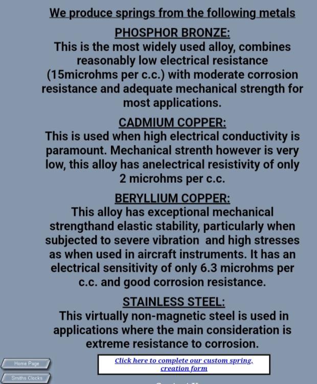

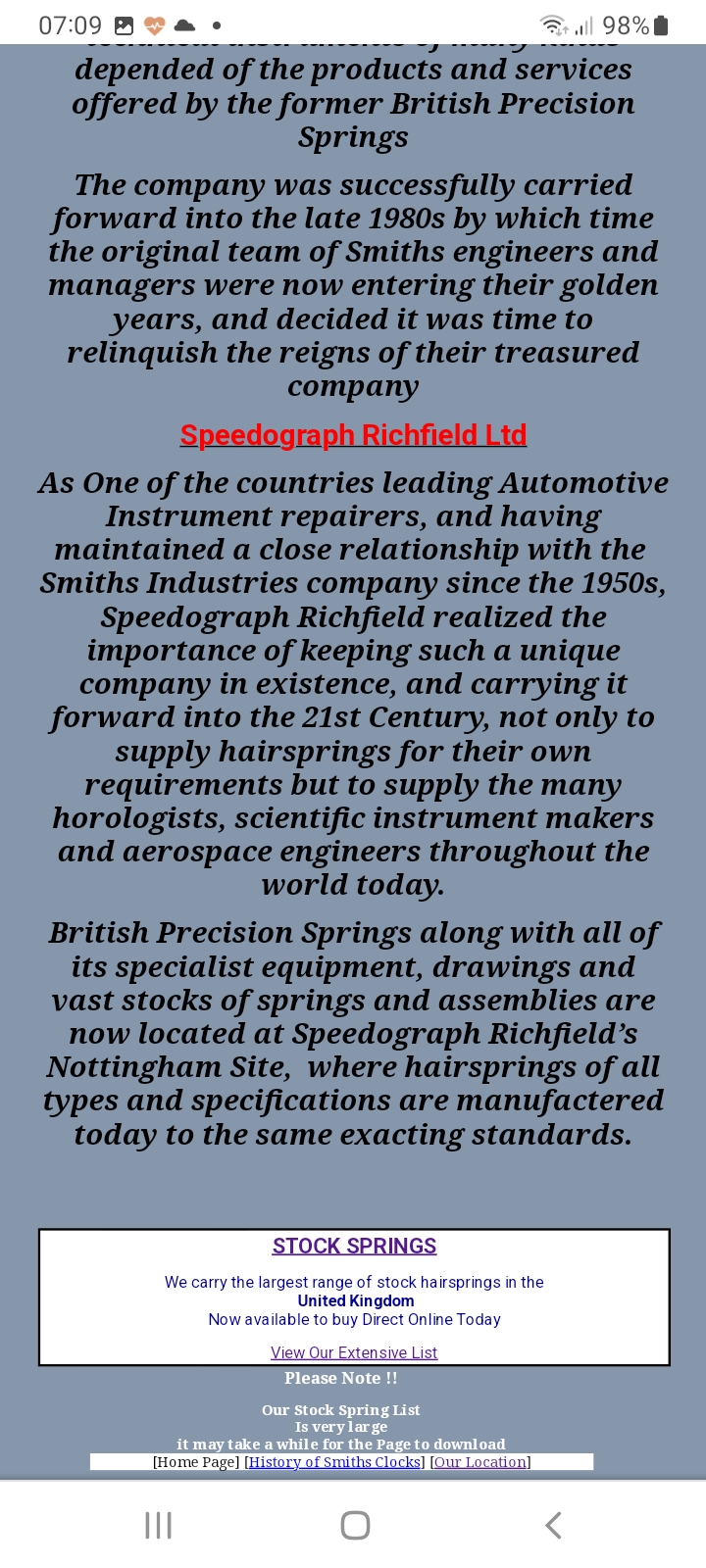

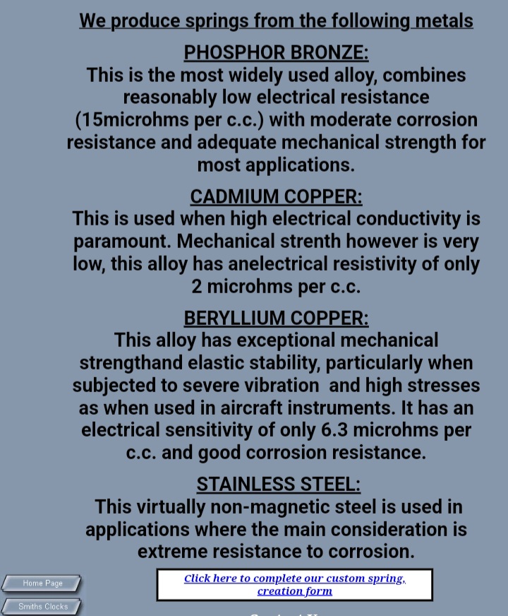

Super that means the article I read in the British horological drill several years ago is wrong so good but I noticed hairsprings are all made out of phosphor bronze I wonder if that's going to be an issue?
 Companies house still shows active directors ( very old )  but minimal assets so BPS is probably a dormant company. But this is from their site and Speedograph still have current opening hours, a working payment system via paypal and phone lines that i have just left a voice message on as it was before their opening times. Screenshot_20230329-070924_Chrome.thumb.jpg.0105817ebe03df6e6a11d6d902ca01de.jpg
