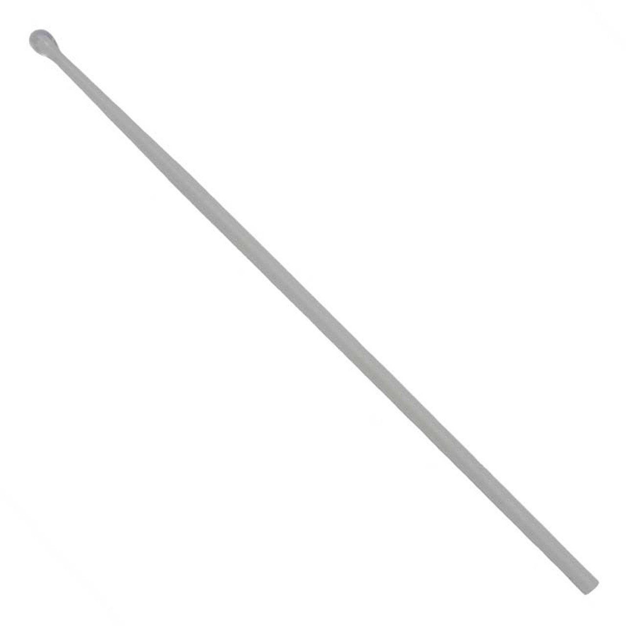

I like to use the Bergeon adhesive cleaning swabs for cleaning residue off of hands.  Does anyone have an alternative way of cleaning these swabs other than using the recommended 7007-c stick cleaner?

Not sure what will clean them as well as the cleaning pad from Bergeon (which they say to clean with isopropyl alcohol). If you are looking for economy, a trick I learned from the clever Finnish watchmakers around here is to make your own. They use contact cement- apparently the cheapest is the best. They dip the tip of a toothpick in it, making a blob about like the Bergeons, then wait 30 minutes or so before use. They would make up a dozen or so before doing casing up work, and use them throughout the day, pitching them as they get dirty. Seems to work as well as the Bergeon stuff! I used to use the contact cement for racing bike tires, worked fine even though it's "fancy" .
Ok, I gave this a shot.  I have to say it worked out pretty well!  Thank you for the great tip!

I also made some . Toothpicks dipped in contact adhesive,  the type that's used to stick laminate strips to kitchen worktop ends ( Evo stik impact ) I have to say they work rather well, maybe a little too soft and squishy but ok.  Bit of trial and error to get the blob right.  Shaping the end of the toothpick changes how much it can pick up. Also double dipping in the space of a minute increases the size, then hang them upside down until they are set. And as nickelsilver says ready to use in around 30 mins.  Not super sticky but enough to easily pick up hairs and debris from a dial without scratching, same for the movement and can remove smudges.  I actually prefer them to rodico. When dirty just pull the ends off and redip them.

Update on the contact adhesive swabs. After 12 hours the adhesive has set quite hard making them more usable imho. They still pick up fibres and debris just as well , but might lend themselves to dial cleaning as well as the consistency is similar to a hard rubber. Just be sure to put enough on to keep the toothpick covered, it doesn't need much as the adhesive is pretty tough. Heres a gross shot before lunch .
