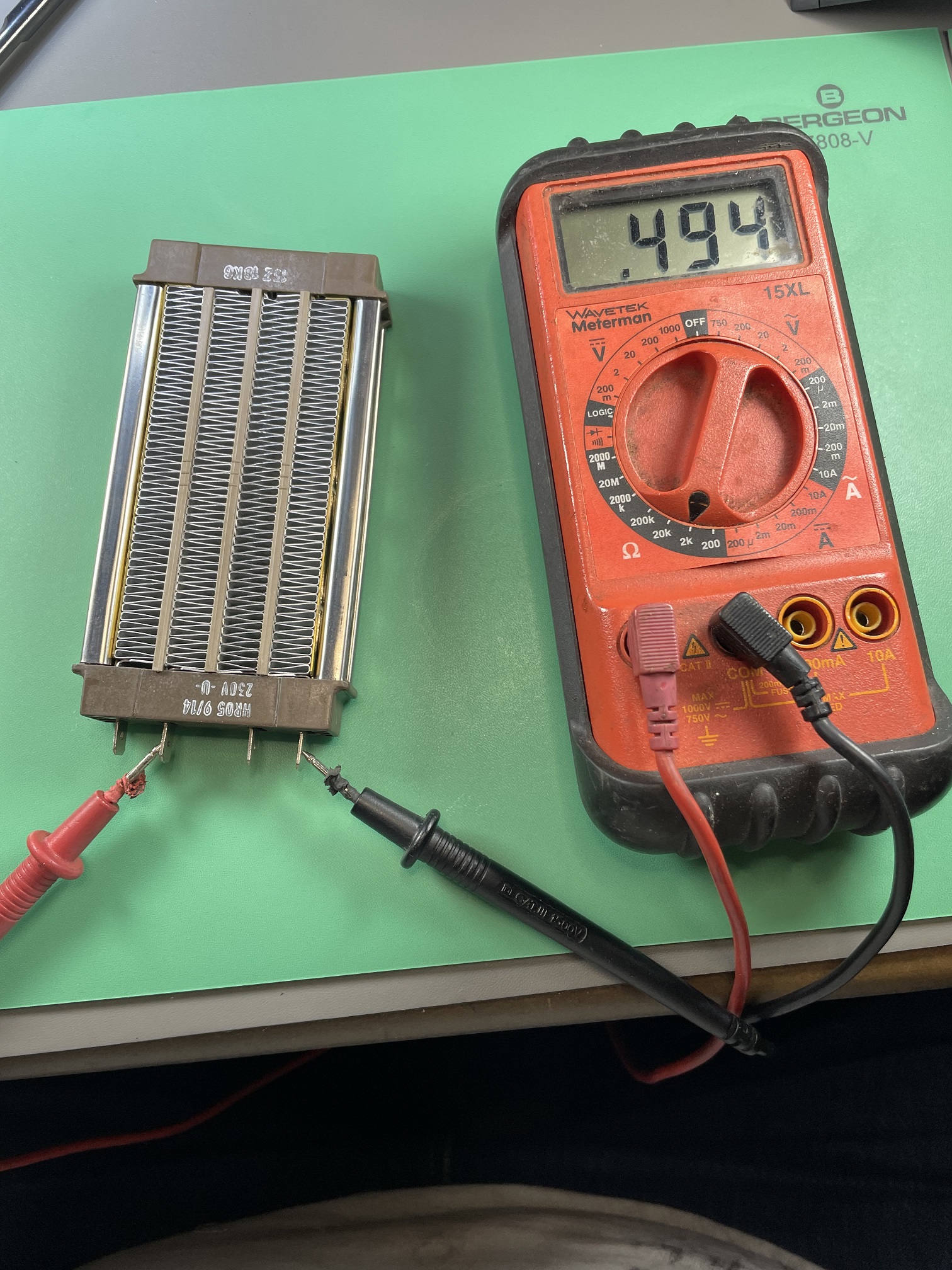

Two weeks ago the heater on my new Elma SE just decided to quit working.  I've been emailing back and forth with Elma's customer service in Germany, and they requested that I test the heating element.  They said I should be getting around 200 Ohms when testing the heating element (obviously with power removed), but they did not mention which two of the four leads on the part needed to be tested.  I'm the farthest thing from an expert when it comes to electronics diagnosis, but I am pretty handy taking things apart.  I removed the heating element and tested every combination of leads with my multi-meter.  I could really use the advice of someone who knows how to interpret these readings to tell me if they thing the heating element is bad.
The lowest reading I got was 233 Ohms, and other readouts of 240, 262, 494, 735, and over 2000 Ohms when testing other combinations of those 4 leads.

Something wrong with your 1-3 measurement.
Labeling L to R 1,2,3,4.
1-2 240
2-3 260
1-3 should be 500
Measure again on a higher range so we can see the actual value.
2 minutes ago, HectorLooi said:
I think the PTC heater is ok. That's why I asked him to measure the voltage at the connector.
Probably. The circuitry on the PCB would be helpful to see. Could be whatever drives the terminals of the heater. Is there I temp sensor that will cut off the heater if it gets too hot?
In section labeled XA, there appears to be some kind of thermostat relay. There's something strange about the schematic. I don't understand how voltage gets to the terminals 2 and 4 of the PTC heater.

No. The meter is not the issue. Even if it has a 20% error, for the measurements he took and the nature of the device under test, it would not matter.
Even if the meter gives bogus readings .......... interesting 🤔
240 ohms was one of the readings. For a heater operating off 110V, that is reasonable. Not bogus.
If the wire in the heating element was broken, wouldn't the reading be infinity? Yes, I know nothing has infinite resistance but the reading would be.  Please correct me if I'm mistaken.
The meter would simply read the highest reading. There is no infinity symbol on the meter display.
