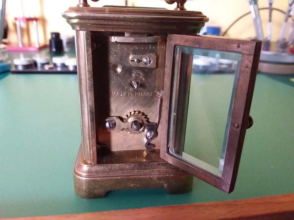

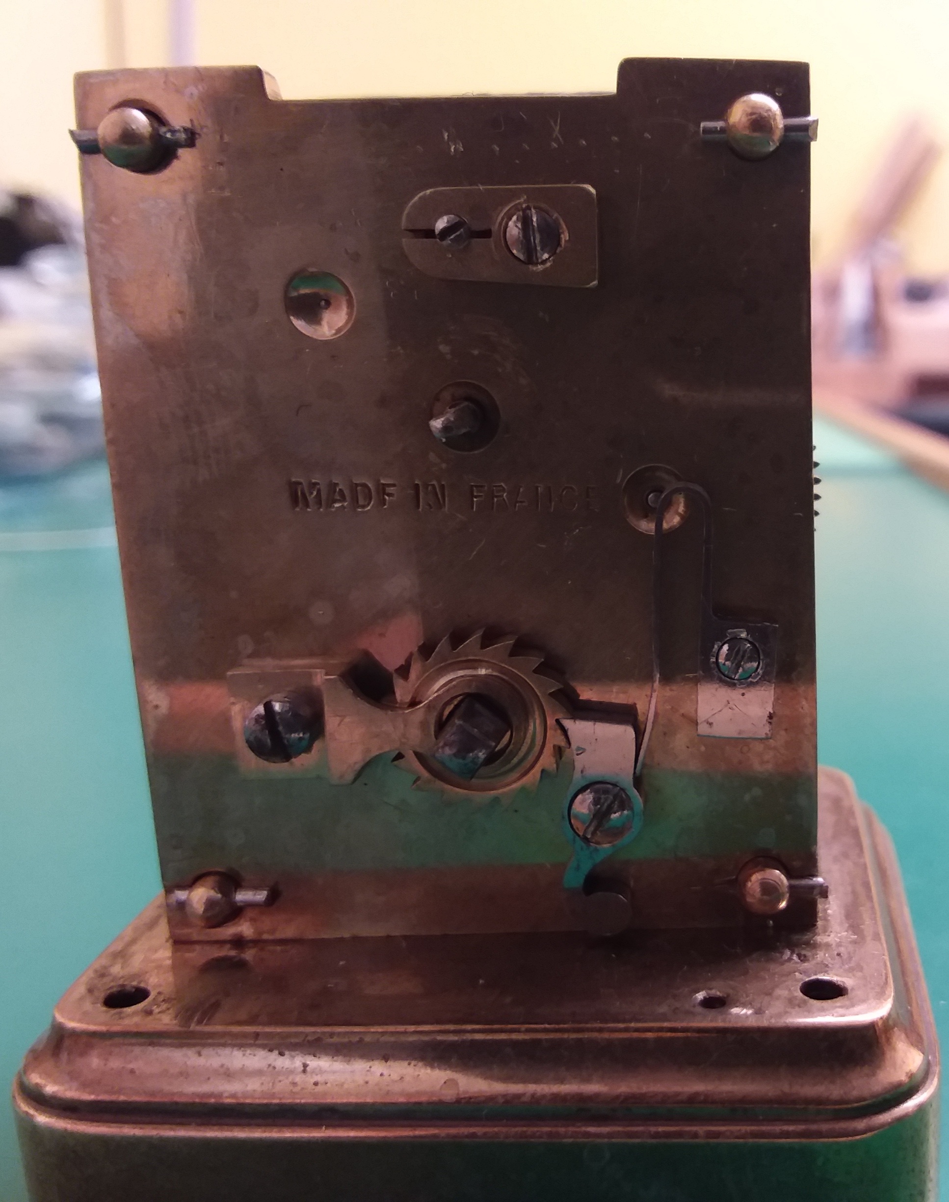

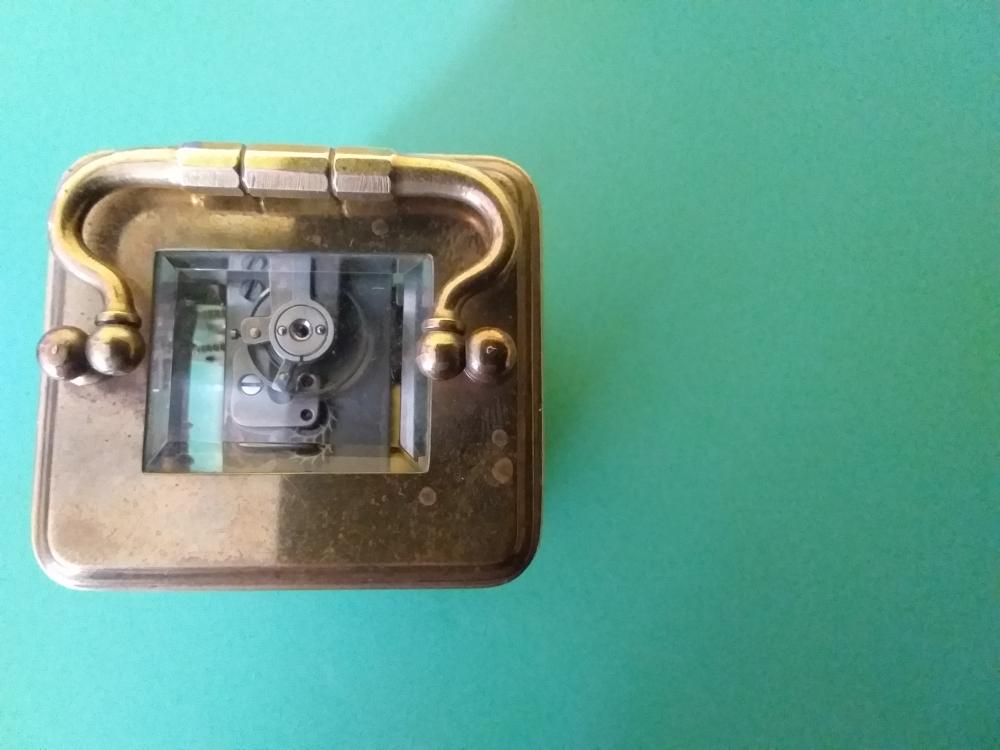

good afternoon, i have recently come across a miniature carriage clock, i have put it on the timegrapher it is producing a nice 18000 per hour however it appears to be gaining about 20 minutes per hour. There are definately no teeth jumping and it is a very consistent gain. I have no idea of the history of this piece or whether it is the original platform. Any ideas would be much appreciated
This is a genuine French carriage clock. It sounds like it has what is known as a sticky hairspring, could be dirt on it or it is magnetized. So that is the first step to take. I notice the back door glass is broken you need to get that sorted as dirt and dust will easily get in. The click spring is not original, I don't think I have ever seen one that big in a small carriage clock. Not sure about the platform. I need to see the movement out of its case, the screws I can see on the platform don't look right they look modern cheese head type which I wouldn't expect to see.

That is want I wanted to see. That is the original platform. Poor time keeping will be down to a dirty hairspring or as I said before it could be magnetized. Clean the hairspring in Ronsonol lighter fluid and dry it with your bench blower. Make sure the tools you are using are not magnetized, now use tweezers or an oilier gently push the coils so they touch one another and see if they stick if they do then the hairspring is magnetized and you will need to demagnetize it. I would also put the pallets and escape wheel through. I would also clean all the platform and you will need a Pocket watch oil for the platform.

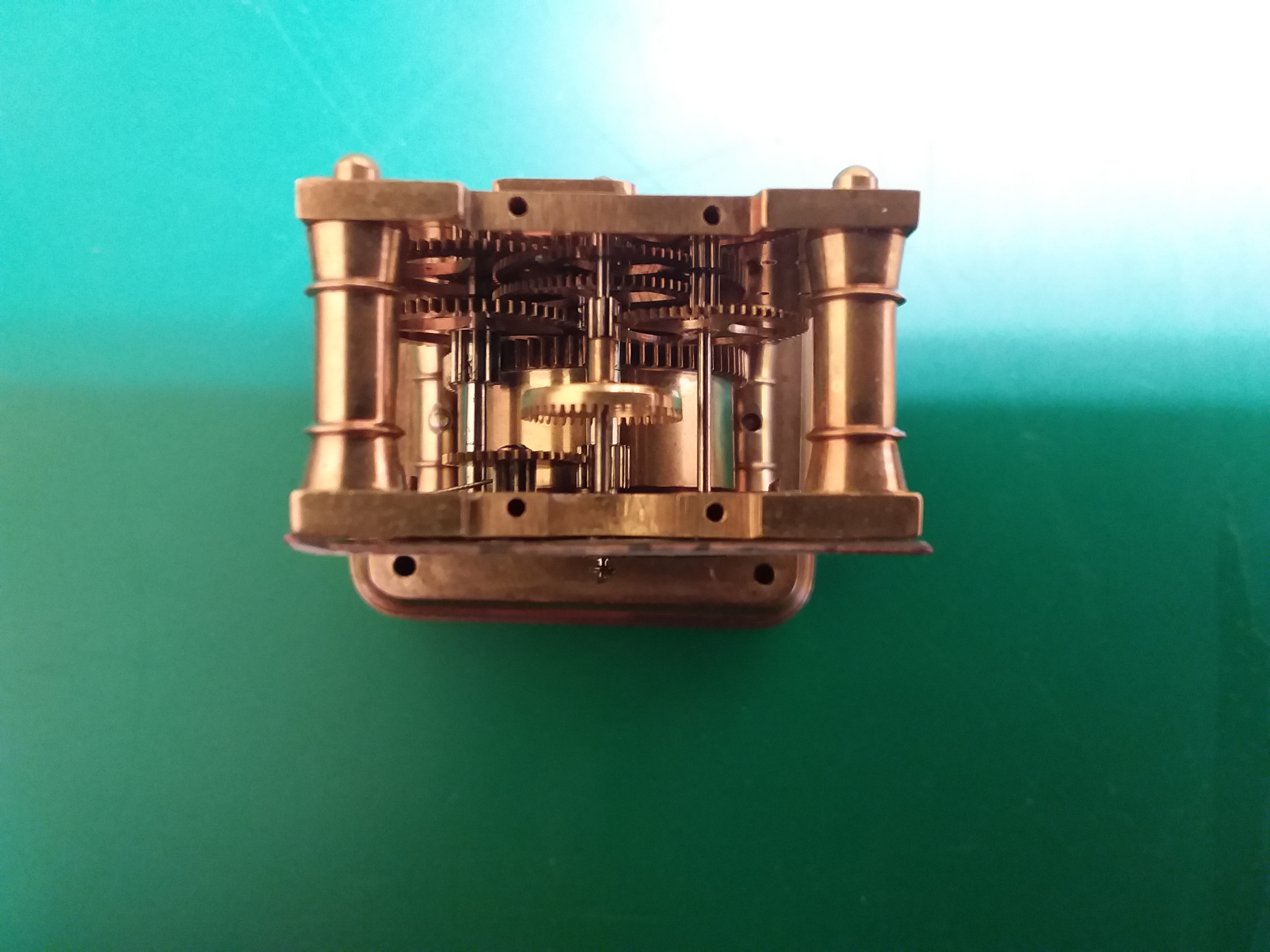

Hi all, i have taken the whole clock to pieces and counted all the teeth. Centre 70, 3rd 60-8, contrate 48-7, escape 15-8 i have done the maths and this comes to 13500 bph however if i change the escape wheel pinion to 6 leaves it gives me 18000bph. So am i looking for a new escape wheel and pinion or am i looking for a complete platform?

This is not the original platform but a replacement. The giveaway is the screw holes that hold the platform to the movement, there are only two in the platform, the movement has 4 screw holes which carriage clocks should have.
So you will need a new platform. I see you have done the Math. Meadows & Passmore is the place to go. I have looked on there site and they are closed for Easter but I would think they should be open tomorrow.
It took me a while before I noticed the old platform was not correct, however it did match to the movement. As I said before that is what I expected to see. A new platform will stand out like a sore thumb, the finish will be entirely different, it will have modern shock system. This is an example of a modern platform.
