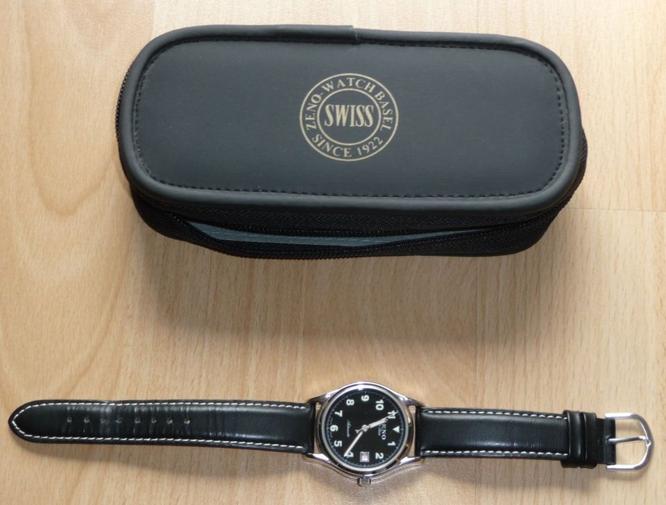

The seller, first owner, claims that he bought this watch, by Zeno, from new with 1-year warranty, about 16 years ago. Worn it only a few times and the watch has never been serviced.
Intrigued by the arrow-shaped seconds-hand, the red numbers on the date-disk and it's size of 35mm, I bought the watch. The older 1960's versions of the Russian Komandiskie do also have an arrow-shaped seconds hand, a red numbered date-disk and are 35mm in size.
Would this Zeno watch be inspired by the old 1960's Komandiskie's?
It gets even more weird as this, allegedly after 2000 produced watch, has a 1970's 21-jewels ETA 2783 (21,600 BPH) movement. It has this movement by design, it's clearly written on the display case-back!
So far, I haven't found any information about this watch on the internet, Zeno ref: 12783. Zeno "De Luxe, Automatic".
So, what is it? A retro-design complete with a retro 1970's movement? Is it a ladies watch or, with 35mm, a common 1970's Gents size? Perhaps, even though that the seller bought it 16-years ago from Zeno, new, with full warranty, is it a 1970's NOS??
Than there is perhaps another weird thing. I do have two NOS 25-jewels ETA2783 movements in my drawer. They both do have the usual 3-spokes balance wheel, but this 21-jewels ETA2783 balance wheel is different. Is this a standard balance-wheel for the 21-jewels 2783 or would it be a ("fancy") Zeno modification ?
Is there somebody among us who can enlighten me please ?
I'm very puzzled šŸ¤”

The seller claims that he bought the watch about 16 years ago, 2023 - 16 = about 2007 ...... not sure if his watch, in that price-range, included the girl šŸ˜†

Yes, I have no doubt whatsoever that this movement is a genuine ETA2783. It looks and works identical as the two 25-jewels ETA2783's I have. The only difference is, apart from the 21 jewels, that this movement has the Kif-Ultraflex shocks & Incaflex balance wheel. That won't be an alteration done by somebody on a Sunday morning in his garden shed. This is professionally done.
Next to that, the painting on the dial is done to a very high level. The gloss finish and the printing are both exquisite and the lume is applied flawlessly.
I had contact with the seller again and the story changes slightly, insofar that he bought the watch (new) of eBay and not in a jewellery shop. That makes the origin of this watch even more murky.
Ā
Edited by Endeavor
I found another very interesting piece of information. On a website called birthyearwatches.com I found an old advertised Zeno de Luxe watch, not identical to my watch, but if you read the text in the advertising, it becomes very interesting;Ā
https://www.birthyearwatches.com/product/1990-zeno-de-luxe-pilots-watch/
The housing of the advertised watch measures: 37.5mm with crown, 35mm excl.crown, 43.4mm from lug-to-lug and 18mm between the lugs.
These are the exact same measurement as the case of my watch, it's an identical case apart from the back.
Next to that, in the add it is stated that Zeno did buy older NOS movements and put them in modern housings .......
Perhaps Zeno did modified the ETA2783 with the Kif-Ultraflex shocks & Incaflex balance wheel?
As said, the modification is professionally done and Zeno would certainly be capable of doing so .....
