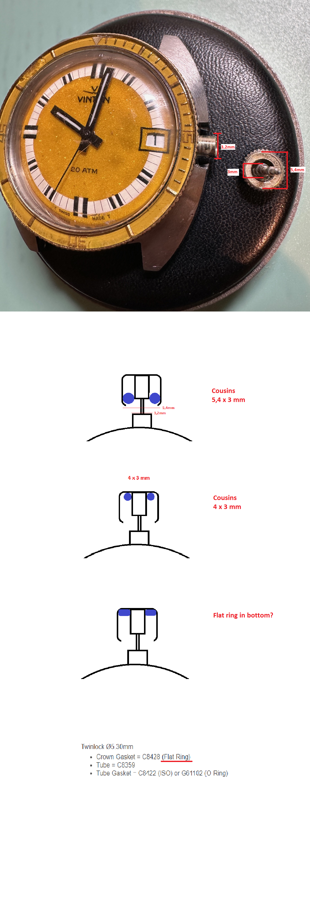

Hi!
Back with some crown gasket questions.
This time on a screw down crown on a 60-70s "diver".
This time there actually was a gasket inside the crown, different from all the "dress" vintages I have serviced.
I however had to scrape it out from what seemed to be a groove right on the "top" of the gasket, clesest to the case.
When measuring for a new gasket I gound that the "bushing" closing of the crown is 5,4mm and the crown/case tube is 3,2mm.
I my mind I should have a gasket that fits these measurement as the gasket needs to slide over the crown tube.
However the biggest micro O-ring I can find at Cousins is measured at 5,4 x 3mm. Slighty smaller inner dm than the case tube.
This lead me to rethink how to measure for crown gaskets.
Esslinger just says that crowns with internal gasket should be changed to a new one. But I have seen on Youtube how a new gaskets been fitted. (Mainly on Rolex watches - and I do realize they have their own specialzed measurements and might be easier to find)
So please see the picture below - how should I go about this?
Option 1 - buy the 5,4x3mm gasket.
This is the correct way since the gasket will be "forced" over the tuve for a thight fit?
Option 2 - buy a slightly smaller crown that sits "loose" within the crown but is then force pressed ON the tube when screwed in.
Option 3 - buy a flat gasket?
In Cousins description of Micro O-rings there is a reference to Rolex twinlock system - see in the picture below.
The crown gasket is referenced as a FLAT gasket.
This led me to believe I was wrong to think there should be a o-ring gasket even?
