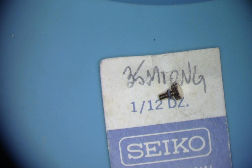

Not sure how much more I can tell you
 6119 8080. Seiko crown for this case is 35M1OA1. Generic J35M1OY.  Stem is 357611  (part no. from the Seiko pdf.).
Crown is thread is too small for the stem thread.
Photograph attached
The crown is the new one. The piece next to the stem is the broken crown (head sheared off). As can bee seen the stem thresd is much greater than the new crown thread. Sorry its a poor photograph.
Photograph attached
The stem for this model  is 354615 .
