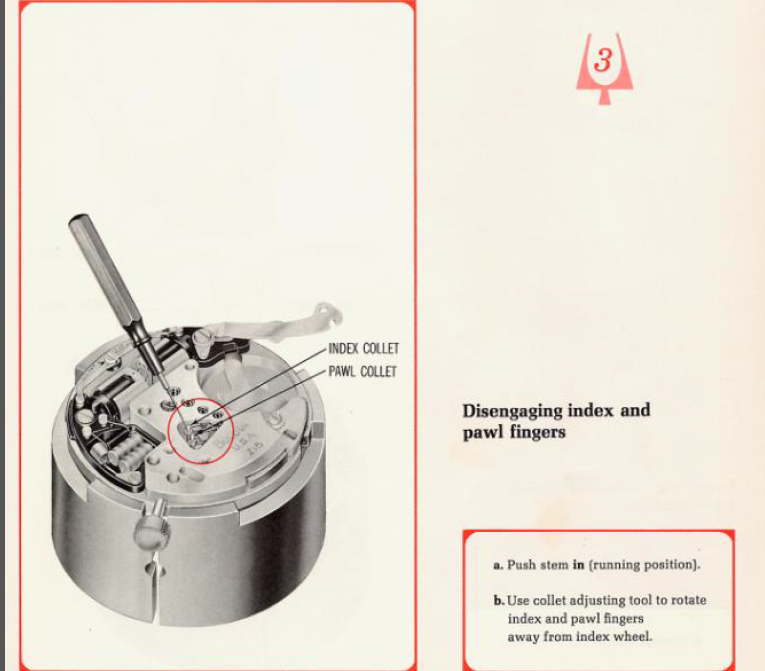

I have started studying the Accutron tech manual for the 218 movements...there's a lot of ground to cover .  I have a movement that  I just received and the fork hums ,but the gears do not continuously spin when I push in the crown to the run position . The index wheel does start but stops every time I pull the crown out and back in . I checked the troubleshooting section and it states that the index wheel may be dirty .
 But , I played very sightly with positioning the crown and there's a place where the gears all turn as normal . that position is neither in or out of the setting or run positions . I also read that there is a hack adjustment on page 20 .
SO , I think that I need to either adjust the hack , or [God I hope not ,...not yet anyway ] , replace the hack .  I am also thinking that the pilot part of the stem that engages the hack may be worn ...or too long . I do have a couple of new accutron stems coming my way and hope that they are for the 218's .

Try adjusting the pawl bridge I think that will start your watch, also make sure the index pawl is set as well. Set the index pawl gap first then adjust the pawl bridge. This is what I normally do to keep it running.

I haven't checked the manual yet , but  is adjusting the pawl bridge procedure in there . I know I read about tweeking the pawl finger post to adjust hacking ,...is that what you mean by adjust he index pawl gap ? 1/2 to 1 jewel width away from the index wheel with the crown pulled . I just bought some diabetic syringes and needles to do that . Also , do you use the accutron or a stereo microscope to do your adjustments ?
How do I adjust the pawl bridge ? ...A lot of questions I know ,.... But Thanks , Louis

The index pawl should have a gap like the manuel shows but the jewel should touch the index wheel and be centered on the wheel.  The crown pulled out the pawl finger should be 1/2 to 1 jewel away from the index wheel.  To adjust bend the post that is next to the pawl finger.  Once this is adjusted then the pawl plate has a cam shaped screw on the back of the plate, loosen the front screw just enough so you can move the plate with cam screw.  This moves the pawl finger on the index wheel.  to get watch running you have to adjust both the index and the pawl fingers.  If the gap onm the index finger is set then most likely all you have to move is the pawl finger.  I have a Accutron microscope but i hardly ever use it, I have a 10 power loupe that I use most of the time.  Hope this helps hard to explain on paper.  Let me know if you have more questions.

In your post you wrote , "To adjust bend the post that is next to the pawl finger.  Once this is adjusted then the pawl plate has a cam shaped screw on the back of the plate, loosen the front screw just enough so you can move the plate with cam screw.  This moves the pawl finger on the index wheel. "
This adjustment with the cam shaped screw on the pawl plate ,....is that adjusted with the train bridge plate , gears , and fingers all in place ....not stripped down I hope ? See attachment .
