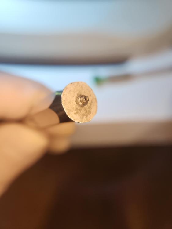

I had another go at using the "leaving the tail outside" method. I also used the original mainspring arbor held in a pin vise to wind the spring into a suitable size winder.
Initially, I just used the arbor directly in the pin vise to wind the spring but the spring winds unevenly and bulged out of the gap between the winder and pin vise.
Then I made a washer out of aluminium and put it between the arbor and the pin vise.
Then I hooked the spring on the winder and wound it like any normal winder handle.
This time I left a longer length of tail outside the winder, which made it easier to maneuver the T piece into the slot. The exercise was successful.
After I closed up the barrel, it suddenly dawned on me that the barrel cap could have used as the washer to prevent the mainspring from twisting in the winder.
The next time I come across a mainspring which doesn't fit any of the arbors of my winders, I can use this trick to wind it.
