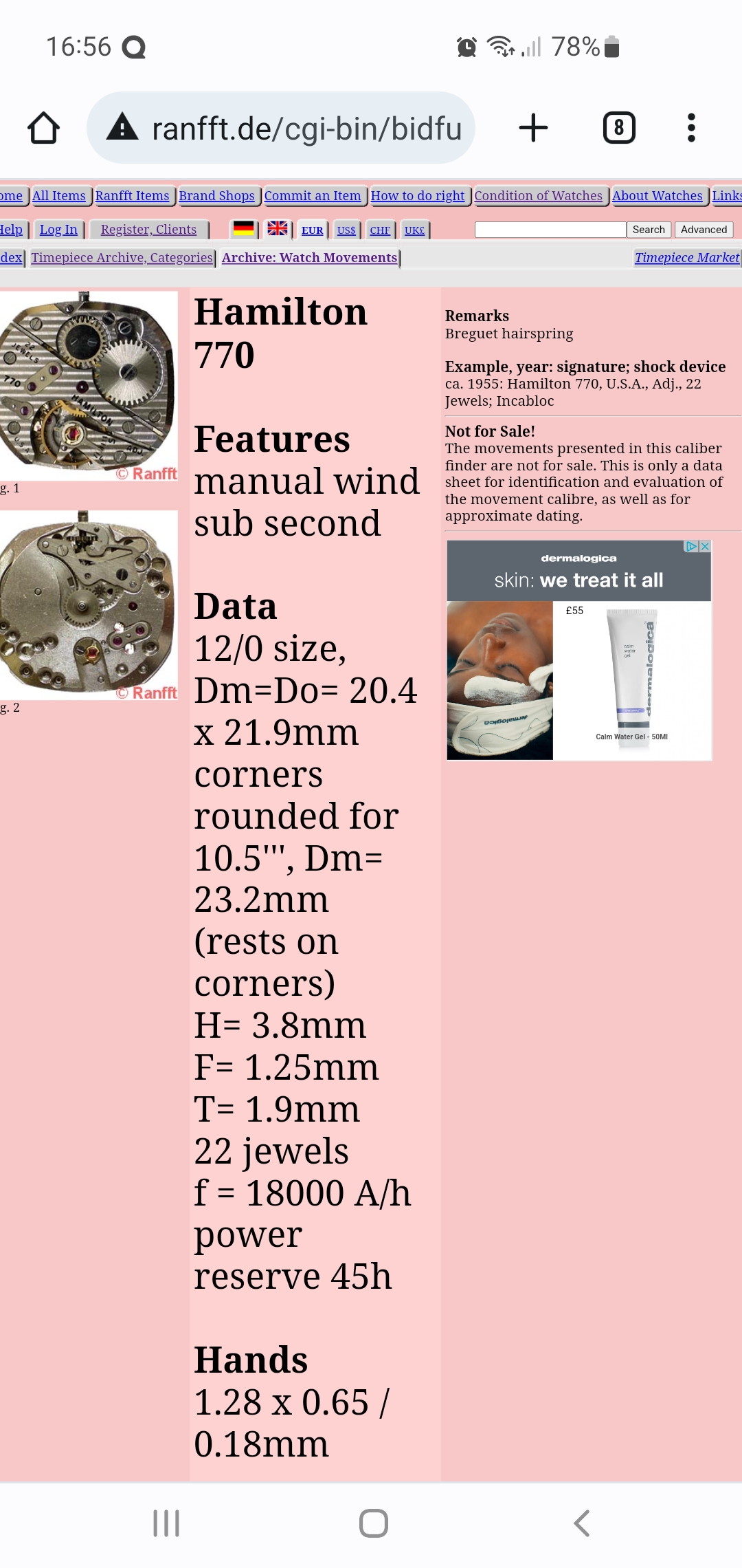

They are usually listed on Ranfft, but not in this case. Nothing listed in Bestfit, or on Cousins either.
You might just have to measure the existing spring - but it might be OK anyway. I used to replace most mainsprings, but now rarely do unless I really have to.
Sorry it doesn't give the mainspring information, I was just showing that the Hamilton 770 exists.  Unless anyone knows the spring size, you'll have to measure it.

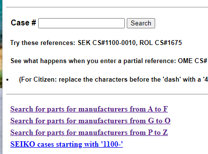

Great... another T end... how am I so lucky.  Well, I forget the amplitude that it was showing on the timegrapher, but I do recall it was low (sorry, don't have the actual numbers but will test before I start).  Maybe I will clean it all up and see what happens.
@mikepilkhow did you get that to come up?  For the life of me, I can't figure out the search feature on JB's site.  I go to the Parts Watch Database, but I can't get anything to ever come back.  I must not understand what it is looking for.
Thanks Mike... good thing those links didn't have teeth... I didn't even notice them there and was just trying to make that Case # box work.  Much easier to do it your way.
