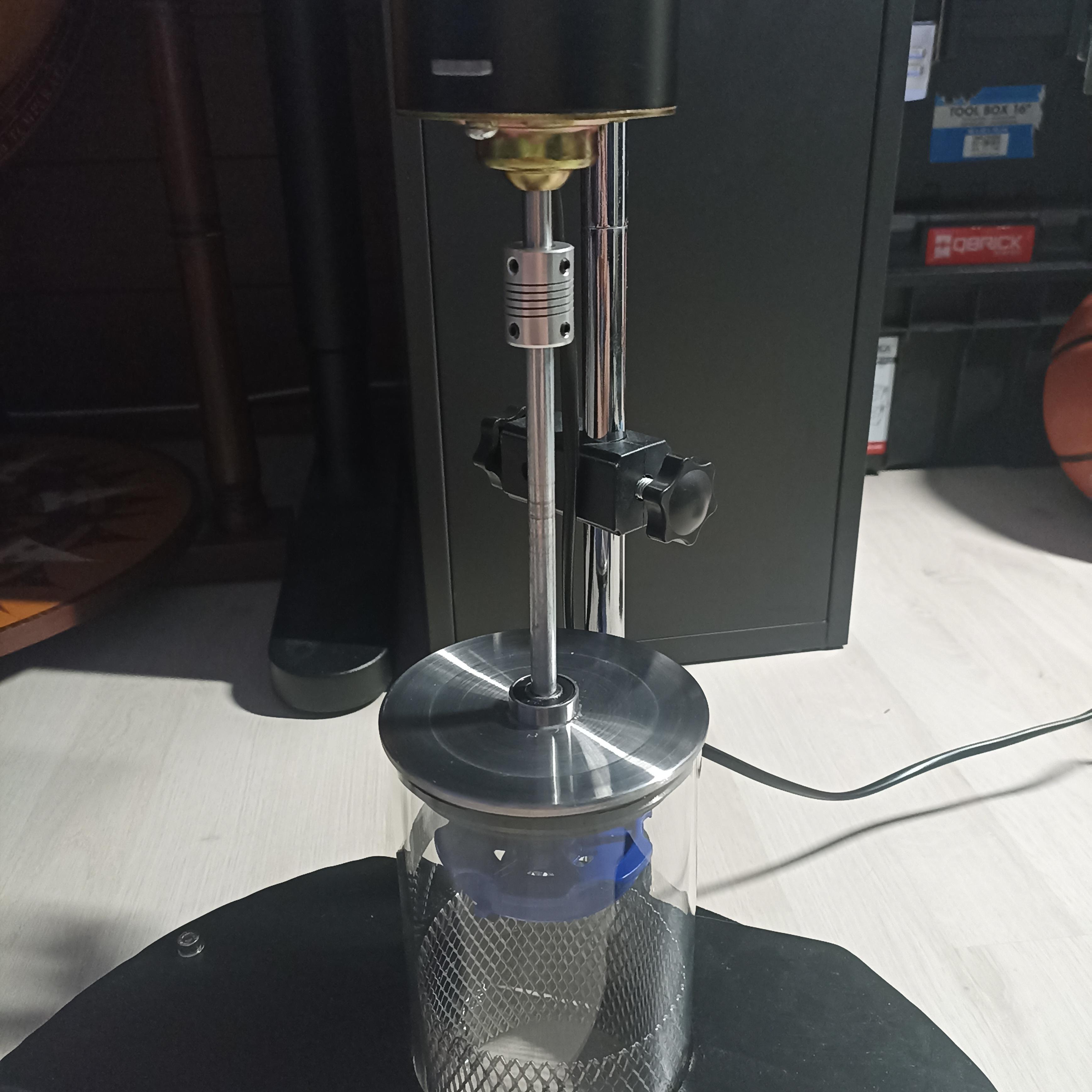

A little update. The shaft going straight through the lid was not very optimal construction so I glued a ball bearing to the lid. It gives stability and I also switched the shaft coupler to a flexible version. That way it doesn't really matter if the motor isn't perfectly aligned with the glass jar. Did some dry runs and now I can go really high rpm. I dared to go full rpm with the basket holder only. 2000 rpm that is allegedly. Maybe I'll next contemplate getting those square jars.
Congratulations You beat out the wimpy Swiss Elma cleaning machines. Looking at the tech sheet for the machines the maximum speed is either 1200 or 1400 depending upon the machine.
Of course there's no need to go past 900-1200 rpm that the pro machines use/recommend. I wonder if the potentiometer of my stirrer is linear, I could at least roughly estimate the % of max. I think my spinning speed hasn't been high enough before.
One of the amusements with the Swiss cleaning machines are  my understanding is only the extremely expensive vacuum assisted machine can you actually program the RPMs everything else is a knob and you don't actually know how fast it's going even though. Which is why the above chart becomes amusing because if most cleaning machines don't actually have an RPM how which set the RPMs anyway?

Square versus round one of those endless debate items? But while you're at it what about changing direction? In other words your spinning in one direction to fluids at some point time probably even with the way breakers will spin with the watch and then you stop suddenly the fluids will crash into your watch parts  aggressively cleaning even better than you spin the other direction.  Don't remember where I saw YouTube video one of the machines is going back and forth that seem to me to be very aggressively going back and forth another experiment for you to try
My current driver is one way only but some day in the future I'd like to build a new cleaner with a more rigid aluminum frame and programmable speed/direction, maybe Arduino based or something. Of course I could keep turning the knob back and forth to stop occasionally. I already do alternate the speed as I watch the basket spin.

That's a good question about damaging the parts. I've been thinking about it and you defikitely don't want to put heavy parts in the same compartment with wheels and pallet fork etc. Spinning is good when you have different cleaning/rinsing fluids so you don't get them mixed. Of course it's easier and faster too. And having toys is nice.
