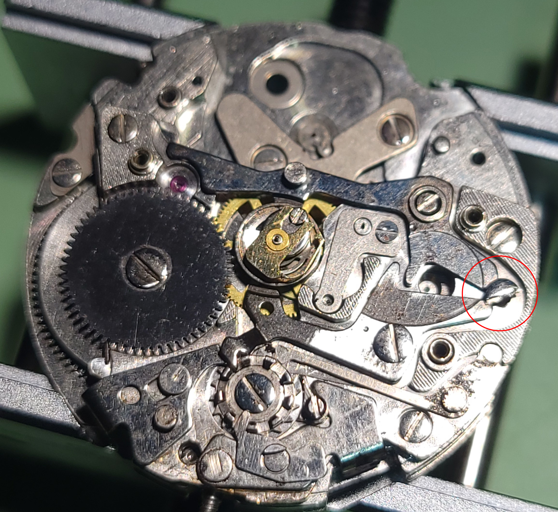

I also noticed that this spring for the chronograph start lever is around the wrong lug, badly misshapen, and the lever itself is badly gummed up and sticky. That would explain why it doesn't start, and should be an easy fix.
That is the hammer spring for the reset pusher, not the chrono start/stop pusher spring.  That is the correct location for that spring.  I've made the same mistake before.  It actually works when installed in either location shown in your arrows, but the post for the chronograph bridge is technically not where that spring is suppose to go.  That spring is badly misshapen as you stated, but it is currently installed in the correct orientation.
Interesting. I was using Mark's disassembly video as a reference, which shows it around the other post and I figured that would also explain why it was so misshapen:
And sorry for mis-naming it. I'm still learning all the bits and bobs in here! I also (embarrassingly) forgot that we're looking at the back of the movement and got the flyback and start buttons reversed in my head. 😳

I did this exact same thing on two watches, and both worked perfectly still.  A good friend of mine had a 6138-0040 Bullhead he purchased new in the 70's.  After it stopped running in the 90's he put it in a drawer and left it alone.  I was given the opportunity to do a service on that watch, which had never been opened prior, and can confirm that the spring was mounted not to the chrono bridge post, but to the column wheel lever post just below it in your picture.  In my (limited) experience, it appears to work in either location.  The manual is vague about this, as their graphic doesn't label that post, but judging by the closeness to the edge of the main plate, it looks like the column wheel lever post:
I made this same mistake on two of my YouTube videos, and a couple of people kindly pointed it out as well.  Here's a quick video showing me correcting this spring (although again it still works perfectly in either location - with a good spring):

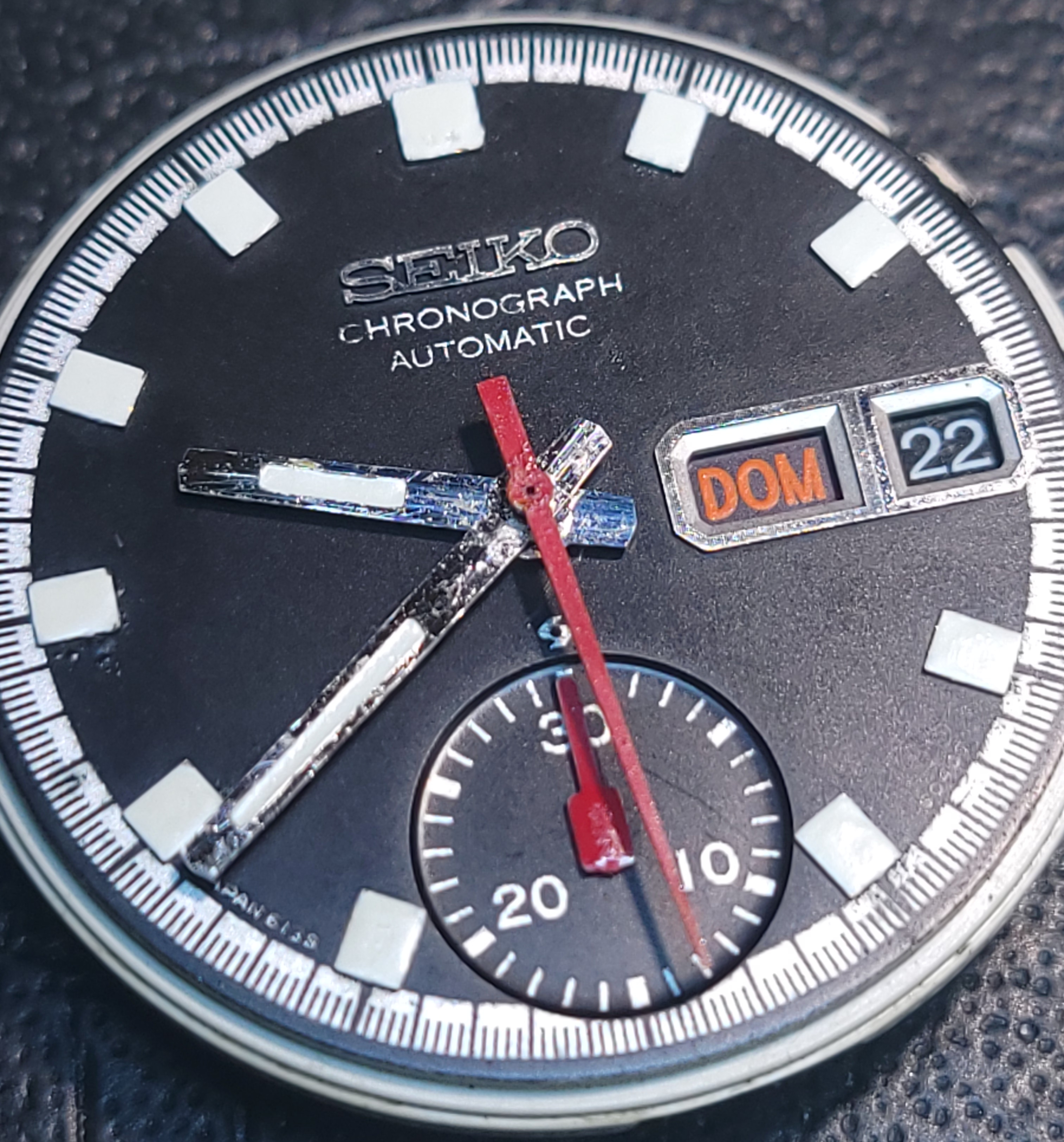

The second and chrono minute hands have been really poorly painted red, and I'm fairly certain the dial is a refinish. The price I paid kind of reflects that, so I'm not too upset about it. I'm not looking for a perfect collector's piece anyway.
It'll give me an opportunity to try my hand at refinishing hands.
