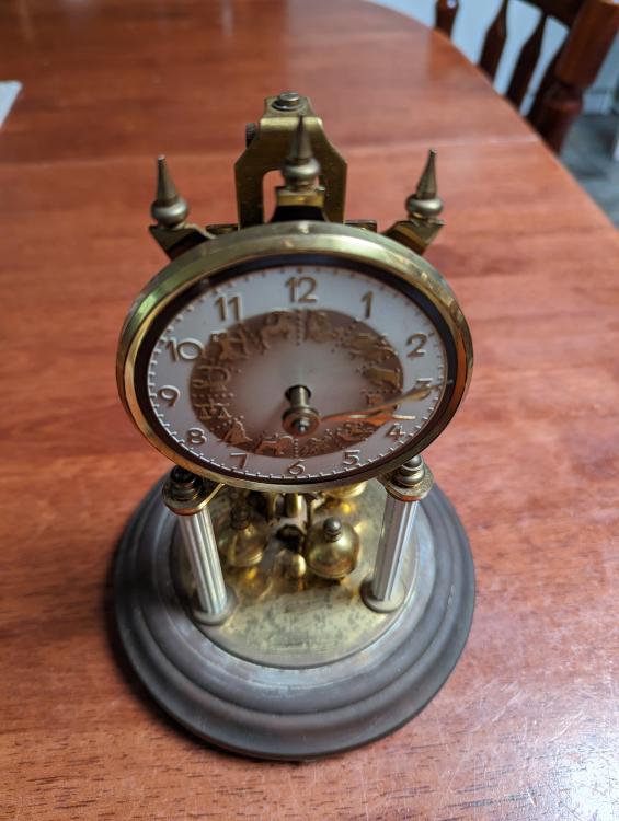

Found this German made clock in a thrift shop.
I paid $25AUD for it.
the spring that holds up the pendulum needs to be replaced I think and probably a good clean and lube. Other than that, it looks in good condition.

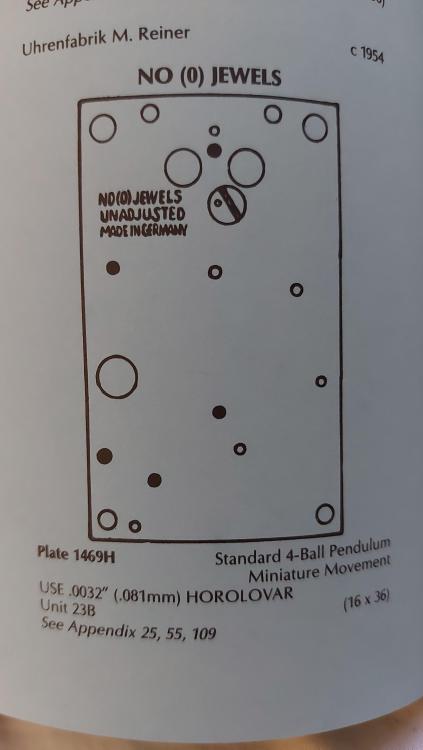

From what i can find it looks like it's made buy Uhrenfabrik M.Reiner c 1954, but there two both look the same but use different size springs one is plate 1469H, spring size .0032" (.081mm) 23B, the other Plate 1457 spring size .0028" (.071mm) 28C see photo's hope that helps,
