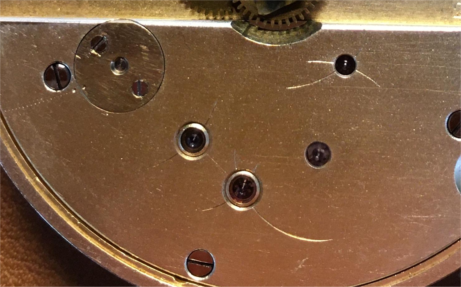

Here is the main-plate. No banking-pins. The two screws are for the pallet fork bridge, which has no banking either.

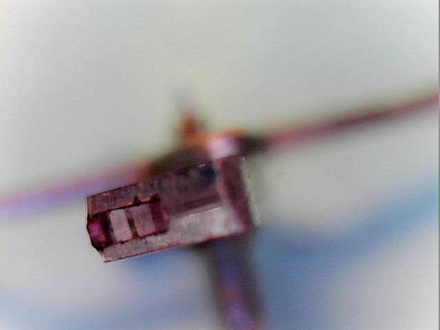

There are jewels in the pallet, but the slots for the jewels are cut horizontally, instead of vertically;
Side-view;
No idea out of which material these jewels are made of !?

4) As for further clues and numbers, these numbers were on the main-plate, hidden underneath the porcelain dial;

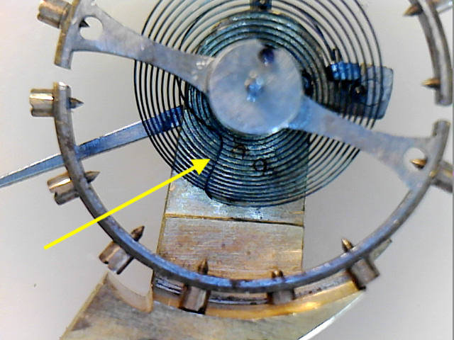

The Breguet hairspring has also an interesting bend from the outer-coil inwards (note the temperature compensated balance wheel);

I would say the glass is the original one, imperfections were common back then. The pallets are what I would expect to find however someone has heated them that is why they are looking blue and I have noticed a slight bend in the pallet, for my eyes it is a bad photo of the pallet stones so I can't comment on them, but repairs have been carried out because the pallets should not be blued. The barrel is something you will not have come across and it will be a puzzle. You need to remove the mainspring, put the key on the arbor and with a pair of smooth jaw pliers hold the outside of the arbor and unscrew it, when unscrewed you can remove it from the plate. I see the Geneva stop work is missing, many are missing.  The watch would have been made near the French Swiss border, date around the 1860 could be a little later. Made in there thousands, but parts are very rarely interchangeable. I have repaired pocket watches with the same style pallets with banking pins so I'm not sure if the style has anything do do with not having banking pins, if I had to guess I would say no.

Thank you very much for your answer 😉 I'm afraid the blue comes from the USB-microscope led lights, they are blue. I don't have a decent camera on my 7x-45x microscope and the iPhone just doesn't cut it.
The fork is normal metal color.

oh and before we get any further on this this was not a mass-produced watch made in a factory basically this is a classic Swiss cottage industry watch everything was made in separate cottages at some point in time it came together somebody purchased the wheels and typically under the dial and I enhanced your image a little bit notice the scribe marks somebody hand laid out each of the wheels in this watch. This is where when people are asking about these type of watches I want to identify it to purchase spare parts which unfortunately are not available because everything was basically handmade for this watch to a certain degree or definitely hand if it would be a better description

classically on a lot of vintage watches and even quite a bit later the pallet jewels are found exactly as you half. So they're not visible where you normally think they are but they are there. Then all of the jewels in the watch are going to be natural this was before synthetic are typically the garnet or possibly synthetic sapphire in some English watches their quartz crystal. Then there usually really nice and take a look really pretty.
