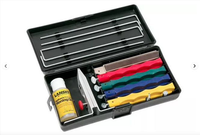

I've been contemplating a design, but never got any further than that , which is based upon a Lansky knife sharpening system, which I own for keeping our kitchen knives (razor) sharp.
It's basically a clamp which clamps onto the back of your knife. Both "legs" of the clamp (on either side of the knife) do have equal degrees holes which allows you to sharpen the knife-edge, on either side, to a desired angle. Different grits grinding stone can be attached to a rod, and the smooth rod slides in the clamp-hole and the grinding-stone rest on the knife's edge, assuring a constant angle. There is a commercial (bla-bla-bla) video on Lansky's website: https://ad.knivesandtools.eu/en/pt/-lansky-professional-sharpening-system.htm
so you get the drift of the system. For knives this system work excellent.
The whole idea is to keep the grinding stone at a constant angle to the to be grounded surface.

This still leaves the centering and fixating of the housing 🤔 Also, my idea is an inconclusive expansion on what I already have, namely the Lansky grinding stones. But even the coarsest grinding stone in my set, is too fine and too wide for a sunburst. It has to be a needle-file, but with a smooth end so you don't wear out the hole in the center-post.

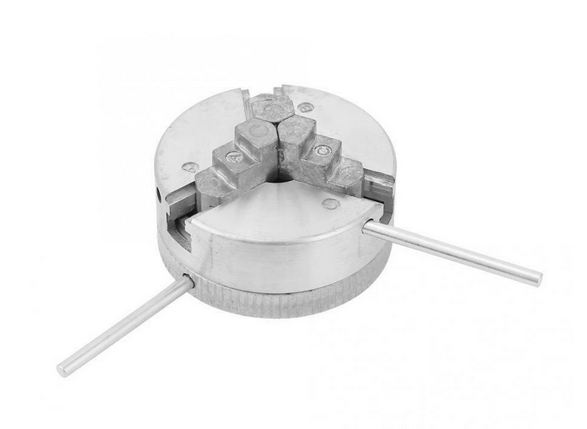

EDIT; what if when you clamp the housing from the inside ?? Kinda a head of a lathe? With a 3-claw lath-head you can clamp on object inside the claws, or you can clamp a hollow object with the outside of the clamps. Of course, in a lathe head, all 3-claws are moving simultaneously, ensuring centrality.

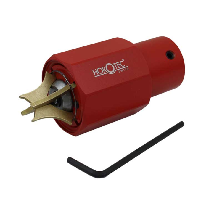

But as you state, we still have the issue of securing the watch case, I was looking at the polishing case holders (somehow) mounted vertically:
However, there are 3 issues with this; the first is that we are in huge violation of the K.I.S.S. principal of engineering and the second is that they are CRAZY expensive ($300+) and finally, they would only work on round watch cases.... hopefully there are some other brains looking at this who will come up with the "how come I didn't think of that" solution 🙂

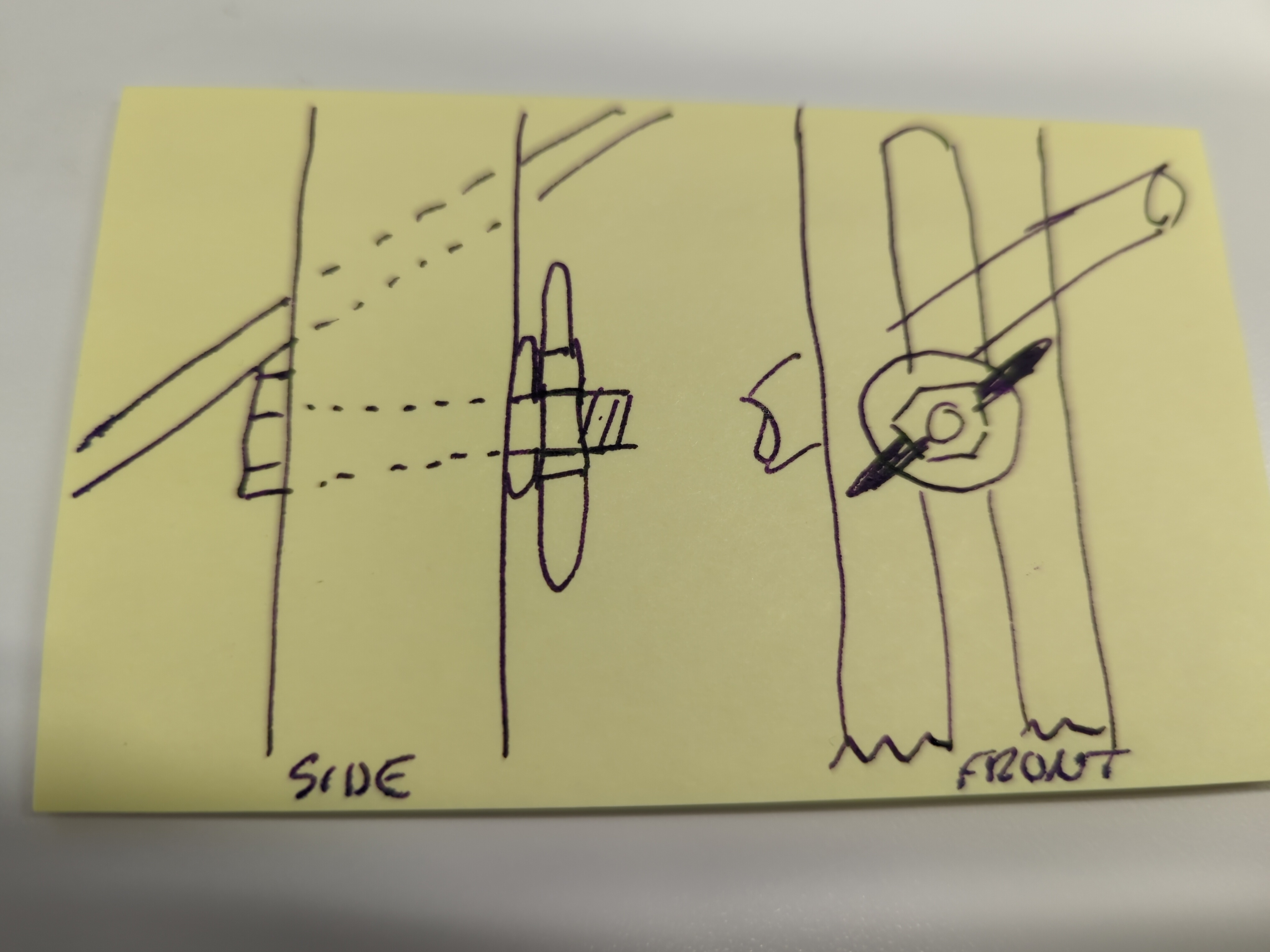

Here is my bad drawing of the bolt angle system, who needs CAD ha ha 🤣
Edited by Waggy
Yes, the wing-nut is a good idea, seamlessly adjustable, simple & idiot proof.
The Horrortec idea is good, but way too expensive. We need something far more KISS.

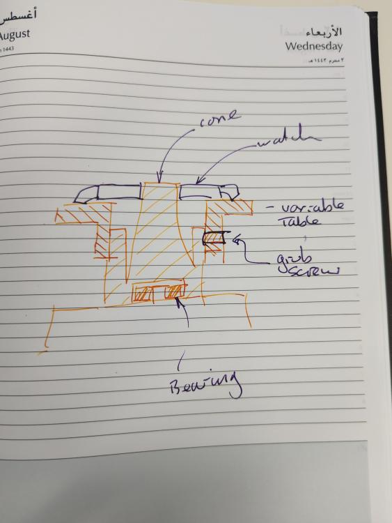

OK here we go..... how about if we take inspiration from the tool below and combine it with our current design:
to give you:
so cone centers the watch, but you can slide the table up and down to support it and keep it level
Edited by Waggy
I still see some of the same problems as we had before. The size of the cone-tip is limited to a few internal diameter sizes. Assuming that when loosening the grub screw, the variable table can be lowered to centralize the watch-case. In that case the cone starts to stick higher up, possibly interfering with the file.
Also, I question the idea of using a bearing. It all adds to the play and "wobbliness" of the rotating table. If the rotating table would just rest on the base (jig), being centralized by a tight tollerance pivot, it shouldn't be that hard to turn the table (friction between plastic-and-plastic?). I my mind there is no need for a smooth, free spinning table. The "sunbursting" is a slow process, turning the watch-case each time in small increments. The table has to be hold stationary with each file stroke. The more stable the table, the better. I think it is way more important to minimize the play in axial and radial direction.
We also have to bear in mind, that in our current "paper-design", the diameter of the rotating table may be much small than with your initial design. What the diameter of the rotating table will be, is determined by the diameter of the watch-casing, the height of it and under which angle the file has to operate. The smaller the diameter of the rotating table, the more wobbly it may get. IMHO, leaving the bearing out simplifies the design, safes cost and reduces the overall play.
Another question which one could ask is; has this tool to be universally designed for any watch-case (shape & size) you may possibly ever encounter (men and ladies watches) or stick to a certain range of watch cases, say men's watches with a round internal? Which group would benefit the most of such a sunburst-tool? The question deviates from our current design questions / idea's, but then again it has everything to do with it.
Needles to say, an universal "can-do-it-all" tool is way harder to design than a tool for a specific range of watch cases.
