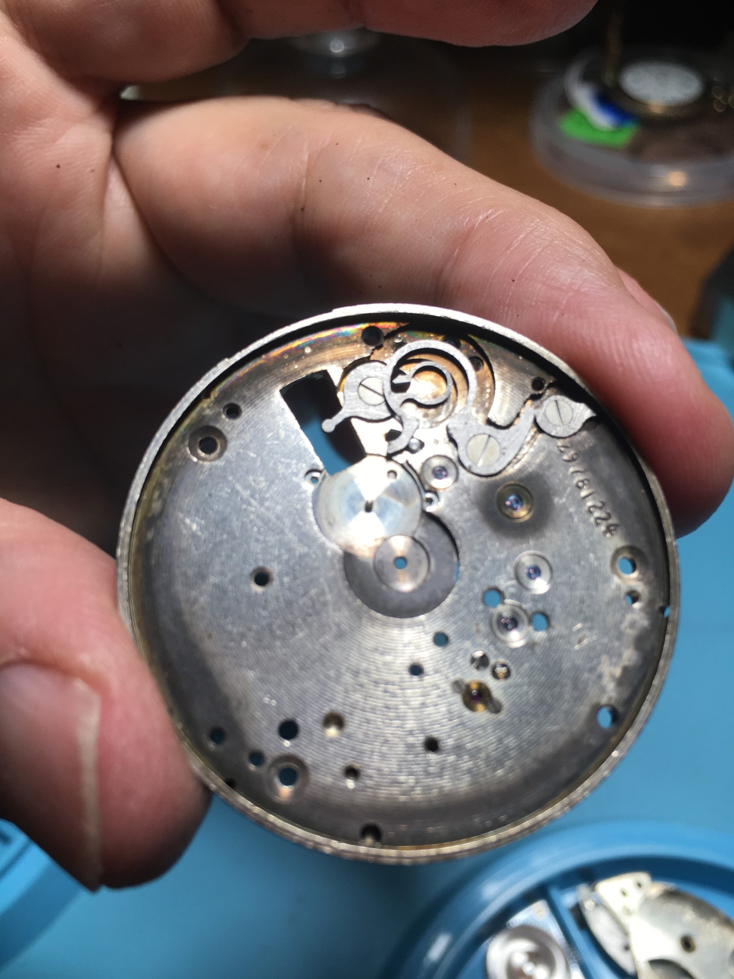

Good morning,
I'm working on an elgin PW 15 j, size 16.  I've run it through my watch cleaning machine with Zenith cleaner (no ammonia) and also in naptha in my US.  Still, the tarnish/staining will not come off.  I tried scraping with pegwood without good results.    Is there something else i should try?  Machine buffing?  Ammonia?  Vinegar?  Any ideas appreciated.  Thank you.  Arron.

It looks like the movement may have been left in a cleaner for too long in its life. Either that, or perhaps a cleaner that was too caustic? However, if it is tarnish rather than loss of plating, you might try rubbing the dark areas with Rodico. I had black discoloration on a Swiss pocket watch movement with a gilt finish, and the Rodico removed it with a bit of elbow grease. Good luck.
I have to admit that when i read your reply i was skeptical, to say the least, that a piece of putty could remove what two machines and harsh chemicals could not.  But, alas, it did work.  I went ahead and tried a pink pencil eraser and that worked too.  Go figure.  It's not bright and shiny but it did remove the tarnish.  Thanks for that great idea.

I noticing you using a cleaning product without ammonia. Ammonia is an interesting substance and watch cleaning. A short time in the ultrasonic with ammonia and everything comes out bright and shiny. It's the ammonia that removes the tarnish so if you had a ammonia-based cleaner that would probably be bright and shiny. But if left too long in the cleaner with ammonia it goes from bright and shiny to etching basically. This solution will turn a pretty blue color and the copper in the brass will be gone and things will be frosty. then as you leave it a very long time basically an unacceptably long time and then you'll start to see some really bad effects apparently. No matter what that's an interesting work on your plates.

then a pinky eraser is actually a abrasive device not as abrasive as sandpaper but still it's abrasive. That's why you're finding a clean but not bright and shiny because of its abrasive properties.
then there's an alternative. I would have posted this sooner but I couldn't quite remember what it was called and trying to figure out by searching alternative names reveals well doesn't reveal this. So you looking for an ionic cleaner this seems be the most common one I see there's other videos on YouTube but you can get the idea from this video. so basing that just works really nice on tarnish. Here watch plates or somebody once their case to look nice but doesn't want a polished it works fine.
For this kind of tarnish on nickel plated and gold plated movement (or any kind), I learned long ago to use blanc d'Espagne, also known as blanc de Moudon, or in English sometimes White of Spain, or just whiting powder. It's super finely ground calcium carbonate, and is used for all kinds of stuff like making gesso, or whitewashing windows and so forth- and is the main ingredient in most chalk*. Available here from drugstores/ art supply/ hardware stores. Should be fairly easy to find about anywhere.
To clean up plates and bridges, take a pinch and rub it wet (with water) all over the stained area. It won't leave scratches or mess up the original finish, but does a great job of getting those stains off.
*French chalk is magnesium silicate. Very old watchmaking books mention it often, and many old benches had a cubby hole right in the front for a block of chalk, which you were to rub a long bristle brush over, then brush down the plates and bridges. I think the idea was to brighten things up. So, while I haven't tried it, you might try French chalk as well. It's what talcum powder is made from, so that's an easy source of powder form.

just to clarify I assume you mean ammonia in a watch cleaning product? As I know you can do by ammonia in various stores for general household cleaning for which I have zero experience on a watch with that. Then if you using an ammonia-based cleaner designed for watch repair somewhere in 4 to 5 minutes works fine anything longer and you have issues or can have issues. Plus do not elevate the temperature.
