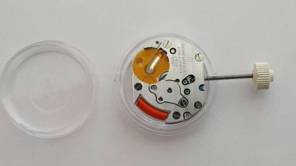

Here a picture of the 5057 and its indeed the same as LittleWatchShope found;
I found a few 5057 movements on eBay, second-hand, allegedly working, for a whopping €242 excluding postage. Being 2nd hand, they obviously need to be serviced too ..... but if I were to service the existing movement, and screw up, I know the starting cost.
Picture of the one offered on eBay;
Currently the watch seems to run still on time (no seconds hand, so it's a bit hard to judge).
But just in case, it would be nice to find the tech-info and/or the $20 look-alike replacement 😉

this is kinda what happened when I googled this morning it was like all of their watches use this model number? I didn't quite grasp what was going on.
then there is the other little problem. It looks familiar and that will be a problem. So when I went looking is hoping to well I would've preferred something else but still was hoping to find something and then I found this on eBay Baume&Mercier 5057 Ebel 057 Cartier 157. It was for stem and if the stem is the same are the watches the same? Oh and of course there's one more watch that goes in with all of that. Occasionally work whenever we working on one of the high-end quartz watches I noticed that there were three of them that seem to be similar not necessarily the same part number or movement number but there are similar. It's comes out handy because I bought a CD off of eBay from the other brand I'm attaching a file.
quick look again at the Internet and I'm finding the same thing. So you have your tech sheet.what's interesting with tech sheet is their lubrication choice? I typically like the quartz oil from the company that makes expensive oils but I've had really good luck with the expense of quartz oil so I'm happy with it and synthetic it should last forever. Don't know if your favorite German company makes anything of equivalents. But I do find a choice of oil interesting as it's a lot heavier than what I would think you'd want to have for quartz watch. At least are having to common sense of putting grease on everything else rather than ample lambing the whole thing and putting oil everywhere else.
Then you do get the technical specs it runs on almost no power and as long as the voltage is above 1.25 V it should run. Then if you continue farther into the document it should take you only 45 minutes the service this watch obviously not including time running it through the cleaning machine. It does tell how to clean the rotor but I try to keep that off for the pivots you want everything on this watch spotlessly clean and I always worry about that on the pivots.
So other than being astronomically expensive yet a nice detailed tech sheet it's a relatively simple movement to do and getting parts can be an interesting challenge but you have other model numbers that use the same components. Because they're all the same movement basically which is helpful when you're trying to find stuff

A quick glans through the tech-sheet, it doesn't seem to be a complicated movement. I do remember the rotor from the quartz movements I ever took apart, extremely magnetic and you don't want to have any metal debris around.
Time flies and my wife & I must have had a senior-moment. Checking the receipt, turns out that the watch was bought in 2002, and only the universe knows how long it has been laying in the shop? Suddenly we are now talking about an at least 20-years old movement without having had a service!
Perhaps that's what causes the watch to slow down. I don't have the fancy equipment to measure the currents, so I'm in the blind there. The battery has been changed out twice for a fresh one, my wife knows that. Now, I guess best thing to do is to let the watch run and if it is slow again, it's not the battery and a service may be the solution.
