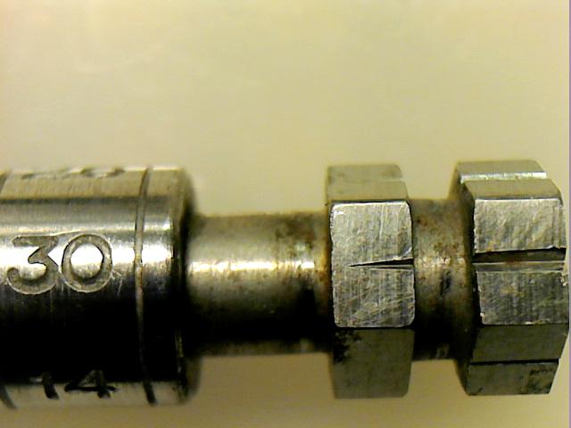

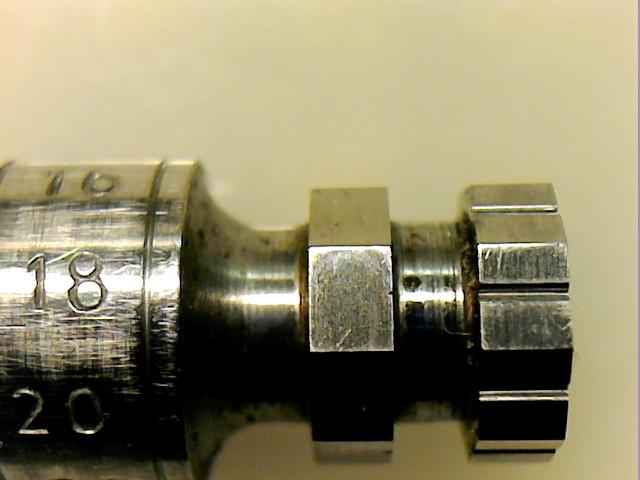

I finally got around to start learning the Jacot tool skills 🙂
Starting off, I was puzzled which runner to use, so I had to re-read your explanations.
Thereafter I thought it may be an idea to put a "face" to each type of runner bed to clarify your explanations.
On 6/3/2023 at 2:08 PM, nickelsilver said:
The different runners are for different sizes and types of pivots. In the above (and most sets), the runners with caps on one end are for smaller pivots, up perhaps 0.36mm. The caps cover the fragile lanterns, which allow working on the pivot ends. The short runner, with no lantern (#2 above) is for long pivots on 4th wheels that carry a second hand. They have longer beds and naturally make a tapered pivot. In the above set it looks like #3 could be an additional 4th wheel runner.
The runner with beds on both ends is for center wheels i.e. larger pivots. You would choose between headstock runner #7 or the one currently in the tool according to pivot size, usually one will do the normal range up to 0.30-40, the other up to the limit of the center wheel runner.
Runner #1 and runner #4; (the runners with the caps) for smaller pivots. Runner #1 has the sizes: 5/6/7/8/9/10/11/12/13 and runner #2 has the sizes: 14/16/18/20/22/24/26/28/30.
Runner #2; for the 4th wheels with tapered end;
Runner #3; (like runner #2) is indeed an additional 4th wheel runner for tapered pivots;
Runner #5; with beds on both sides, for the larger pivots, i.e center wheels. Covering the sizes: 32/34/36/4045/50/55/60 & 65 on one side and 70/75/80/85/90/95/100/110 &120 on the other side;
