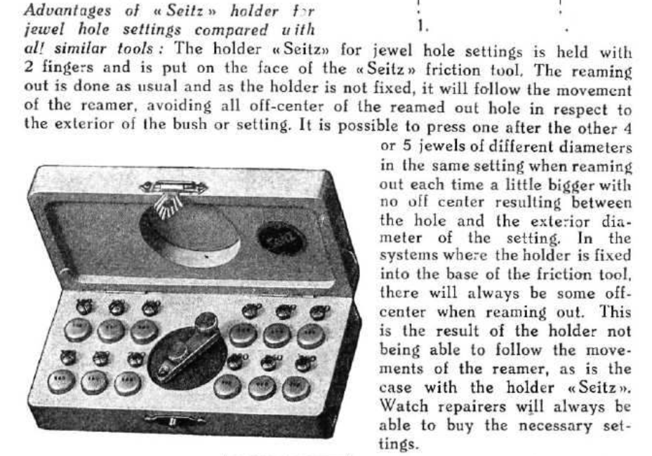

6 minutes ago, Endeavor said:
That's why I try to get to the source. Once the basic principle is understood, the rest is a logical consequence.
If the theory is correct, than Indeed, the amount of wobble will be the thickness of the shaving = amount of asymmetric.
The logical consequence would be that the to be reamed hole has to have the freedom to float by the amount of asymmetrically and can not be clamped fixed in relation to the reamer.
It's a bit difficult to explain in a non-native language, but I do hope that you get the drift of what I'm trying to explain 😉

4 hours ago, Endeavor said:
Thanks for that John, now the have the Seitz side of the story, which corresponds with what already has been said.
I was trying to get my head around as to the why the reamer creates the movement, does my theory above makes any sense?
Ah so the holder doesn't attach to the tool its just hand held and the movement from the reamer is just an effect of that design of reamer.

I think i understand now Endeavor. Because the reamer has only one cutting edge the hole is growing in size  asymmetrically around its circumference. So the backside of the reamer has to occupy an increasing asymmetrical space. The amount of cut thickness it takes equals the amount of wobble.
Perhaps we are talking the same? In my virtual brain picture the asymmetrically doesn't increase, it is constant but shifting its position during the rotation, provided you ream with the same downwards pressure, i.e. the thickness of the shaving stays constant. In fact, the asymmetrically decrease towards the cylindrical part of the reamer, where the reamer tapers off.  The "problem" with this type of reamer is that the back-side of the reamer (the non-cutting) leans against the borehole whereas the cutting side digs in, enlarging the hole. One could see it a bit as following an increasing spiral predominantly in the horizontal plane.
Correct. I do agree that there are nicer, perhaps better ways to enlarge a hole. Reaming with a one sided cutting action reamer seems crude, but, in the end of the day, if it works, it works.
I drool over Nickelsilvers machines, but those I may get in my next life 🙂
For now, and to me having solved the initial question, I can ream with these Seitz-reamers, when following the correct procedure, and be confident that I'll end up with a nice, in center and cylindrical hole.
Crude, cheap but effective.
I thank you all for your input ....... I think this was a thoroughly enjoyable and interesting discussion 👍

On 7/23/2024 at 9:34 PM, iiwii said:
I don't think reamers are tapered, I thought it was broaches that are tapered
Reamers in jewelling tools are tapered to open the hole up by 0.1 mm and ream the last bit, but ordinarily reamers aren't tapered, just the tiniest bit on the lead edge
So reamers in jeweling sets are tapered all the way?
Sorry got it now (from HS Walsh website)...
Seitz Jewelling Reamers.
The reamer has a tapered shank. The semi circular cutting portion is followed by a cylindrical portion, the diameter of which is a hundredth of a millimetre less than that of the jewel to be fitted. When reaming the hole, push the reamer as far as the cylindrical part.
Advantages:
Reamers with a single cutting portion make for regular reaming and accurate centring of the hole. The cylindrical portion insures that the hole is absolutely straight.
