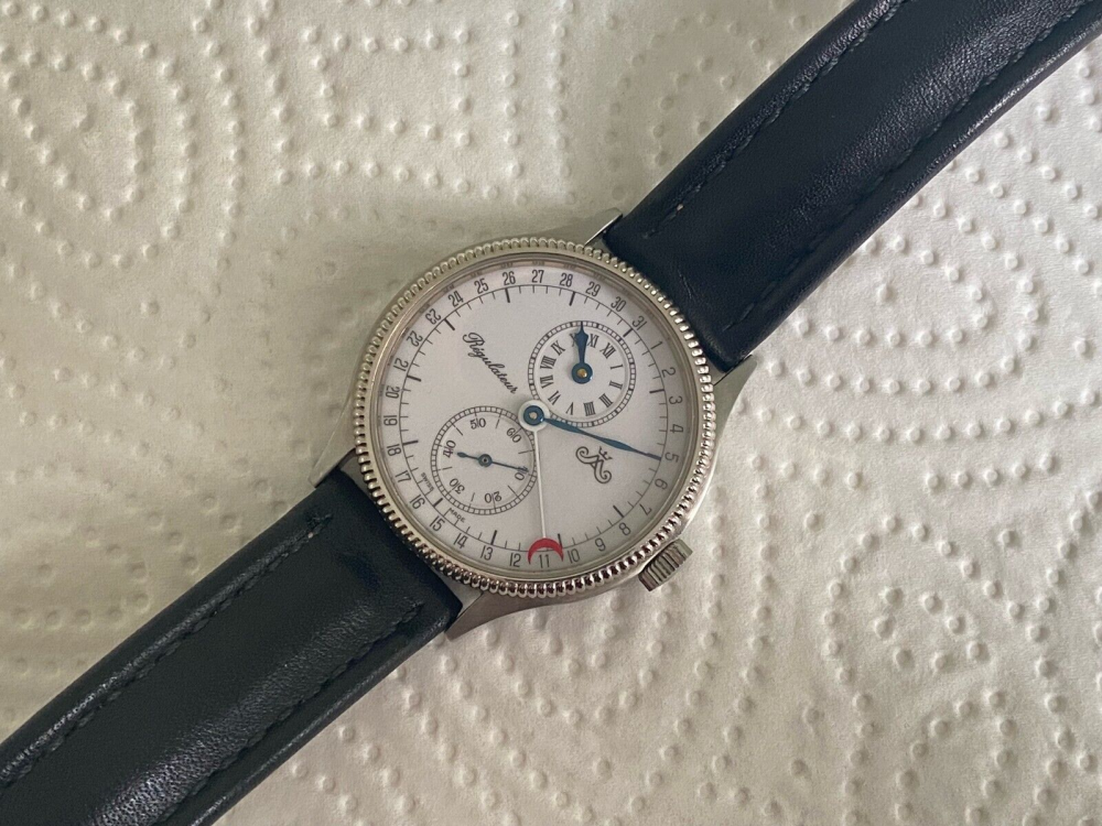

On 6/13/2023 at 10:27 AM, nickelsilver said:
Peseux movements are pretty fantastic across the board, and there is a "current" one available from ETA, the 7001
I just bought this on eBay. It's housing a Peseux cal. 7040 (or possibly 7046). It looks pretty with its côtes de genève. It's going to be interesting to see how it performs. As I understand it, this calibre is still being produced by ETA with a calibre number of 7001 (used by Nomos, for example). Again, thanks for the tip @nickelsilver!
