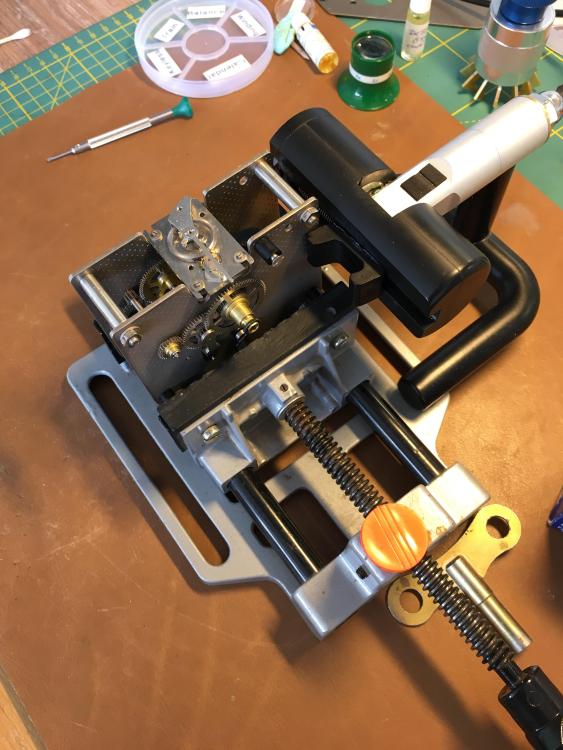

Here my setup with the clock movement and the timegrapher.
Here the amplitude with "minimum"-mainspring tension.
When winding the main-spring, close to 1/2 way of the Geneva-stop, the amplitude has increased already so much so that the escapement starts over-banking, the galloping sound and the nice lines on the timegrapher start to get interrupted and "snowy".
In an attempt to reduce the amplitude, I did put some heavy clock oil on the pallet-fork pivots, but no change. Since I was the first-in, I'm pretty sure that the main-spring is the original.
