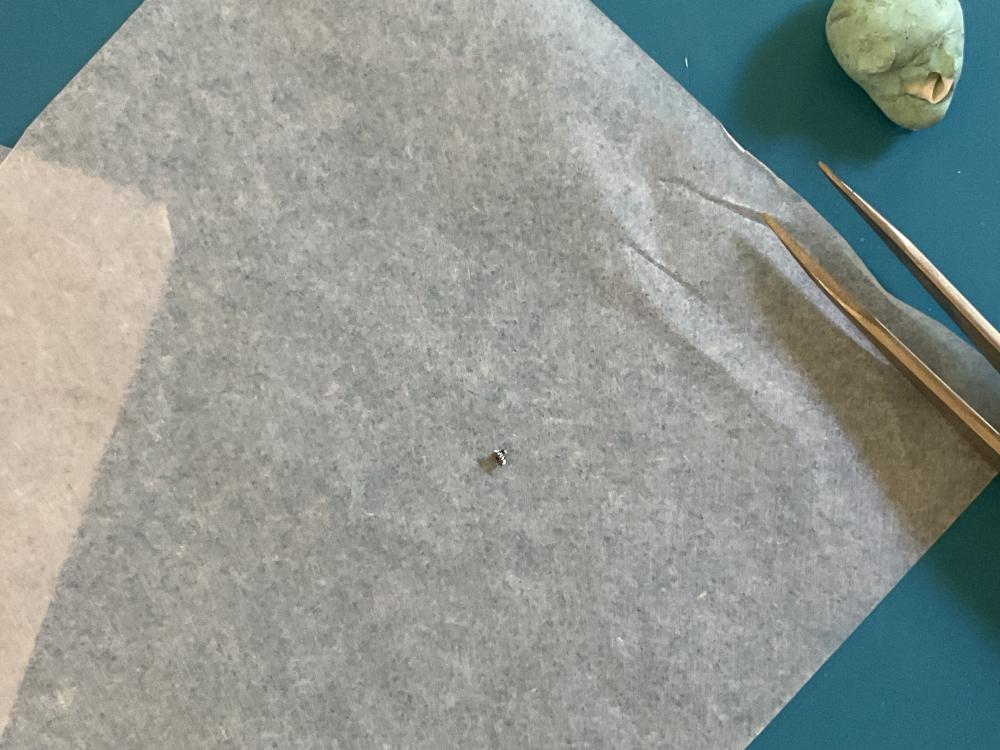

I bought a ancre watch from ebay. It worked but once again i had the problem hands didn't move or only once and a while.
Again it is not the usaul canion pinion that is responsible for the friction but the tiny part on the foto.
I couldn't  narrow the tube and broke the little part. So i'm searching for that little part ( Part number 240 pinion cannon pinion with clam notch)
Cousins has/had 3 different canon pinion with clam notch. It seems that this part was a problem part and FE modified the movement several times as a solution for this problem.
These are the pinions cousins can/could  offer ( one is discontinued)
96a543654b39de1cb288d6be546761ee3e174e52_2_690x252.jpeg.1053f7bcedd87e9d52a585162515ed3f.jpeg
I supose the first one for the 140C is not the correct one( Height 1.05, 0,55 mm Diameter) i measured the height and the Height is more than 1,05 MM rather arround 1.09 mm.
So i hope the second one still in stock is the right one( Height 1.09 mm , 0,40 Diameter). i'm not able to measure the inner diameter.
Or was the right one the one that is discontinued ( Height 1.09 MM , o?45 mm Diameter?
Who can sort me out on this one?
