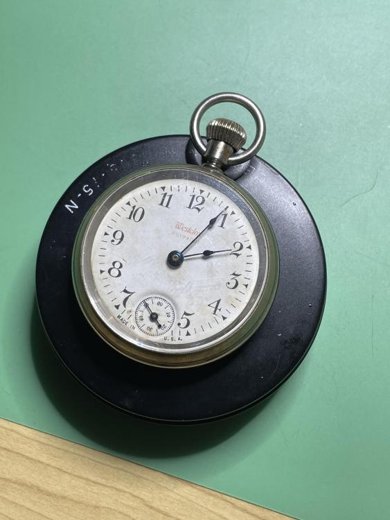

I bought a Westclox Boyproof Pin Pallet pocket watch a few months ago and found that the mainspring barrel was split.  I managed to find another donor watch in which the barrel is good (also had no mainspring).. One of the shafts on one of the gears had moved too so it donated one of those as well.  It's been sitting around because I can't figure out how to wind the mainspring into the barrel.  The barrel arbor is integrated into the lid on the barrel and using that to do it by hand is nigh on impossible.  Similarly hooking the end of the spring on the barrel and winding inwards is equally tricky.  Is there another way without acquiring a large mainspring winder, or is one of those options the only way?
I have attached a photo.

The brass section is the arbor/lid combined.  I have tried winding it onto that but the tension is too much to hold by hand, especially when attempting to insert into the barrel.  There is a hook on the wall of the barrel as well which is a better option but still tricky and did mis-shape the bridle end of the spring and i'm super-cautious of not damaging it given I don't have a spare.

Just a little update on winding the Westclox mainspring.  I machined up a barrel winder with a lead-in slot (didn't start out that way).... and I also had to use a pusher as well.  It was still a bit of a pain as you have to line up the hook (bridle end for it to seat in properly.  Anyway, done done and thanks for the tip!  Pics attached.
Now to rebuild the pocket watch!
Hi that’s a neat solution, what you have constructed is excellent and will probably used again. Very much like a standard watch spring winder only more robust, cost   Time and brain power. Plus lathe .  Great job.
