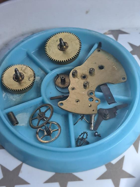

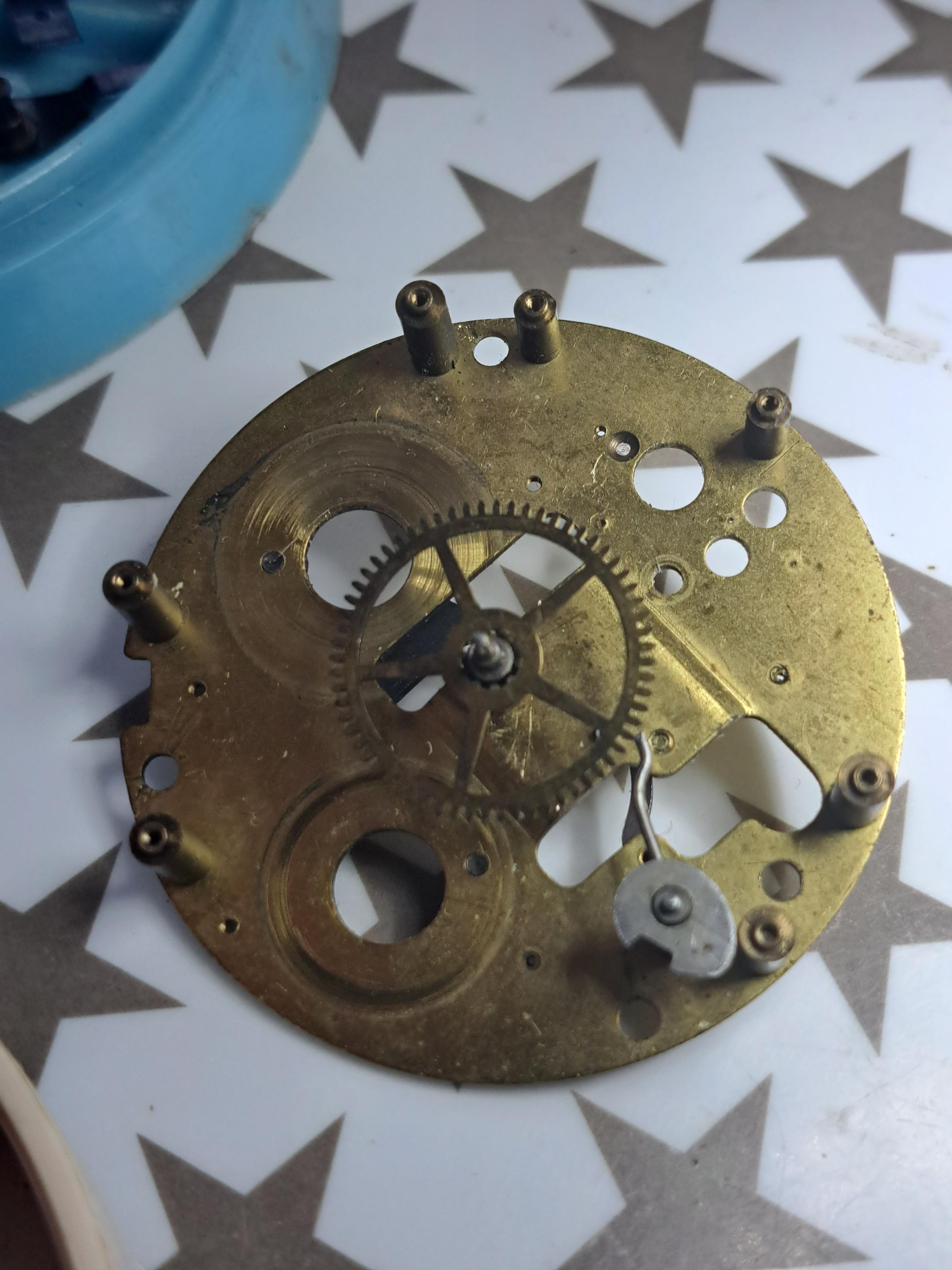

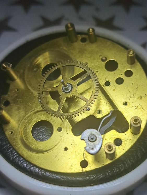

Hey got it all apart how do these bits come off

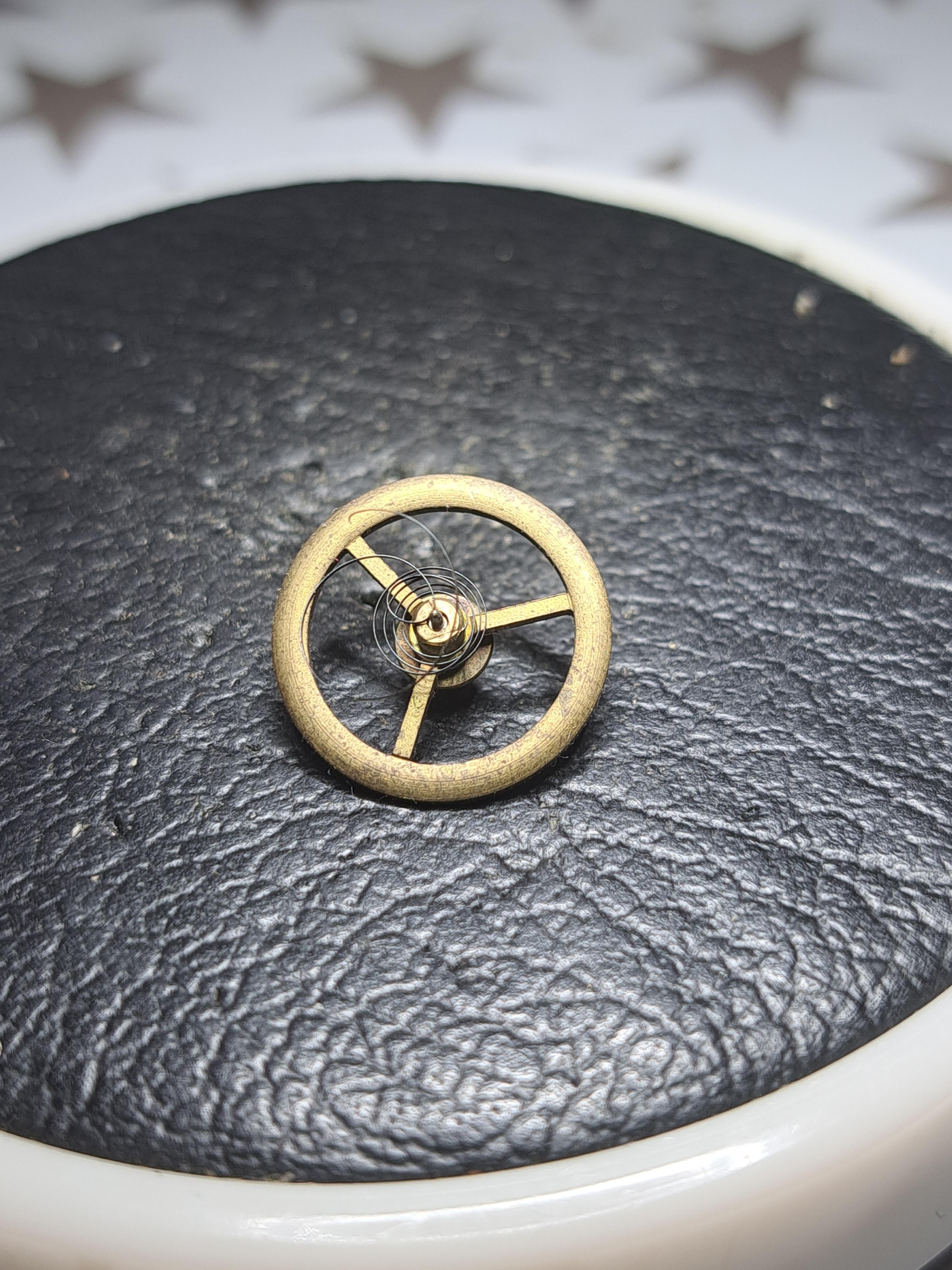

Hey some more pics of balance and all the parts i now I have took pics while taking it apart. Just wandering is it worth cleaning
You don't need to take those parts off. The hairspring looks worse then it is. Have you done any hairspring work? First you need to unravel it, Use a pin or a fine oilier, start near the collet and work out. Then take a photo so I can see it.
