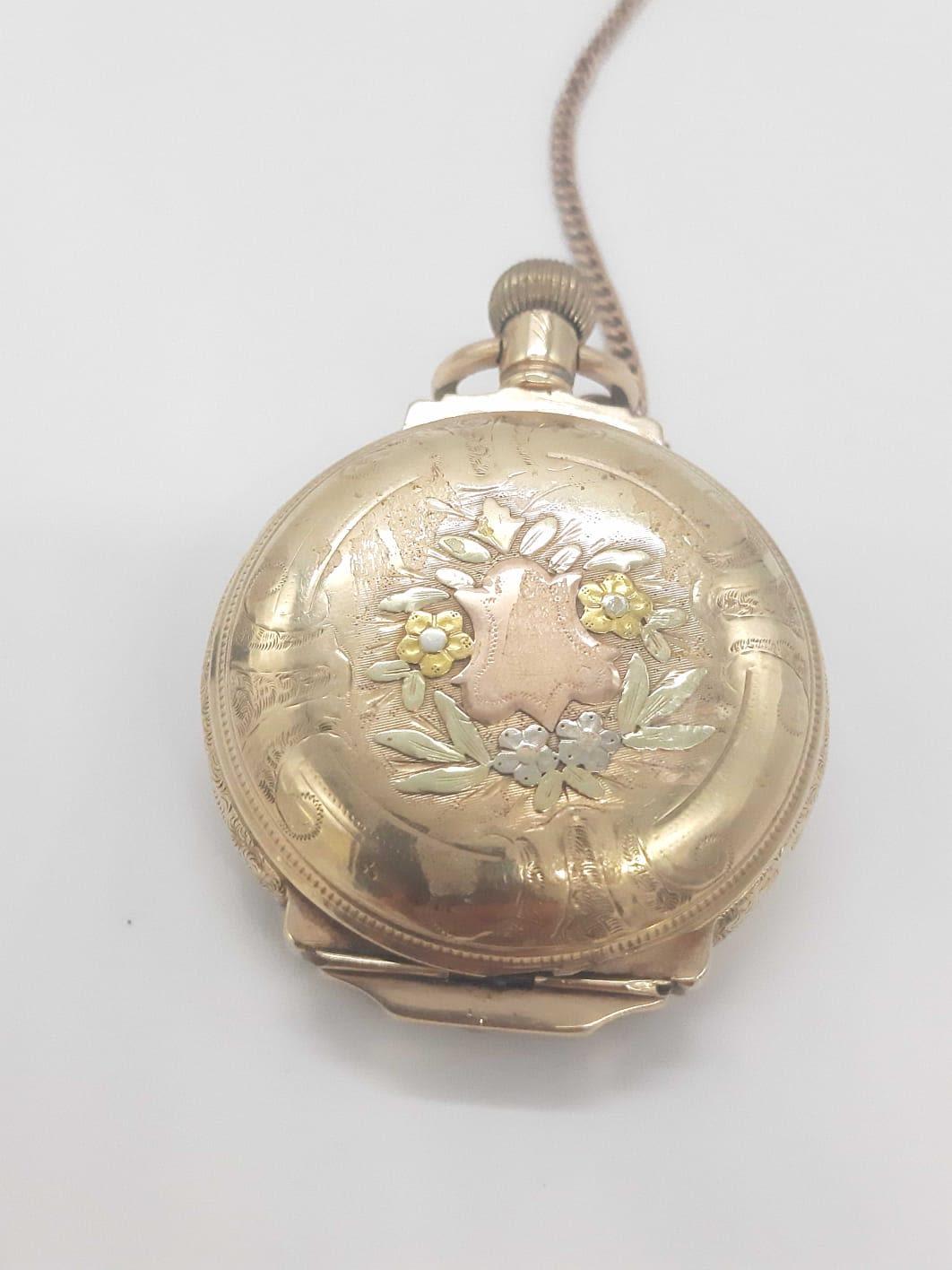

I would much aprpeciate advice and help in bringing this watch back to working condition. I do not have a picture of the inside, as it is sitting at a local jeweler and I did not know to take a picture of that before giving it to them to repaid. they indicated they can't repair it for any decent price-- unless i bring them the parts.

looking at your picture you're missing your hands and that's because you don't have a crystal. You don't have a crystal because it looks like you don't have the bezel to hold the crystal in that is a major problem.
then there's the other peculiar problem it looks like the movement is rotating around inside the case? This would normally be impossible if the crown was engaged with the movement and yes it would normally be impossible. That might indicate somebody broke the stem off that's a casing issue like the bezel that's a problem.
Then based on the amount of damage the cases suffered the movement is probably not in a good condition.

now let's look at the price is $800 a good price or a bad price. To understand the price we have to look at things more seriously and we have way too many unanswered questions like $800 with the customer supplying the parts or the repair with the jeweler doing the parts.
okay let's pretend we're going to do the repair as I pointed out up above crystals missing that's why the hands are missing and the crystals missing because there's no bezel to hold the crystal in. That's means were going to have to replace the bezel which I think there's people out there that might do a custom bezel I bet you it's expensive.
then let's look at the other problem for that let me steal an image from up above and draw some lines on it. So notice the alignment of the crown with 12 o'clock position it's off a little bit? That normally should be impossible there's a stem that goes into the movement and it can't really go anyplace else and yet it's moved. Common lay when dials rotate like this it's because her dial feeder broken off but notice in the picture the secondhand? Secondhand is currently or at least appears to be where it's supposed to be in other words on the fourth wheel post so this indicates the entire movement must've somehow rotated?
now notice in this image what do we see about the crown in relationship to the dial? The secondhand is still there indicating of that the dial is where it's supposed to be in relationship to the movement but the entire movement has rotated which as I said is impossible because the crown is still in place well sort of it would indicate that the stem is broken off and I don't think I've ever seen it before at least this I've never seen this exact problem before with one of the's I did see a stem broken the other day but that's a different style a case.
oh and of course notice in the picture above the invisible bezel. so this means we need bezel, crystal, hands, stem and case work, complete overhaul the movements and we don't know the damage plus possibly a new staff based on the bizarreness I'm seeing so what you think $25 cover it?
So basically you're looking at finding another case. I've seen this style of case before so they're not impossible to find but ill take a while looking at eBay one will show up sooner or later and I'm assuming the cases gold filled but it does have interesting decorations on the outside of the case looks like a couple of different shades of gold.. Yes I know the color gold isn't quite as colorful as it could be but there's a couple of different colors there is not your usual case but it's not impossible to get either.
So used case probably off of eBay take a while to find one but one will show up sooner or later. Whatever problems the movement has in the jeweler should a given you a list of everything wrong with the watch especially if you're supposed to be finding the parts how can you find stuff if you don't know what you're supposed to finding

the case is inscribed/engraved, and that's the most sentimental part for me. i'd sooner put a new "watch" (for lack of terminology as a newbie) in the casing then get a new casing.

new case
the thought for the new case was based on needing a bezel. For the entire repair that is going to be the biggest challenge of all unless somebody knows a source of bezels.
Let's look at a wall from parts Log you will note that cases are not in the catalog. dials, hands stems are in the catalog casually didn't see any cases?
https://archive.org/details/catalogueofwalth00walt/page/n1/mode/2up
there's also the other problem of depending upon how vintage the watch is conceivably the bezel will have to be made custom-made or I don't know if you can modify an existing bezel if we found something really close whether somebody could make it fit for instance
oh and even if we found another case on eBay a lot of these things were hand fits so one bezel may not fit on another case.
Ah ok. Tbh the 800 isn't sounding too bad if thats inc. the parts. I expect finding a bezel that fits is gojng to be time consuming and having one made is a big chunk out of the 800.
I suspect is only one person the group that give us one of the answers unfortunately lives in Switzerland the cost of living is expensive so maybe we'll look at this a little differently. Plus if we discuss prices its border lining on violation of the rule and selling things on the discussion so we can look at it differently and possibly get an answer
so the only person is probably ever made a bezel would be @nickelsilver so you I give us a clue as to how you make the bezel and how many would you think it have to make to get it right? My wording is because conceivably you might have to make a test bezel just to find out how the things snaps together etc. you might be lucky and make up the first time I don't actually know. So were not good discuss money because of the service you could provide so approximate estimation of how much time you think it would take to make a bezel? Then approximate price of all of the equipment you have to make that bezel.  then based on that will become suspicious that $800 seems a little too cheap? I wonder if there is something that they know that we don't know? Although I could be wrong on the cost of a custom-made bezel but added into the repair I don't know it seems cheap but

I am working on getting the watch in the next few days so I can take a photo of the inside.
