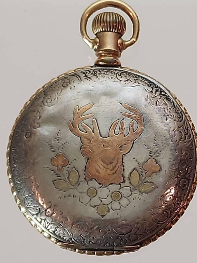

9 minutes ago, Zayga80 said:
this is what I got:
  • Stamped: 14kt
  • Serial number 835687.
  • Watch diameter: 5.5 cm
Thank you for that, and perhaps a pic next? Because, and FYI:
a) Lots of cases that are gold-filled or plated have 14k stamped on them, though I don't think it isn't. For me, the multi-metal cases are more difficult to figure out. I have a sterling silver watch that looks similar and gold-filled ones too. It is gorgeous no matter but one wants to know, right? If it has a guarantee of years, it is not solid gold. If it says it was assayed, then it is. And there are many other indicators.
b) I just looked quickly at the pocketwatchdatabase.com web site and if the serial number is correct it is a model 1857 watch, probably made in 1875, and the grade is Home Watch Company. The others I have seen have Home Watch Co. on the movement. It is key set. Do you know if yours says Home Watch Co. on it? I looked at just a dozen examples but so far none are signed on the dial like yours is.
c) This serial number points to an 18s size which has a diameter of 44.87 mm. I wonder if you included the case?It all only matters because the people eager to offer advice  will be more effective if they know all the details. 😃
Can we see pictures of the movement. Are these numbers on the case
the problem is this is the second page  of the discussion with bonus things to distract. You need to go back to the first page then you'll say oh  that watch. Then you scroll down and you get the name on the dial  in the numbers make a lot of sense. You just need to refresh your memory like I did.
7 hours ago, Zayga80 said:
  • Stamped: 14kt
then it probably is 14 karat gold because I've seen a case like this before.. You'll notice the back with its various colored gold's it probably is solid but  ideally we should have the picture because as others have pointed out there may be clarification words associated with that number. there might be words like 20 years case which tells you it's really a rolled gold plated case  but they don't say that because it looks more impressive to say 14 K but really do need a picture just to clarify..
tthen from the picture on the other page I know that that's a serial number  we can go to the pocketwatch database we know who made the watch and there it is.
https://pocketwatchdatabase.com/search/result/waltham/835687
then yes I went looked at the list of movement sizes and obviously the diameter does include the case otherwise that would be a really big movement.
then the problem pocket watch database is the source of the information was not meant to be doing what were doing now.. The watch companies had listings for parts availability. Often times like for instance Elgin a whole bunch of separate watches get lumped together as one category for parts while are actually a whole bunch of separate watches. Then we have Waltham which tended to have for parts and other things lots and lots and lots of variations. So basically  we get close but we may not get a exact match because that's not what the database numbers are based upon

John, how did you get to be so knowedgeable? Are you a watch savant, or do you have other areas of expertise? I really appreciate your posts.
About the case, yes, I can see it is multi-colored metal and have no opinion about the composition of those metals. My point is, it seems to me that people get confused and if he is talking a new case (which I do not think he is) it is important to determine . Here are two multii-metal cases from my collection, for example. One marked as sterling, the other as 14k, when clearly more metals are involved in both. Not sure how that works.
time would be the most likely answer. I love the quest for knowledge so I've accumulated a heck of a lot of knowledge but not just in watches. Unfortunately not enough knowledge to get me a job in any of those things. Then I've also answered a heck of a lot of questions which means I have to research those more knowledge. I'm also taught watch repair to hobbyists which is why I also can anticipate what the questions really are versus what is being asked. So just I've collect a lot of information over time.
then yes case descriptions become interesting because when you see 14 K you're thinking money valuable. But you start adding on extra words or initials and then you find out it's not solid it's just plated or  one of the ways they made like the twenty-year cases and rolled gold is they would sandwich a layer of gold heavier on the outside some base metal and then a thin layer of gold and that is rolled out used to manufacture the case that has a very heavy outer layer but it's definitely not solid. Then the Europeans have a whole bunch of different terminology for things all designed to impress the customer and confuse everybody but as long as you think it's valuable it's okay.
Other things that make cases interesting especially for American pocket watches because I don't know enough about the European ones. Was that for instance at one time you go into the store pocket watch movements in one case cases in the other case you could pick and choose. One of my friends has a really nice called Francis Ruby 10 the size Elgin. Basically it was a very high grade ladies key wind watch in a I can't quite remember these a gold case with the original cardboard box and everything is very proud of that all original. Except the movements were sold separate from the case they were brought together so it's not like was purchased from the factory in that condition but he's happy with his watch so who cares about the details.
oh and I forgot something about the pocket watch database is why we still need a picture of the original watch. We go back to pocketwatch database you see the name all this stuff but notice the model number 1857if you click on that you get this link down below. Did you notice when you looked at the pictures of the first link where it is keys sat but some of them were key wind some of them were not and how can that be? Well you go to this link and scroll down and look at all the 1857 models. this is where the confusion becomes were using it to identify a specific watch and it refers to a model that came in a whole bunch of different variations. So until we get a picture of the actual watch we don't actually know what we have.
https://pocketwatchdatabase.com/guide/company/waltham/model/18s/model-1857
let's look an example of the problem of model numbers first this one appears to be too old for this parts catalog. I need to run away right now but I might have a slightly older one I'm not sure so casually I didn't see 1857 but you look at the other watches you'll see all the variations of dials and then go and pick one of the 18 size watches and look at all the parts variations for an exact model number the parts are not very exact end up with way too many variations. This becomes a major problem when you're trying to repair watches pocket watches in particular is that none of the parts conceivably will interchange.
It's a long story but I know someone who accumulated a whole bunch of 12 size Illinois watches one of the reasons it was done because they had all identical parts according to the parts catalog. But having worked on those particular 12 size watches one day I went through I can't remember how many just to get the balance jewels because are so many variations for seemingly identical watch that was made much later than this watch. Waltham that I find tends to the worst for this sort of thing there's so much variation to find a watch like model number and no it doesn't fit the watch your working on. Although sometimes you get it to work at a pallet fork once was able to disassemble it mix-and-match the pieces I had put it all back together and it worked
https://archive.org/details/catalogueofwalth00walt/page/n1/mode/2up
Yes I am always wondering what happened when I come upon a 21j watch in silveroid or a 7j in 18k. I already imagine the people who once handled my watches, these disparate pairings double my musing. I guess environmental factors such as availabilty determine the case/watch marriage, but there might be other reasons.
Cheap case/ pricey watch combo reasons: there were probably plenty of folks who simply liked the way a cheap case looked, or people who spent their last dime on a quality watch and went nearly broke doing just that, or probably there were some who lacked impulse control (like some of us), thus took whatever case they could get right that very second.
Cheap watch/pricey case scenarios: None good that I can think of. At worst someone trying to project an inflated worth for criminal reasons, at best trying to project an inflated worth for reasons of low self esteem. And of course, there are many more reasons.
In my opinion gold is a poor choice for watch cases.  Too soft and at higher karats looks like brass. Good quality modern watches come in stainless Steel, tungsten and ceramic, along with gold.  I don't think the case material relates to the quality of the movement.
