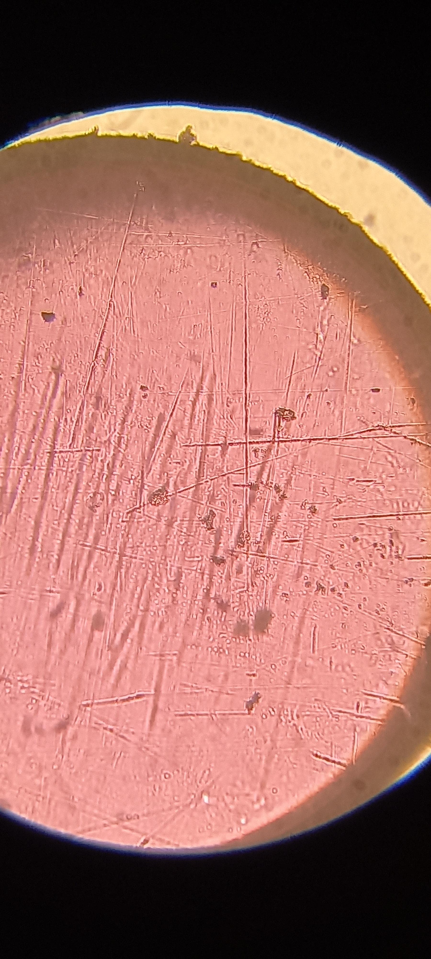

Eyup watch peeps , so i had a little experiment, not completely controlled and a bit more to do yet. I cant vouch for the quality of the jewel, all i can say it was from a 60's oris movement, so i would think reasonable, and it was in fair condition so i thought it a good test sample, i didn't take a photo but that doesn't really matter as you will see. The scratch material just some cheap 400 wet and dry also not controlled, as i have no idea what it made from, probably aluminium oxide but that doesnt matter either as the test is just to see if a jewel will scratch first. I thought lets see how tough they are and then work backwards to a medium that wont scratch. First just a couple of light strokes backwards and forwards on the 400 produced a few light marks. I was very slightly unsure as to whether I'd inspected correct so lets give the jewel a good rub. 15 seconds of still fairly light pressure , which equates to around 30 backwards and forwards. Here is the result at x60 and x100. I didn't need to get any closer. I think that answers the question # does a jewel scratch # ? 👍 spot on Watchie,  complete carnage.  I will try a few more from different sources , and still yet to test on different papers. Oh the watchpaper has just a weave like pattern with no particles  but has holes in it, plane paper more or less the same weave but no particles or holes. I tried a few samples, obviously it can vary.
Great experimenting, I am really shocked that just 30 seconds could do this to sapphire!
Wasn't even that just 15 seconds.  Around 60 strrokes of a distance of about an inch. So in total it being dragged fairly lightly a distance of 5 feet. The wet and dry is mounted on sponge. The scratches were almost instant,  you can see the few first test scratches going cross ways, that was just a couple of 1 inch strokes. The deep stuff running top to bottom was the longer test. Yep I'm  shocked as well. Maybe a poor quality jewel i dont know. I dont have anything specifically labelled Seitz and i dont know if there would have been any other supplier at in the 60s , good or bad. But the fact that watchie said he tried a similar test and had the same result suggests that this would be a standard find also in line with Nicklesilver's statement. So i dont understand why other posts here didnt have this same result. But i will try some more just to check that this wasn't a very poor quality jewel. The scratch medium is fairly irrelevant up to now as it scratches and its not diamond, probably aluminium oxide which apparently is what jewels are made from ( corundum ) so i imagined that was going to happen. I will also test on a diamond stone to see the difference.  The grit used is also irrelevant, lower grit deeper  scratches than higher grit shallower scratches. None of this should be found in paper. So maybe back to a dirty jewel that has not had its surface washed and rubbed dry on paper can scratch from aluminium oxide impregnated dry oil from jewel wear with just a few strokes on paper. 🤷‍♂️
Edited by Neverenoughwatches
Yes, wet or dry (States terminology) is silicon carbide, sitting above aluminum oxide/sapphire at 9.5 Mohs, so it should definitely scratch a jewel.
Edited by nickelsilver
