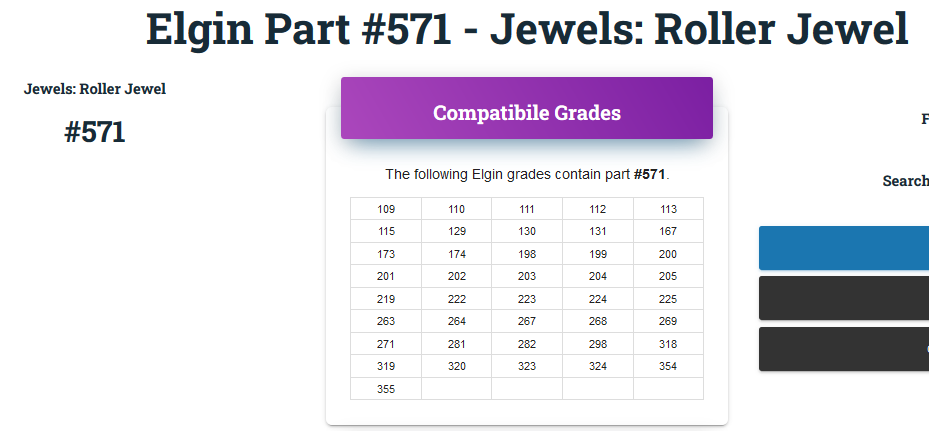

Think there may be something missing off the balance wheel, should this have something that moves the pallet fork?
It does appear to be that you have a missing or broken roller jewel. I don't suppose there's any of it left in the hole?

the reason I was hoping there was a little piece left was that you could measure that now you going to have to measure the slot in the pallet fork ideally with the proper tool that you don't have in order to figure out what size jewel we need and then you're going to need a bunch of tools that you don't have to put the jewel in. Then no you cannot look up to jewel itself because they varied with time to a certain degree.
But let me go look at the parts list and see what it says
Oh look we got a part number but unless we have a time machine and we can go back in time it's going to be somewhat worthless so now I have to go to the parts book and see if I get a specification so you can look forward jewel otherwise you have to measure it.
Then good for me and look to see where you'd posted this if you posted it in the safe zone for newbies I can't refer you to any place else at least that's the rule now I can say go look for how to replace a roller jewel in the discussion group but that would probably be a waste of time as you probably never find it anyway people don't always title things appropriately
Okay as I suspected back to the parts page on the bottom which I already knew considerable variation in size. Also because this is a single roller in need a long jewel that means you can't use probably a modern replacement will need a vintage roller jewel of the correct size. +1915 Elgin's parts book doesn't actually list the ruler jewels? I'm not seeing it doesn't mean it's not there I'm just not seeing it. Seeing as how I gave you the link to the parts book can look yourself there may be another section like in the back where they have the roller jewel assortments we can get a size but it's probably best in real life to measure it.
Not entirely helpful but pocketwatch database gives us this
Oh and if the balance wheel engage the pallet fork previously it means that it did have a roller jewel originally and it may be lurking around wherever you're working? So yes you're looking for something really tiny that's shiny probably clear edition color and as you might find it. I find dealing with roller jewel's a pain in the ass I did that last week and In-state at least within the benchtop and I finally got it in as I can proceed with the watch is working on but they do tend to be a pain. Then no you can't do a balance complete because there aren't really any balance completes for watch like this and you have to fit your balance complete to the watch so it's best to replace the roller jewel
Let me know if you would like to proceed with replacing the roller jewel or whether you want to set the watch aside and practice on something else. Because you need a variety of tools to replace this all of which are useful if you're going to work on pocket watches in the future. But the unfortunate problem watch repair is a lot of us tools that only an occasional use because if you're lucky you don't have your roller jewel falling out that often
Okay I was thinking about something so website he has roller jewel's so we just need the diameter and you just helmets for a single roller specific size to tell them what you have and you'll get you the right one but we still need a diameter
