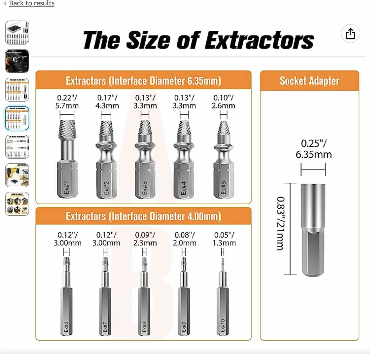

Just bought this for about USD 20.
I'll wait until it arrives and see if I can make magic happen then(:
They look like some of the smaller easyouts I have used, good luck, and let us know how it goes!

Here is the link to the Amazon page. It's from the Swedish Amazon since that's where I live but I'm sure it can be found elsewhere.
https://www.amazon.se/-/en/gp/product/B08XXP1SD9/ref=ppx_yo_dt_b_asin_title_o00_s00?ie=UTF8&psc=1
So I just got the tools, but no luck. The crown tube simply does not budge. The tool dug a new thread in the tube but did not move it whatsoever and if I go any harder, it will likely damage the threads in the case. I have broached a bit but it feels like that will inevitably ruin the threads too. Is it worth trying the alum powder?

That is the purpose of an extractor to cut a reverse thread into the hole of what is to be removed. It needs to finish cutting the thread and the shoulders meet of both the extractor and the item being removed. At that point you have both items locked together to enable turning out. True you may risk breaking through the tube into the pendant and damage its threads. That has to carefully gauged and choose the correct width extractor to prevent that. Did you first try softening the tube's lock adhesive with acetone as Nucejoe suggested ?

I know that that is how the screw extractors work, it's just that what's remaining of the crown tube is so thin that it almost immediately just digs into the threads on the case instead.
