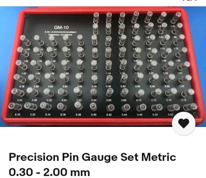

That would be a nice complement to a set of jewel gauges like these. I lost access to the shop when I retired, so now I have to get my own darn tools. I think the set you are showing is UK only, though, and shipping to the US might be prohibitive, otherwise I'd consider that set for myself.
https://www.ebay.co.uk/itm/285211999320?mkcid=16&mkevt=1&mkrid=711-127632-2357-0&ssspo=r1kfqhqZStS&sssrc=4429486&ssuid=tBiLZaCfRb2&var=&widget_ver=artemis&media=COPY
I bought these pin gauges a few months ago, as well as the 1 mm to 2 mm set. They are bang-on when it comes to their thickness. Really helps when re-bushing, so you don't have to remove the bridge or mainplate to measure the bored-out hole. I've got a set of Bergeon pin gauges measuring 0.07 to 0.5 mm, which cost a small fortune but couldn't do without them for smaller work and measuring the inside diameter of jewel holes.
The same seller does pin gauges from 0.1 to 1 mm
https://www.aliexpress.com/item/1005005362640246.html?spm=a2g0o.order_list.order_list_main.31.21ef1802cKI5O7

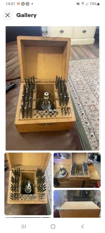

Hey all watch peeps, i trust we are all in good health.  I have another tool for us to identify,  this time i don't know exactly what it is.  I thought I had seen it described a year or so back by an ebay seller but i cant quite figure out how it works per the description.  There are various sized drill bits and taps and a brass holder with 2 removable ends.  Yes its for making a hole and then threading that hole but for something in particular on a watch. What might that be ? and how exactly does the tool do that ? Its open to anyone that knows becasuse i dont know for sure 😄
typically I ignore this discussion because a while back you put a restriction on who could answer. in other words on some previous tool you perceive that it would be too easy for most of us you're looking for others to use their imagination as to what it can be. Strangely enough this tool falls into that category doesn't it?  mine is lurking in the bench I don't think I've ever actually used it. For the most part is typically not something I would do at least with normal watches. Then I don't think I've ever seen instructions on how to use the thing.
But still it does make for a nice mystery tool the clues are in his description but?
Hey John, yes some mystery tools are just too easy for you pros, its good to give others a chance of guessing it first This i didn't think really fitted into that category, i dont really know what it is for maybe i should put a time limit before professionals give us a definite answer. We can see that its used to drill a hole and cut a thread but in what exactly?  I think it has a specific use and maybe something else besides the drills and taps fits into the brass holder.
