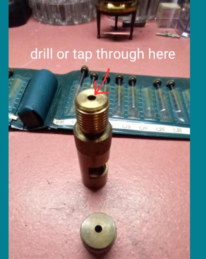

I think we've established that they are crown drills and taps, but now how to use them please John . Oh something else the price of them, i didn't pay a lot,  (£30) or so i thought until i found this seller on ebay which then made me unhappy 😒 . Then I looked again, hes selling the pieces separately 10 each for the drills and taps and 25 for the holder 25 for the wallet ( if hes lucky ) . So over 200 for the set, so now I'm happy 😊. Something to sell John if you dont use yours ?.
casually the tool looks bewildering and there is something it didn't make sense? Then you study it carefully and then you realize oh okay this makes sense now. But it would probably help if I got some pictures tomorrow. although technically I define tomorrow as whenever I wake up after I go to bed so that will be hours from now.
what sell the tools that I don't use what if I might need them someday in the future? although I have no idea when I acquired the tool and zero idea of what I paid for it.
I haven't really studied it much, it only came through my door on Friday.  I kind of knew what it was from a previous sighting on ebay a year ago. I can see how the drills and taps fit in the holder actually they can go in both ends, the picture I've shown i think the drill is in wrong end. I'm assuming a crown is held by the vice end and a drill or tap is fitted through the opposite end to work on the crown while its viced up. The pictures show how i think it works, I'm thinking use a tap that fits the crown to be worked on to center it in the vice, lock the crown in place, remove the tap then use a drill and a bigger tap to rethread the crown.  I really should have more of a play but breakfast out wifey's treat was calling me.   As for selling on , you know what they say # if you haven't used something in over a year then you dont need it # I'm positive watchmaker's are not factored into that saying. 🙂

In days of yore, pocket watch crowns were offered without a tapped hole.  They were then drilled and tapped to match the stem.
In my current case, I would have salvaged a crown by plugging the hole and then re drilling and tapping.
To do this on the lathe, I'd have to set up  a way to hold an onion shaped crown (pain) and I'd still have to find a tap for a "tap 0" thread to work with stem in the watch case.
Using this little gadget would have been easier.   I ended up finding a crown that worked,  but it was a bit of an ordeal.  The crown is also a bit more worn than I would like, but oh well..

Hi John, I'm still not clear on how to use this, do you have any advice for me please 🙏

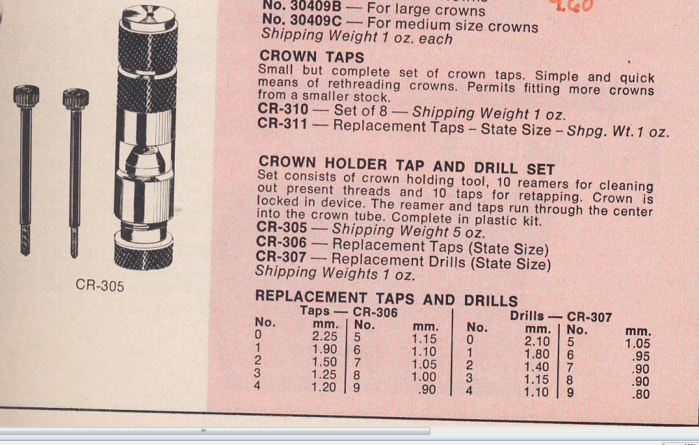

I did figure out where my vintage catalog of tools was and I got a description from the catalog. Notice it does skip over some details.
then if you really want pictures possibly much later today maybe. In the meantime description the one side is used to hold the crown in clamp the crown for drilling in thread cutting. Obviously the crown has to fit within a certain size and/or shape where it's not going to fit right.
I think to a certain degree the tool itself is self-explanatory if you hold it in your hand. One side is for holding the crown this forms a little clamp you screw in the piece that holds the crown tight against the hole where the drill Goes through. But before you put the crown in you would have to determine something which is how far do you really want to drill? if you look at the other end of the tool with the hole and the adjustable part that is an adjustable end stop. This way you can set how far the drill goes and you do not drill all the way through the crowd as you would have no other way of determining where the drill is.

Thats fantastic John i really appreciate your help, it was the depth stop that was throwing me off, makes perfect sense now 👍
