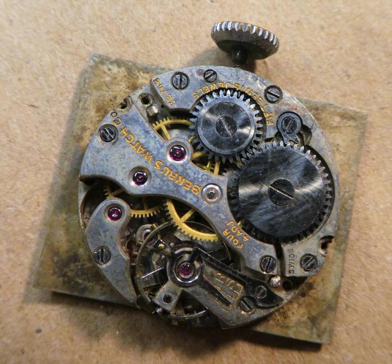

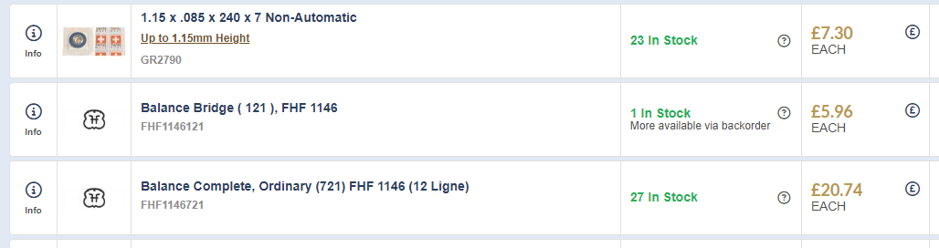

I've just finished trying to identify some scrap movements I bought. I think this is an FHF 1146.
The keyless looks the same. Though it measures 23.3 mm
In the flume catalogue i have the 1146 came in sizes 8 3/4'"   9 3/4'"   and 12'"

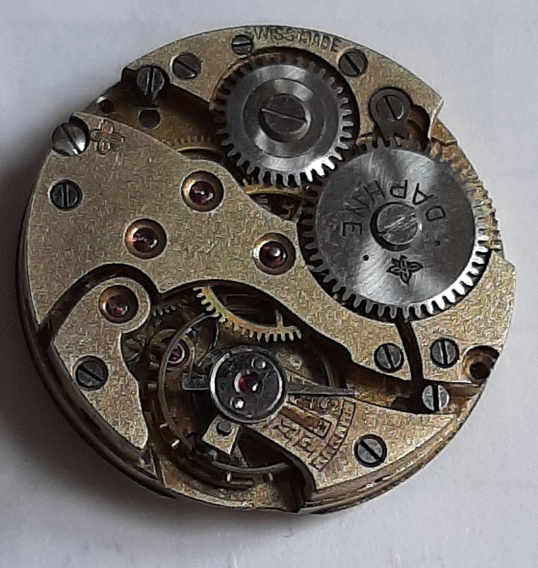

I need a balance spring and a pallet fork for this movement. Any idea where to find it?
On the dial side of the watch is stamped FHF8, but obviously this is a variant of FHF 1156 (different bridges).
Your only real chance is to find a donor movement on eBay.
Different bridges don't mean fork and balance springs are different too.
 Fork and balance are parts of the escapement, designed to beat at certain rate which the entire escapement is suppose to produce, so you should base your search on beat/ frequency of the caliber you have .
As clockboy suggest your best chance is to find a donor, or a balance complete.
Balance spring off of two new balance completes of same caliber & frequency  won't readily interchange, though can be made to produce the design beat.
Prior to mass production of balance complete, watchmakers had to vibrate balance & spring to build a balance complete.
There many discussions on the subject on WRT forum.
