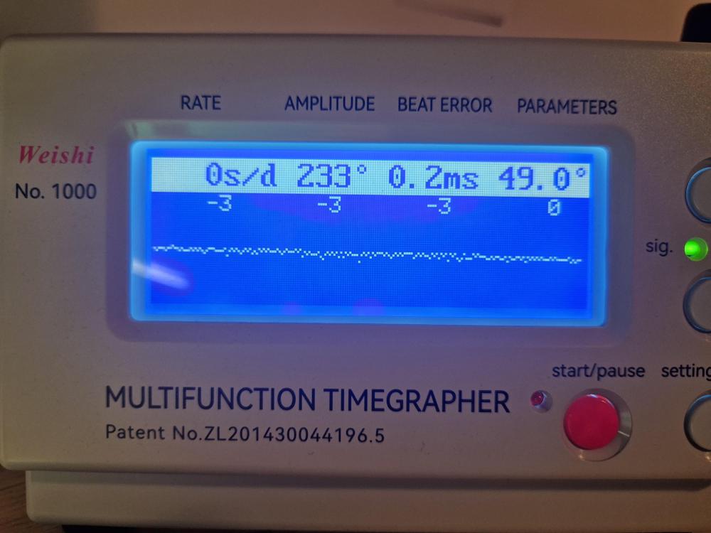

PROBLEM:

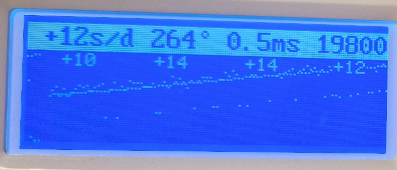

When fully assembled, the amplitude is quite low. And timegrapher traces get erratic in vertical positions.
So... after lots of troubleshooting, I've narrowed down the issue to the automatic works.
WITHOUT the auto works, I get a decent amplitude and traces are nice across positions.

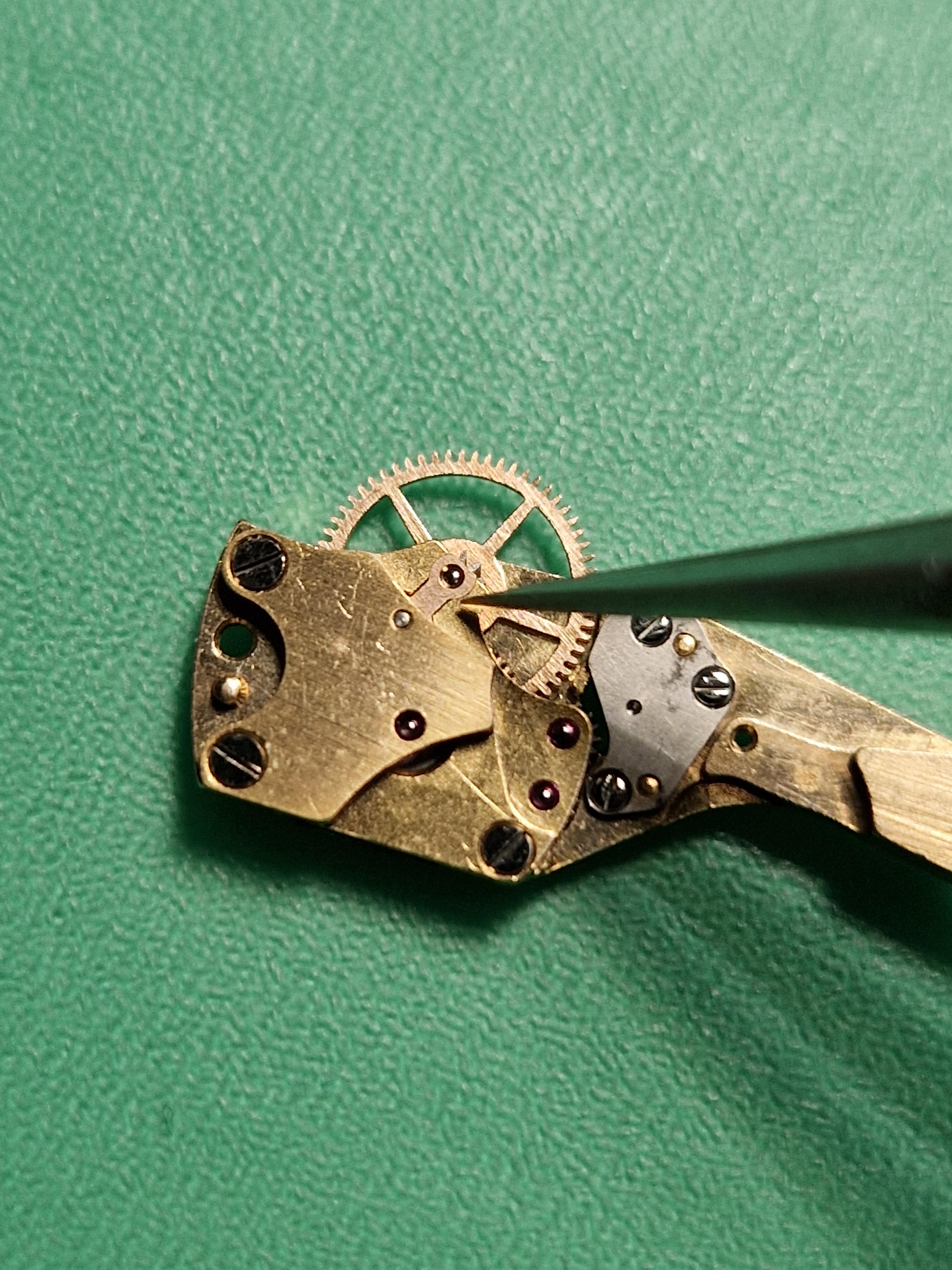

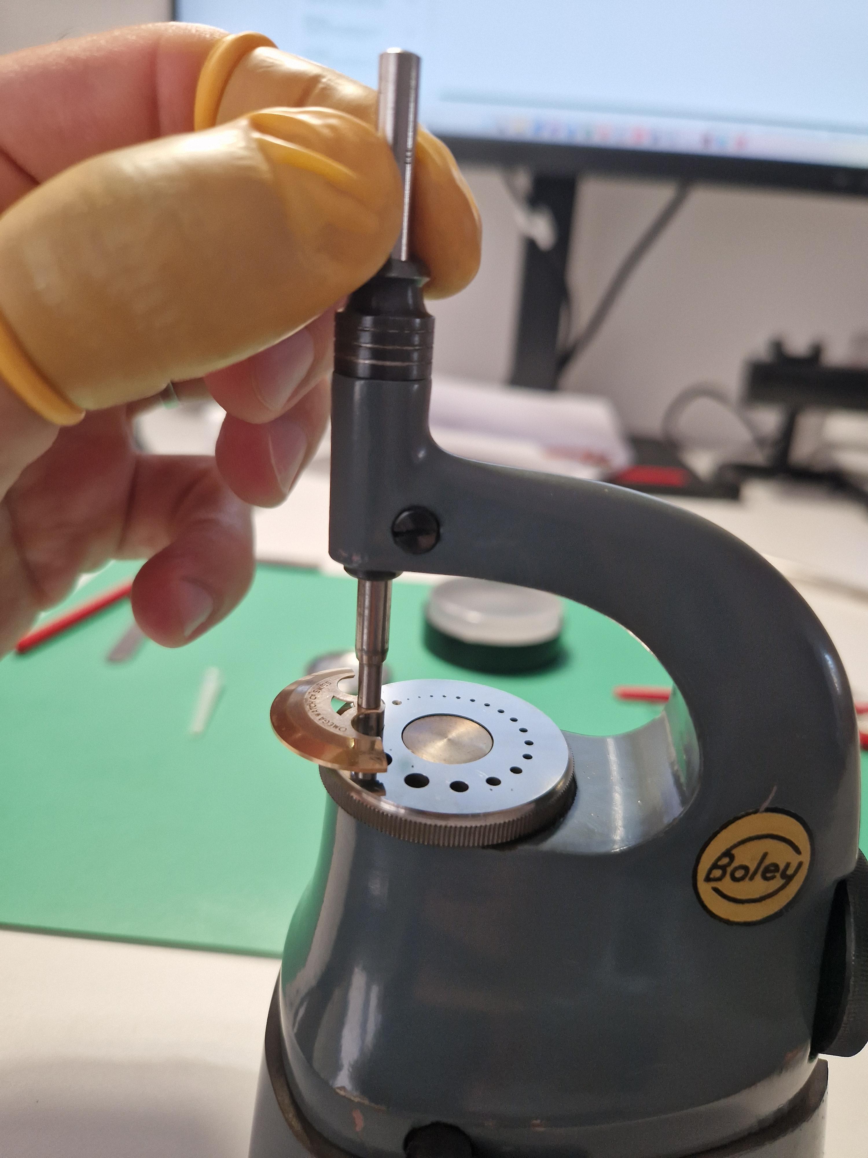

My inspection of the automatic works showed one issue: the bearing of the driving gear is very worn and there's clearly too much side shake. It certainly affects the engagement with the ratchet wheel and is probably the cause of the resistance in crown-winding.
But would that affect amplitude when the watch is static on the timegrapher??? Does it make sense (meaning, I only have to replace the bearing) or do I need to look elsewhere?
Thanks in advance for your help!!
PICTURES:

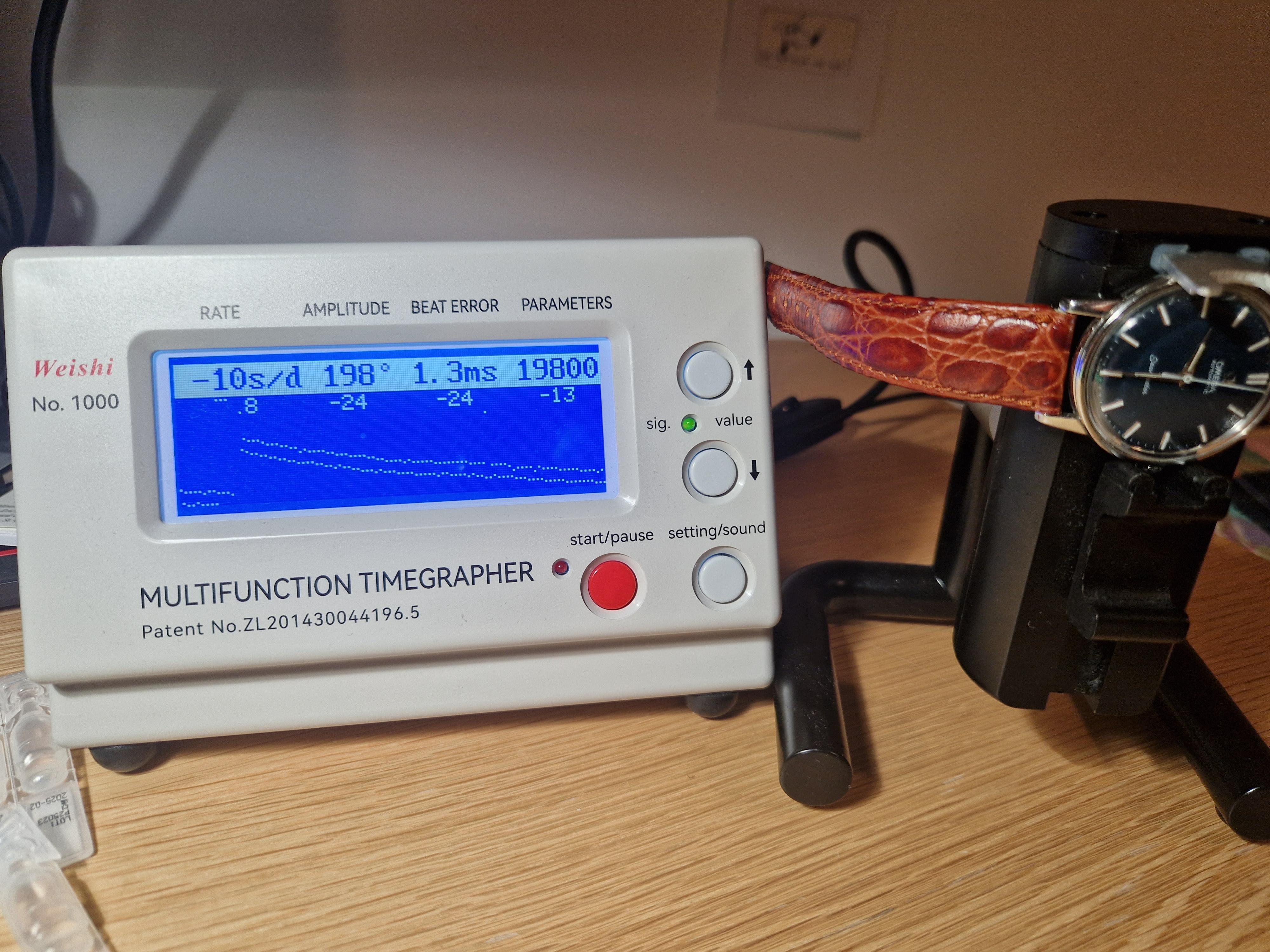

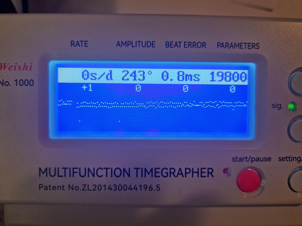

Without auto works (note: this is after 18h of running). Amplitude of 250 and stable traces across positions:

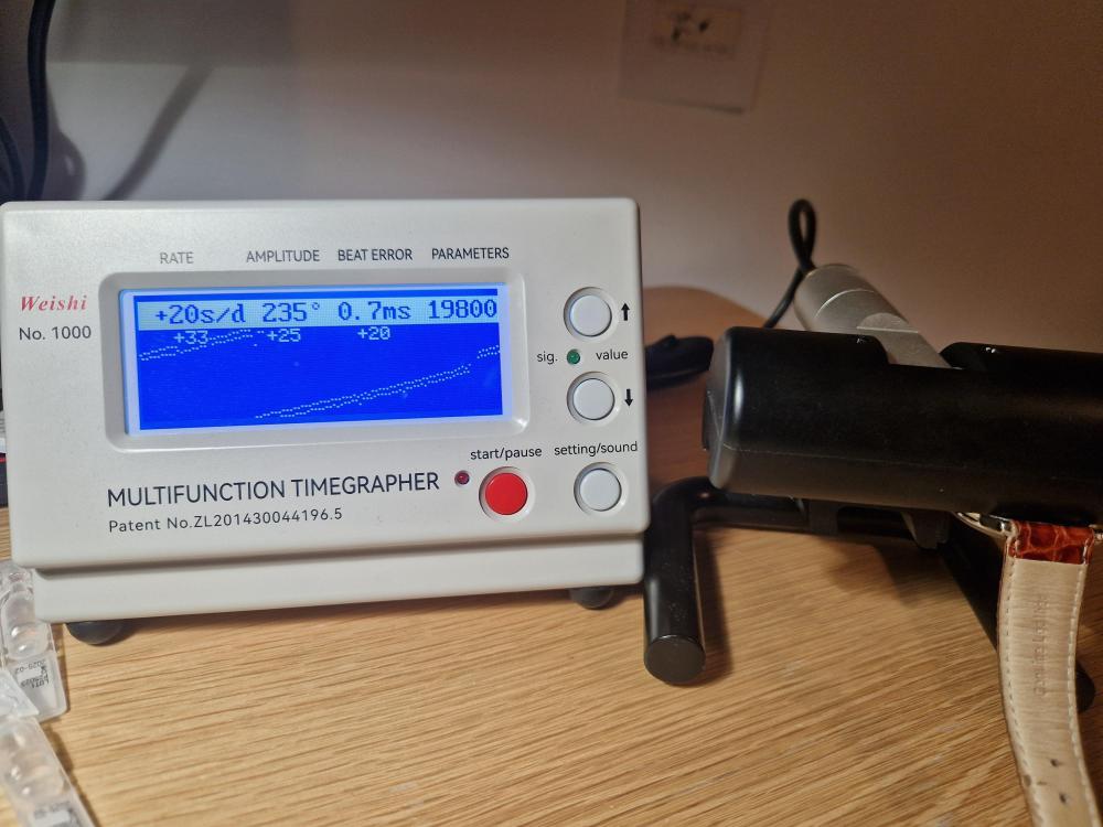

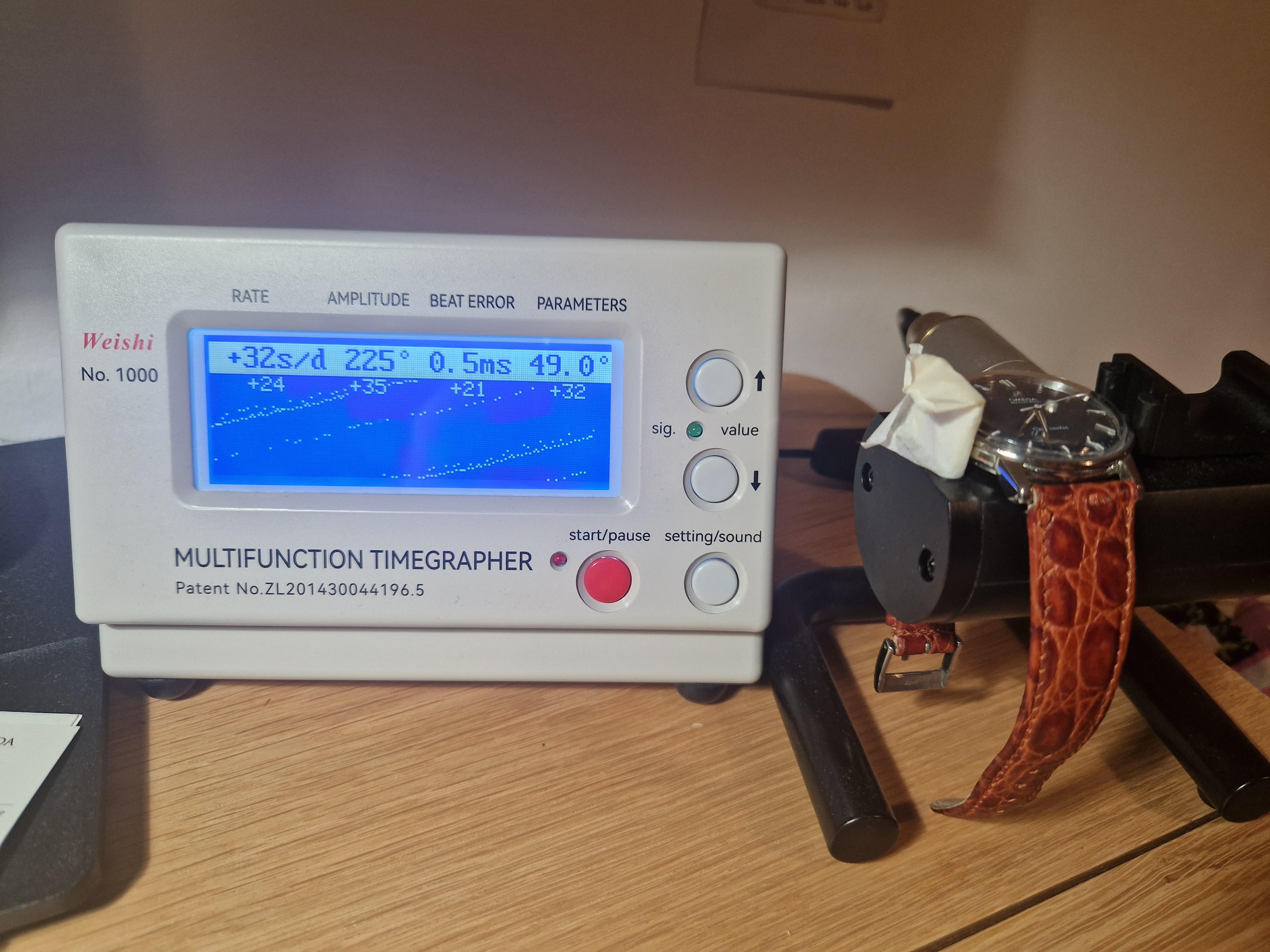

With auto works. More than 30 degrees less amplitude. But this picture doesn't show the mess in vertical positions. There really is a problem.

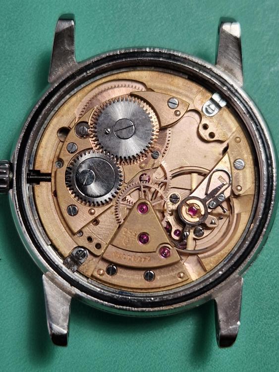

Could this bearing be the culprit??

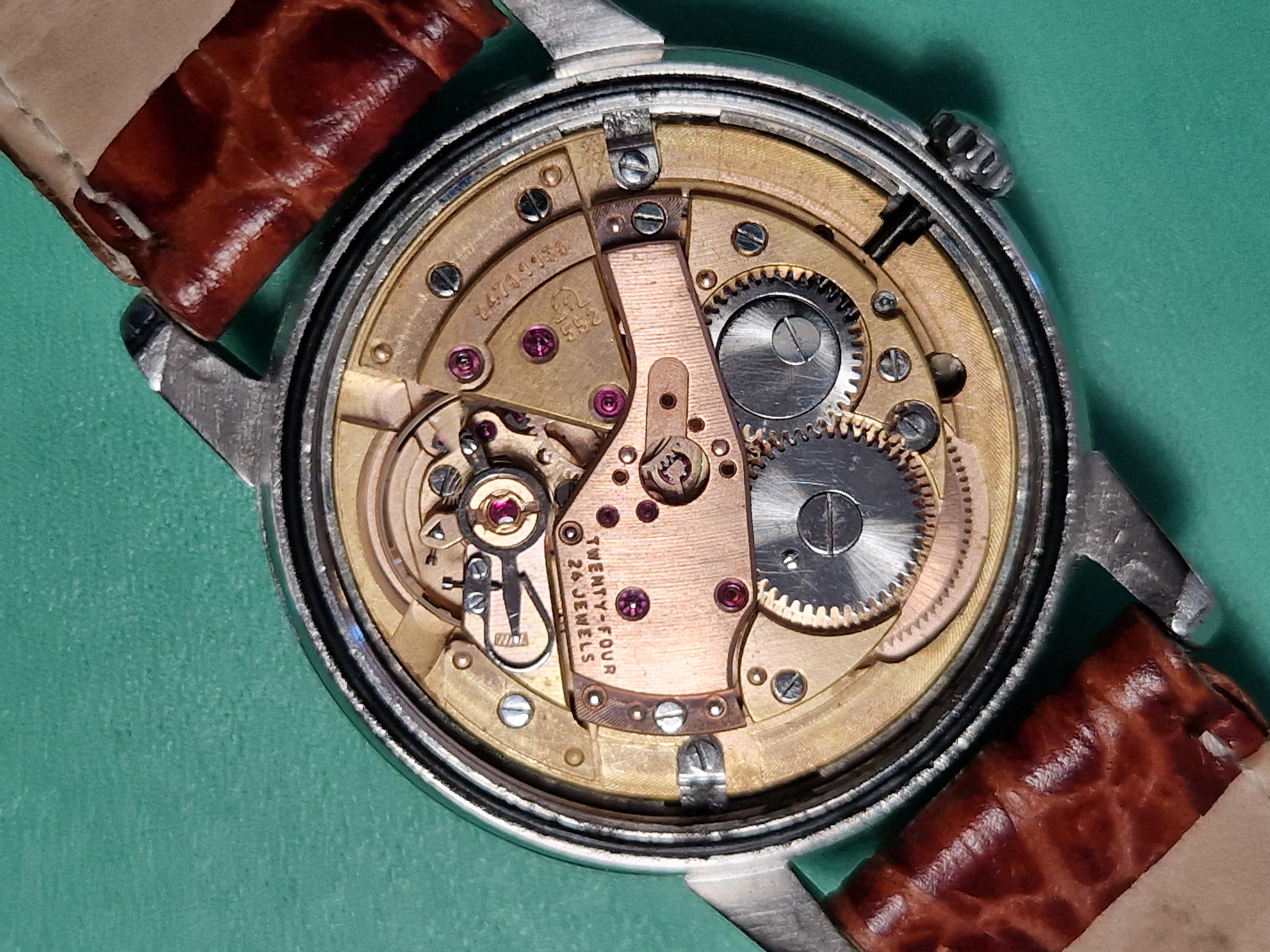

Nothing particular to highlight, but just for completeness, here are also pics of the full movement with and without automatic works. 20230722_164107.thumb.jpg.15190362394723d2642a832971ac150f.jpg20230722_161559.thumb.jpg.600a0bb76e0d436a60fabdfdb653a63d.jpg

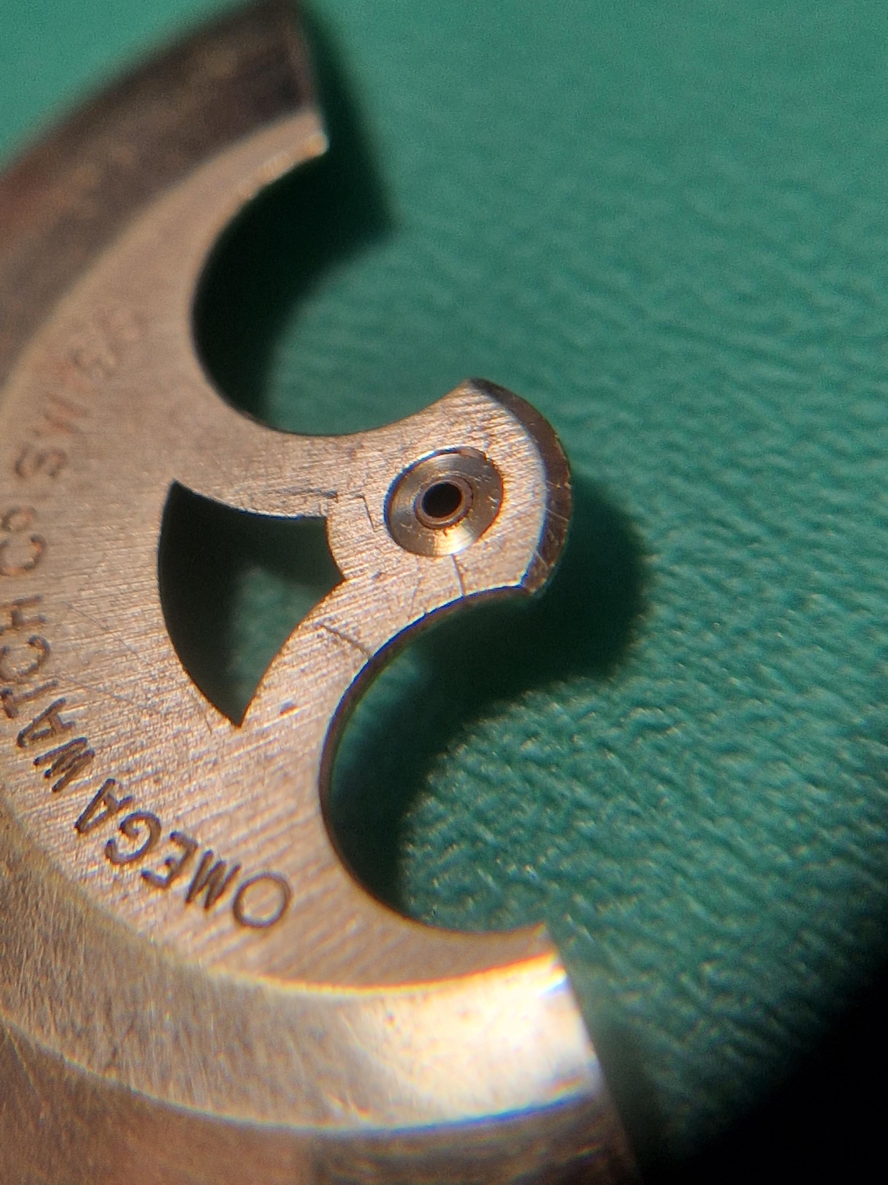

- the rotor spins feeling and doesn't touch anything.
- the rotor doesn't "helicopter" when I wind manually

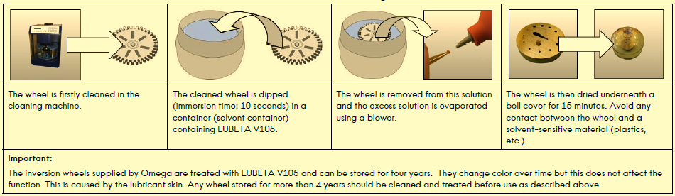

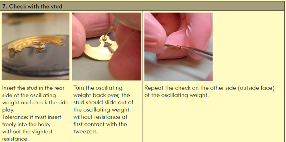

My main suspect is now the reversing wheel (oh no!). I had cleaned it as a whole in the ultrasonic (5min L&R cleaning, 2x 5min L&R rinsing), then submerged as a whole in Lubeta V105 for a minute.
But, as I said, the strong resistance when manually winding the watch (with auto mechanism installed) was already there before I serviced it. Maybe it was already heavily worn.
Before I open the reversing wheel (without the proper tool), is there anything else I should check?
so on the group we've discussed this before but obviously you didn't see it Omega does have a procedure for the reversers if you don't have the tools which no one does and even if he did have the tools and probably still prefer the procedure of lubrication assembled as it's a better procedure.

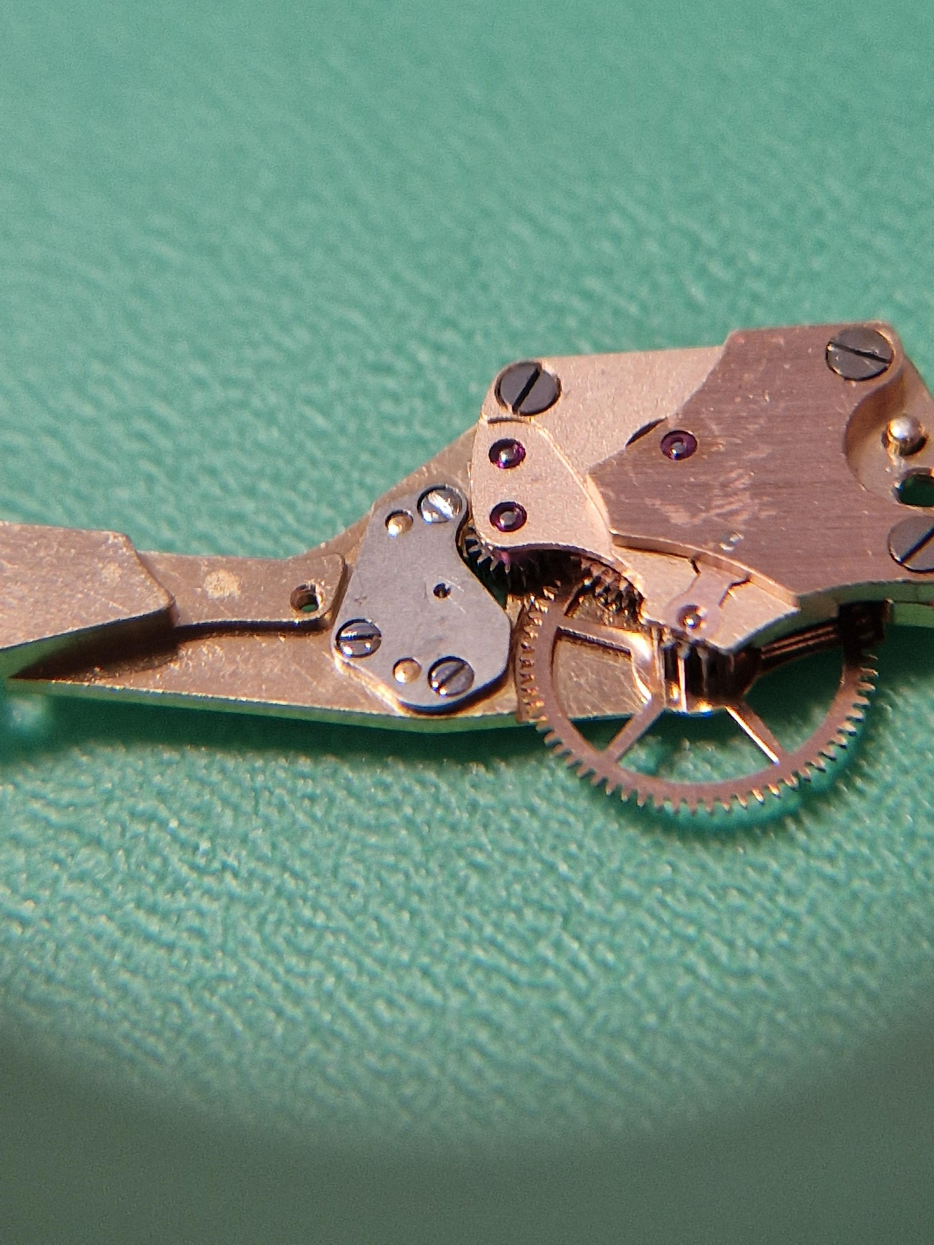

But then I had problems with the centre seconds pinion spring. In the end I replaced it with a NOS one and that helped.
what sort of problem were you having? The reason I ask is if you look at the automatic assembly and the spring itself I don't suppose it pushes on that at all does it?
what's interesting is when you look at the timing trace amplitude is fine as soon as the automatic goes on the amplitude drops and I seriously doubt it has to do with any of the wheels at all because you're not turning. If it was pushing on the setter second assembly that would cause additional friction or if it was somehow bent and maybe twisting the plates I don't even think of a screw was too long it would be an issue?

Indeed that problem seems/seemed very similar. Amplitude was quite low (around 200 fully wound, dial up). Similar to now (with auto bridge on). I assumed that the friction from the spring was too much. So I loosened it a bit by bending carefully. Then the seconds hand became jumpy -- so I clearly overdid the bending. I bent it back again and managed to get a nice sweep second again, but again at the cost of amplitude-- and after these bending back and forth efforts, I observed more irregular traces on the timegrapher. I assumed that the spring was now not fully flat against the pinion, but a bit slanted. So I ordered a NOS replacement. Without the auto bridge, this seemed to have corrected things as hoped (see timegrapher reading above).
I DID wonder if the auto bridge might be pushing on the seconds spring/pinion, but my assessment concluded that this wasn't the case. But maybe I'll check this one more time.

Then can I get a picture the timing machine results in crown down without the automatic on.
21 minutes ago, JohnR725 said:
The watch came in and it was running or not? The definition of servicing was?
It was running ok. Amplitude of around 240 (full wind, dial up), but it hadn't been serviced in 10 years and my friend is moving to Fiji and wanted a service before loosing access to watchmakers.
Service meant full disassembly, cleaning, new mainspring, lubrication and assembly. No repairs apart from the seconds spring and the bearing for the driving wheel, which was clearly oval and wobbly.
Interesting question! I wonder why this position?
Here you are (followed by dial up and dial down):
Crown down
Dial up
Dial down
typically when people place watches on the timing machine they show us dial down and its wound up nice and tight. In other words they did not let it run the required settling time that's basically from 15 minutes to an hour depends on which manufacturer you look at. It doesn't really matter you just need to let it settle down for a while because it's wound up tight the amplitude will artificially be too high. Then they never show us a crown positions ideally I would like to see all or crown positions for diagnostic purposes
so for instance your crown down image below we have a problem your graphical display looks a bit rough that is an issue. Typically when I think people are having amplitude and escapement or some other issues related to the balance wheel I ask for a crown position typically ground down easy just to see what things look like and what I see this that's an issue now be interesting to see what the other three crown positions look like.
so we have crown down and
we do not have a good graphical trace at all and that makes me suspicious of the amplitude. Typically the numbers to be right or anything to be right three things have to be met visually the amplitude needs to look good, the graphical display has to look good then the numbers have to agree with everything else if everything agrees it's right probably but this looks suspicious your graphical display is indicating a problem? This is back to what does it look like in the rest of the other positions of crown.
and see dial up is identical amplitude to the crown down position that's very suspicious not saying it's impossible but very suspicious.
this actually looks the best of everything for the most part and its amplitude is exactly the same as the other position which of course is impossible typically
amplitude is increased a little bit for dial down and the waveform looks a little bit rough?

In the meantime, let me already add the readings WITH the auto bridge installed. They look rather sad...
Crown down
Dial up
Dial down
Edited by Knebo
Changed image for crown down with auto bridge
40 minutes ago, Knebo said:
Haha, don't worry. This is just a bit of masking tape on the steel holder of the Weishi 1000. I put it there to avoid scratches on watches. It's not on the watch.

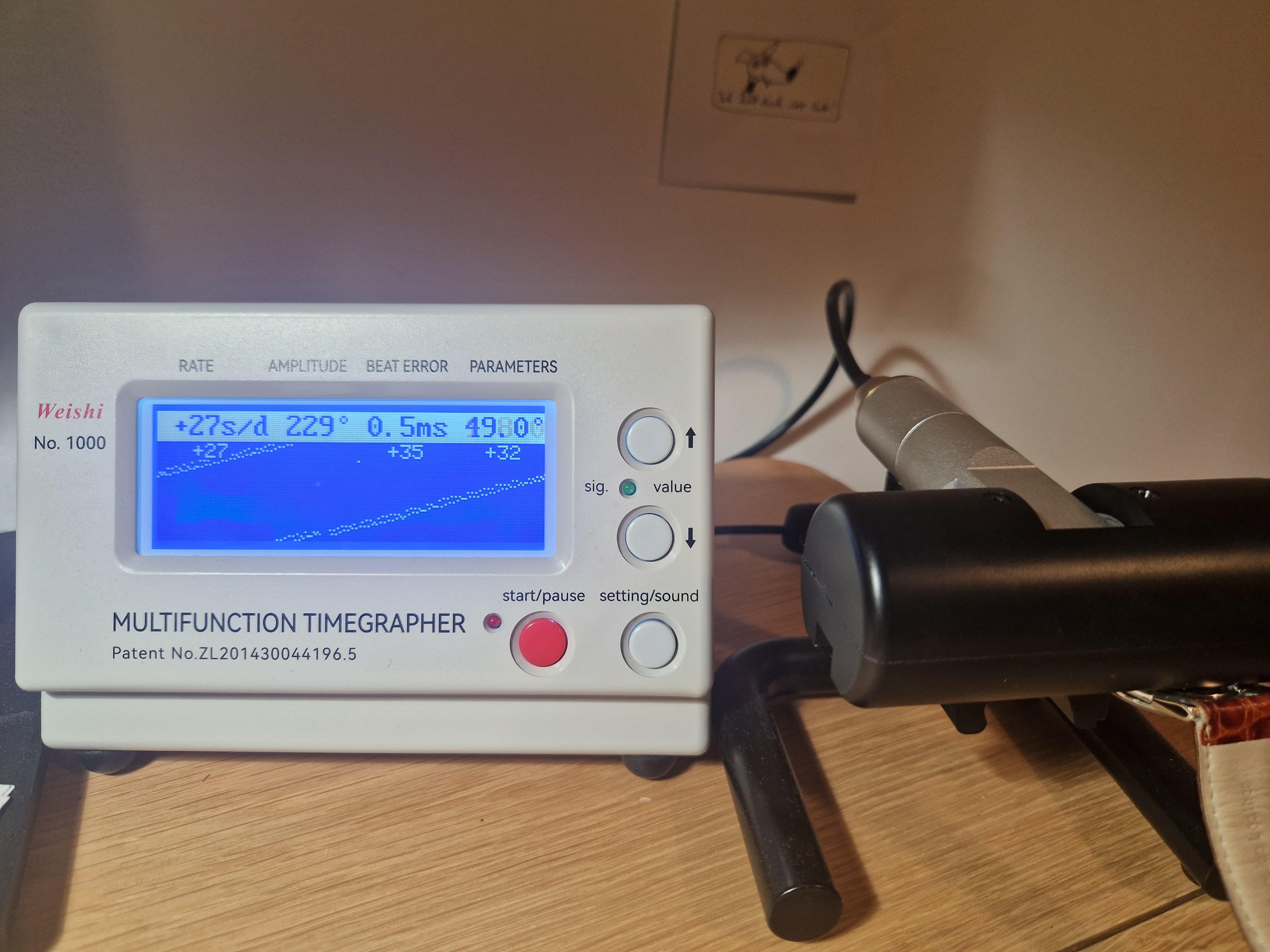

here is why was asking is that the sensor for the timing machine is located on that side. The sensor is not picking up audio is picking up vibrations that happened the be in the audio frequency. This means you have to have a really good coupling between the watch and the microphone at anything that interferes with that possibly masking tape could cause a distortion of the waveform. So that's why it's pointing that out it could be a minor issue maybe it's not but it could be.
then what's interesting is all of the images with the automatic attached look like escapement issues of some kind or issues of something on the balance wheel rubbing hitting hairspring rubbing and/or touching is a timing machine is picking up the waveforms and not quite where there supposed to be definitely does not look right at all not like a loss of amplitude by something weird happening with the automatic assembly which is the weird part
Oh wow, I didn't realise. Rookie mistake, I guess. I took it off and it was clearly interfering with the signal. Traces are much cleaner across the board.
Here again the ones WITH automatic bridge.
Crown down:
Dial up:
Dial down:
While the traces are rather ok, the amplitudes WITH automatic mechanism are down around 50 degrees vis-à-vis WITHOUT the automatic mechanism. And variation of rates across positions are much larger.

I not sure if it's going to make any difference at all but how but if you put the watch in beat in a dial down position. When you go to the crown position still always change a little bit which is why typically just want to do dial down.
Then interpreting timing machine results to certain degree is subject to interpretation. For instance I'm attaching a guide of interpreting graphical displays even though is for a paper tape machine it still applies to what we see here. Notice figure 10 kinda looks like what you're seeing. Now the problem is at least for troubleshooting purposes the watches cased up with the hands and dial on. Now there are as I said complications to interpretations because when you put the watch in the dial up or down the image at least way up above was looking better and you didn't include either up or down when we were looking at the pendant positions. At least in the recent images I didn't see one so that's where you see it looks better but I believe the amplitude is better?
Timing-Machine-Charts.PDF

I think I found the problem.
The automatic bridge itself is ever so slightly touching the balance.... to be precise the lower bridge. The upper bridge is fine and doesn't touch the seconds spring (which is brand new and ever so slightly lubricated on the contact point).
If I install the bridge without all the wheels (upper and lower bridge combined; even without the rotor axle) , the amplitude still drops. See picture (where you see the exposed seconds spring).
But if I install the upper bridge without the lower bridge, everything is fine.
I'm not sure why, though. Maybe the piece itself is a bit bent (even though it looks fine). I ordered a replacement and hope that this will solve it. The tolerances must be ridiculously tiny (between the bridge and balance).
I'll report back...
Folks, I can now confirm that the issue was the lower automatic bridge (part 1033). It must have been ever so slightly bent.
I got a replacement and installed it this evening. No change in amplitude between with or without automatic bridge. What a relief!
Thanks to you all, especially @Nucejoe@Nucejoe and @JohnR725, for pushing me towards further assessments of potential contact points between base movement and automatic bridge (and less into the reversing wheel).
Final update on this piece!
I'm done. Finally.
While the replacement of the lower auto bridge solved the issue of the reduced amplitude, there were some other things that I fixed.
1. I replaced the reversing wheel with a NOS part (cleaned as per usual process with L&R cleaner and rinse in U/S; then lubricated with Lubeta V105 without disassembly)
2. The rotor was a bit loose. Didn't yet touch the rest of the movement, but certainly would have go there soon. So I ordered a new axle with already fitting rotor pinion. Note: if you buy a new pinion, it needs to be reamed to fit the axle (to 0.701 or 0.702mm).
Here's the process:
a. I pushed out the old pinion from the rotor with my Seitz press. I used a pump pusher to keep it centered; if I recall correctly it was the .105 size (but not sure).
b. I pushed in the new pinion with a small flat anvil. I though I was done...
20230927_164727.thumb.jpg.8df05a48947723669456d7eaa8f14bf9.jpg20230927_164959.thumb.jpg.0f040ff08ee777cf9a7520cebd394118.jpg20230927_164950.thumb.jpg.b2b833c6cd9b92e0b471565b89a6329c.jpg
c. ...but after installing the new axle, I was shocked that A. the rotor was way too tight (it wouldn't move by gravity alone) and B. , even worse, it was not straight - the rotor was touching the movement on one side and quite high on the other side. Oh dear!!! I decided to tackle issue B. first and put it in my staking set between two flat stakes and hammered it very gently. Back and forth between movement and staking set (with slightly increasing force). No change. It stayed uneven. SHIT!
d. Before taking any more drastic measures, I decided to try out the old axle (after all, it is steel and should not wear much). And what relief!!! It was straight! But still very tight.
e. So I took a smoothing broach (not cutting!) and moved it around VERY gently. Remember, the tolerance is in the 0.001mm = microns. And yes, fortunately, that did the trick already! I was relieved that I didn't start with a cutting broach... that would certainly have done too much.
[sorry, no picture here, but you can imagine]
I'm wearing the watch today to see if it winds well over the course of a normal day. The rotor is still on the tighter side, so will see if it winds efficiently enough.
Hopefully, by this weekend (after testing power reserve) I can declare this job done-and-done!
If you had opened the rotor hole a bit too large do you feel like you could have made it tight again? Seitz tool has bits where they claim you can do close up a jewel hole...
Thank you for posting this guide John- there is similar in one of the classic books but this guide has more comprehensive examples and solutions...
I don' think so. You could probably tighten it a little bit on one side (with the Seitz tool) -- maybe even both sides (the other side with a staking set). BUT the pinion is a long shaft/tube that should be equally tight everywhere. I should make contact with the rotor axle along its whole length. So if top and bottom are tight to hold the axle, it may seem fine at first. But it will wear quickly on those two ends. And then you have a loose rotor rather soon.

The problem is this isn't a hole this is a tube. So if you try to close it by squeezing it it ends up a distorted shape. I suppose if you're lucky and you can close the entire tube and then open it back up to the correct size may be.
