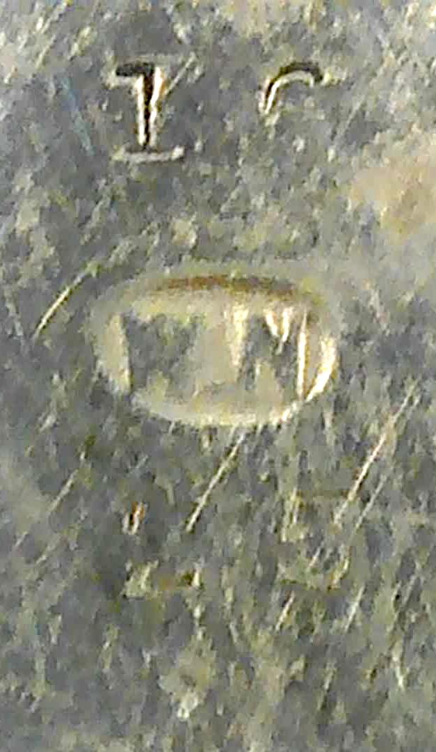

Thanks Richard. There appears to be a date mark but it's difficult to read even under a microscope. I thought it was 1925 but could it be 1825?
Mike
