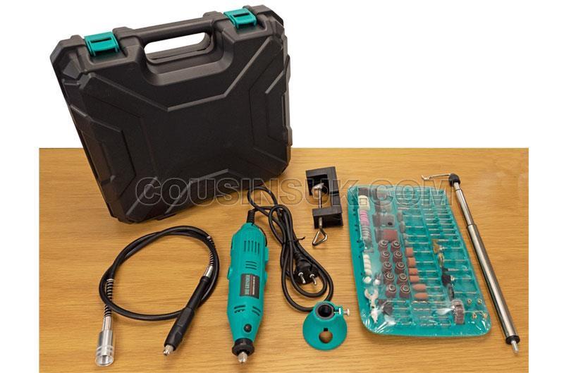

A good tool makes you enjoy the work you do with it, while a bad tool has the opposite effect!
Unfortunately, this rotary toolkit from CousinsUK is of the latter type. Admittedly, it does its job decently well but is not very efficient as the polishing head vibrates strongly which means that only part of, rather than the entire felt tip comes into contact with the surface being polished. Maybe worth the money (£35 + tax) but if you want to have fun at work, you'll probably have to look for a more expensive alternative.
It would be foolish to try to polish your finest watch the first thing you do when learning, so I appointed this nut to be my guinea pig.
I found this video that shows how I went about it.

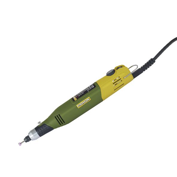

The first option comes from Proxxon (a German manufacturer if I'm not misinformed) and is called 230/E Micromot.
It can be bought separately without accessories and without a toolbox, but I need a box for storage because I don't have a workshop.
In addition, I was thinking of ordering a Proxxon 110/BF flex shaft for it because I think it is more comfortable and precise, especially when sitting for long periods of time.
