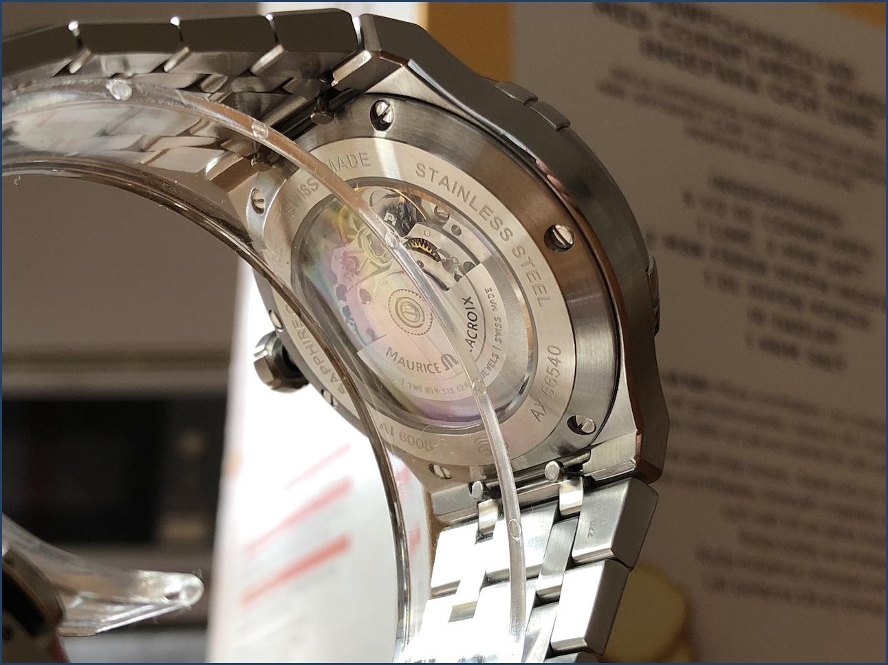

After almost a year and a half, I have finally reached the finish line with my project—to acquire an Audemars Piguet Royal Oak in stainless steel with a blue dial. Well, not quite, but I think I get a bit of that feeling now that I'm wearing my serviced and polished Maurice Lacroix Aikon.
I must say that the case is very well-crafted and feels solid, heavy, and luxurious. In fact, I would be surprised if I experienced any significant difference between the original and this homage. When it comes to the inside—that is, the movement (calibre ML115 based on the Sellita SW 200-1)—we obviously can't compare it to an AP, but then again, the price difference is around £40,000.
That being said, I must say that I'm impressed by how beautifully decorated the movement is and how well it keeps time. In the long run, I plan to write a small review of the movement and compare it with ETA's calibre 2824-2.
I'm far from a professional when it comes to polishing, but I've made some progress, and I'm happy about that. My goal wasn’t to achieve perfection but rather to get rid of dull, scratched, and worn surfaces, which I think is important for this type of dress watch.
If it had been a field watch, I wouldn’t have cared. In that case, the only thing that matters is that it’s properly clean, and I actually think a few scratches and dents just add to the watch’s character. It’s a bit like comparing a limousine to an off-road vehicle or jeans and a T-shirt to a suit. A dirty and worn-out limousine or suit doesn’t exactly feel fresh.

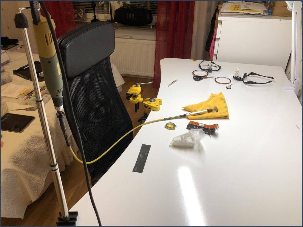

The reason this project took so long is that several other interesting projects came up in between. However, I’m still very happy with my Proxxon 230/E Micromot rotary tool, and I use it for all sorts of purposes.
The vice in the picture allows me to either secure the rotary tool itself or the watch case, depending on what feels most convenient. On top of that, the fact that the tool is quiet and vibration-free makes it an absolute joy to work with.

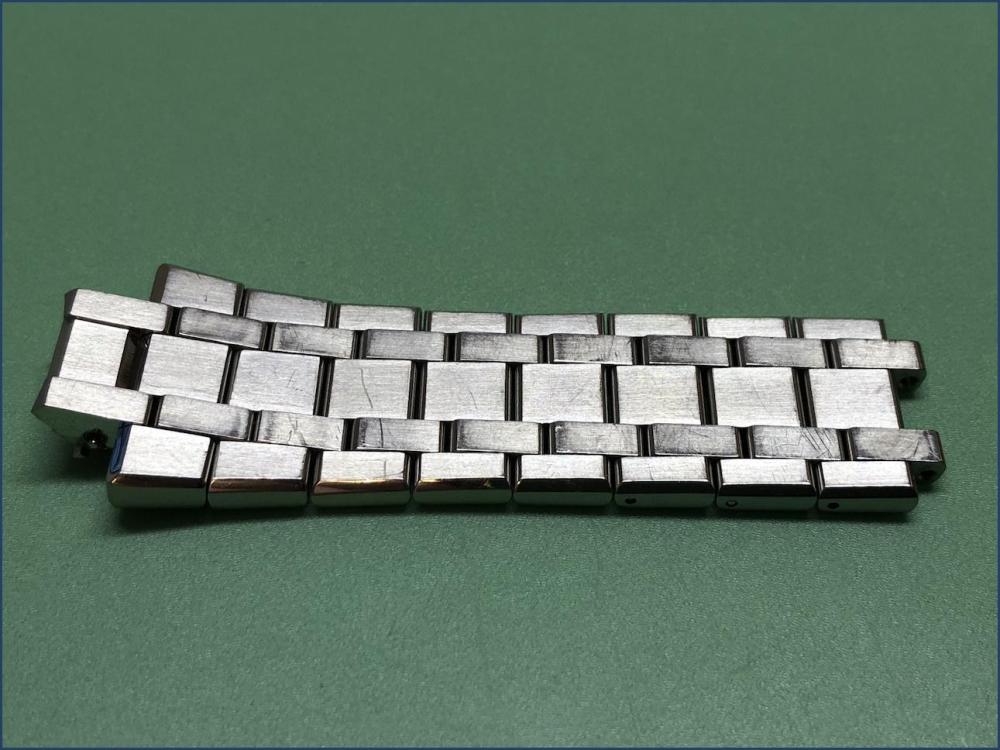

When it comes to the bracelet, however, I used a proper but simple polishing machine since the surfaces are far too large for it to be practical to polish with a rotary tool.
Unfortunately, I do not have the equipment or the expertise to restore the original finish, which was probably done with very fine sandpaper. Instead, I polished the bracelet to a high shine and then brushed it. At least it resembles the original well enough not to draw any negative attention. Unfortunately, I accidentally rounded off a few sharp edges. I knew the risk was there, but I lost focus for a moment. I take it as a lesson learned.
